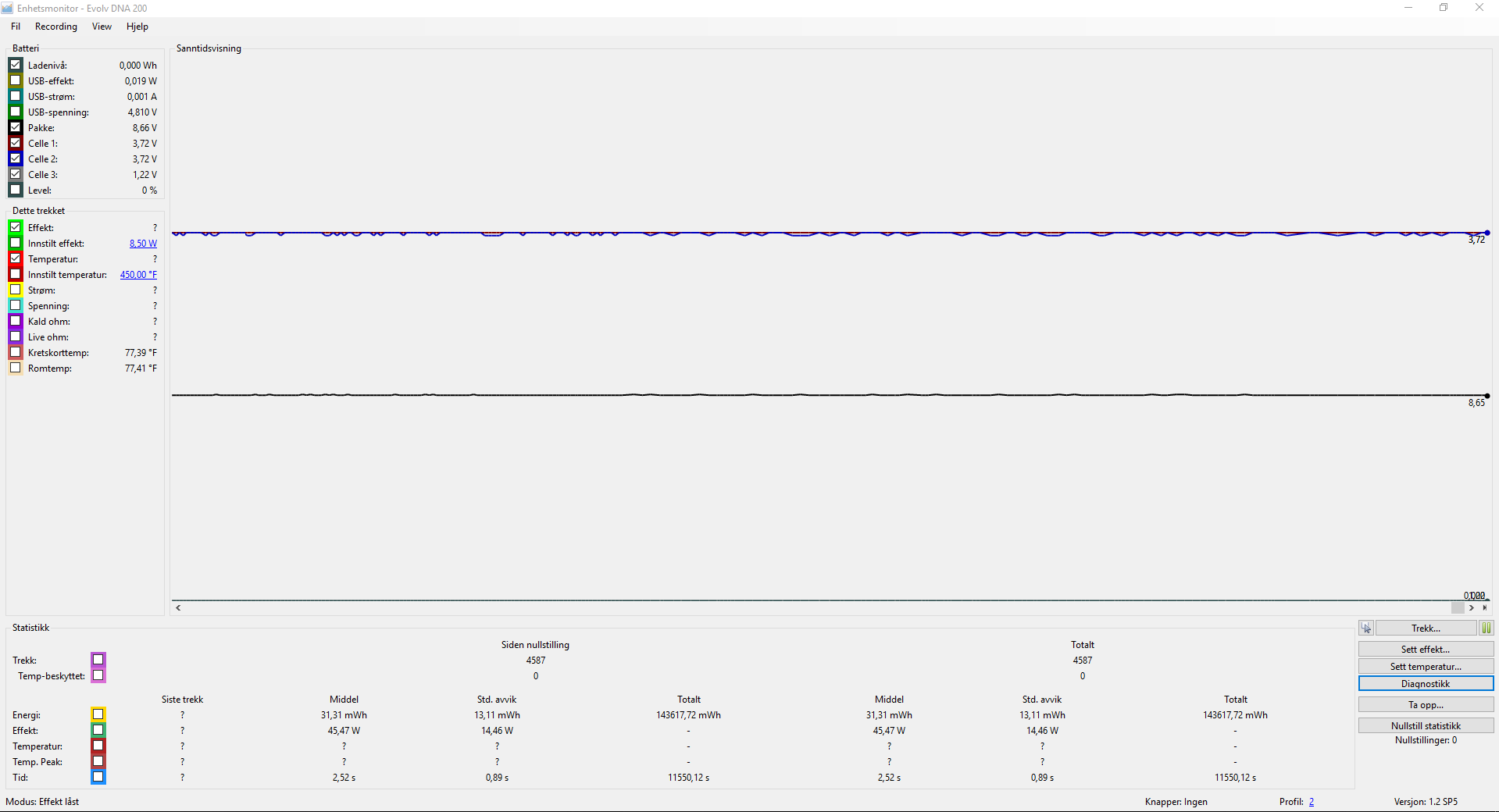

Martyric Posted March 3, 2018 Report Posted March 3, 2018 Hello, i just got a used Lost Vape Halcyon and i cant get i to charge. I have tried the Usb recovery thing a couple of times, but nothing seems to work . And i cant seem to find a replacment battery in Europe without having to change the xt contact .
