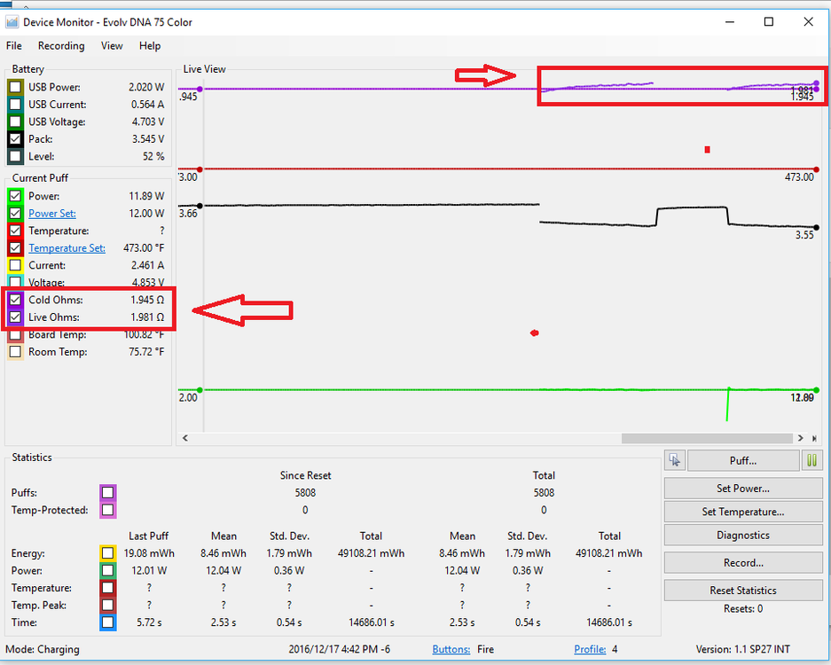

retird Posted December 17, 2017 Report Posted December 17, 2017 The resistance of any coil will change when heated or cooled. It is not static. You can see this using Device Monitor by checking the box for cold ohms and the one for live ohms. As you vape you will see the live ohms change due to the coil (wire). being heated. Here is a screenshot showing this.... it shows cold ohms and the live ohms (while vaping) and you can see the resistance change.

tami Posted December 17, 2017 Author Report Posted December 17, 2017 2 minutes ago, retird said: The resistance of any coil will change when heated or cooled. It is not static. You can see this using Device Monitor by checking the box for cold ohms and the one for live ohms. As you vape you will see the live ohms change due to the coil (wire). being heated. Here is a screenshot showing this.... it shows cold ohms and the live ohms (while vaping) and you can see the resistance change. Yes I'm kinda confused for this is my first time using DNA250 chip. In my voopoo drag when I vape it does not change resistance unlike my paranormal 166. Btw thanks
