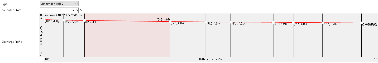

Smokin Dave Posted December 4, 2017 Report Posted December 4, 2017 Right now I'm using LG PVA18650FD1 2000 mAh batteries from Pegasus and when I go to re-charge the batteries one battery will be only 70% drained while the other will be completely drained. I am guessing I need a different csv file to correct this issue.I have run the analyzer to little success.My dumbass doesn't know how to save the results from the analyzer to do a csv file so a little help on that end would be most beneficial and appreciated. Thank you in advance.
giz_60 Posted December 4, 2017 Report Posted December 4, 2017 After running the analyzer, click 'Accept'...then 'Upload Settings To Device '...but sounds like you either have a bad cell or a bad battery connection... 1

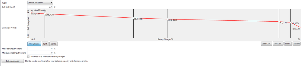

Smokin Dave Posted December 5, 2017 Author Report Posted December 5, 2017 (edited) After three tries on the batt. analyzer,escribe kept crashing when I would hit accept, the fourth try worked and this is the result.Laughable I know.I loaded it just the same and the Paranormal battery indicator went to zero battery life in about ten minutes.There was plenty of life left of course in the batts so what I need to know from those with a lot more expertise is how should this curve be set to show up on the batt gauge on the Paranormal accurately. Edited December 5, 2017 by Smokin Dave

dwcraig1 Posted December 7, 2017 Report Posted December 7, 2017 That sure looks a lot different than mine. Here's the CSV for mine dna 75 battery.csv
Smokin Dave Posted December 7, 2017 Author Report Posted December 7, 2017 Much thanks, kind sir.I don't know why Escribe kept crashing while trying to apply the analyzer results on my end.I loaded your csv and it appears to be an accurate reading of battery life now. 1
