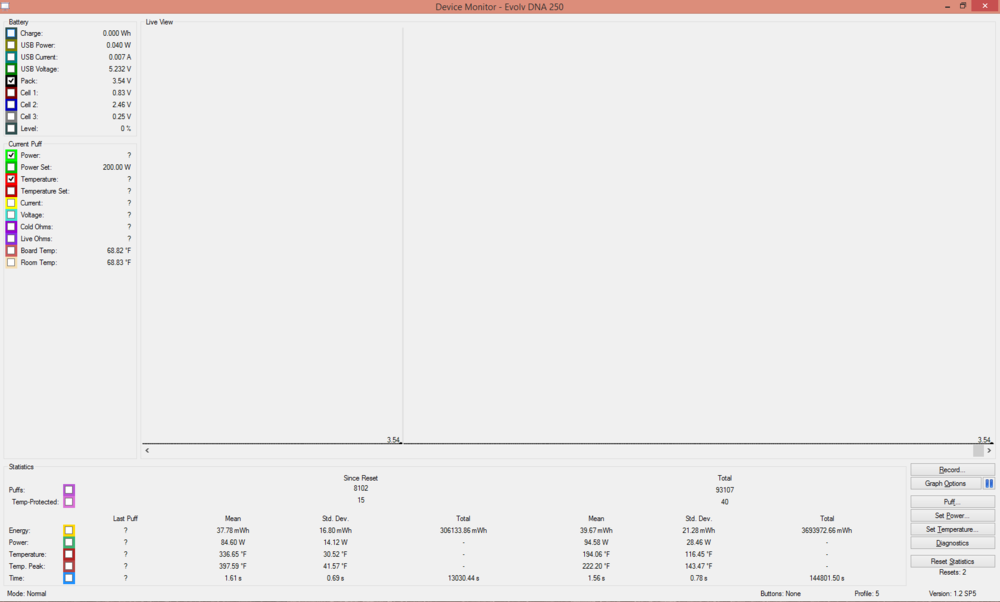

Wayneo Posted November 27, 2017 Report Posted November 27, 2017 Will it connect to escribe? If 'yes', can you post a 'printscreen' of 'Device Monitor' And welcome

mech Posted November 27, 2017 Author Report Posted November 27, 2017 Connected the chip to psu and it does work.

Wayneo Posted November 27, 2017 Report Posted November 27, 2017 With those varying voltages shown for each cell, could there be eliquid in there? I'd really check/clean all contacts, then open the ticket like @retird suggested.

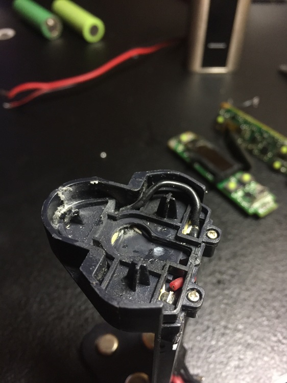

mech Posted November 27, 2017 Author Report Posted November 27, 2017 I think I found the problem and Im very pissed. Same problem as wismec rx2/3.
Wayneo Posted November 27, 2017 Report Posted November 27, 2017 At least it's only a simple solder job, which is much less time consuming to repair, compared to sending it to the US for service. Looks like the old battery tab connector wire. Glad you found it.
