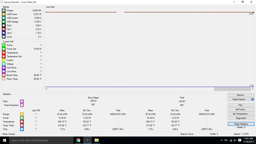

SpecTrum Posted November 27, 2017 Report Share Posted November 27, 2017 pls help me, my therion 166 always says check atomizer and check battery. when go to escribe and device monitor, may device reads imbalance battery. may batteries are fully charge. Link to comment Share on other sites More sharing options...

giz_60 Posted November 27, 2017 Report Share Posted November 27, 2017 A common problem with the Therions is having a bad solder joint connection on the bottom side of the battery sled.... Link to comment Share on other sites More sharing options...

SpecTrum Posted November 28, 2017 Author Report Share Posted November 28, 2017 On 11/27/2017 at 9:31 AM, giz_60 said: A common problem with the Therions is having a bad solder joint connection on the bottom side of the battery sled.... oh tnx, how to fix it, i already re solder it man. and when when i use multi tester, its has good connection. but didnt fix the problem Link to comment Share on other sites More sharing options...
