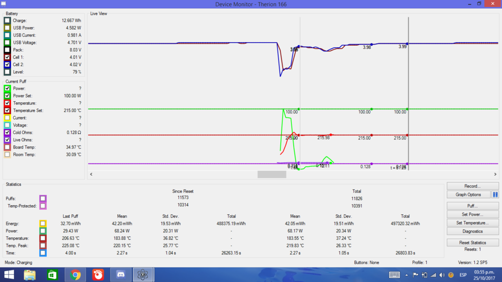

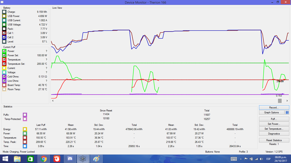

ikicho Posted October 24, 2017 Report Posted October 24, 2017 Hi, Im having a problem with the combo of therion 166 and kylin rta. Always the first pulse is constant but the one that follows i feel like the output of power is delivered as pulses. Any idea?
Wayneo Posted October 25, 2017 Report Posted October 25, 2017 (edited) Hey man, can I see that again, but this time after your first, just set the mod down, See puffs over on the right, choose 4 seconds and let your mod do it. Stop the scrolling, move the mouse over the lowest area (deepest valley before another rise) and a printscreen of that. Can you describe your coil? I have only experienced that in 3 scenarios. Inconsistent inhale, or an overpowered set of parameters for a low mass single wire build or uneven coils Edited October 25, 2017 by Wayneo 1
ikicho Posted October 25, 2017 Author Report Posted October 25, 2017 (edited) Hi wayneo. Its a dual 3.5 ID 6 wraps dual coil of stagger fused (26ga+32ga)*2+32ga made from a spool of geekvape. On atomizer analyzer it show 0.135 ohms steady with no variations and in device monitor the cold resistance its 0.128 im using a profile made from wire wizard with all the characteristics as said In the graph the numbers are overlaped but the lowest point of power i think its 1.65W By the way i have a ijoy rdta 5 made with the same wire, but not same id and wraps and the puff its steady I´ve tryed the djaqith v3.5 profile with the same results, first puff is steady the following ones are pulse Sry for potato english not my native lenguage thx for the help Edited October 25, 2017 by ikicho more information
Wayneo Posted October 25, 2017 Report Posted October 25, 2017 Good English. I really think this is a build issue, as your other atty/build works fine. Can you check there are no hotspots, if a contact coil, try a spaced one.
