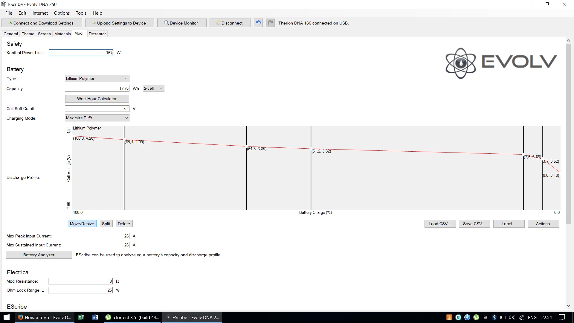

Max_P Posted October 23, 2017 Report Share Posted October 23, 2017 Hi, Please, advise if I set the battery settings which is fit to 2 18650 LG HG2 (choco) on my Therion 166 device. I'm not pretty sure regarding Capacity and Max Peak/Sustained Input I Link to comment Share on other sites More sharing options...
giz_60 Posted October 23, 2017 Report Share Posted October 23, 2017 I would change the 'Cell Soft Cutoff' to 2.75.... 1 Link to comment Share on other sites More sharing options...
Max_P Posted October 24, 2017 Author Report Share Posted October 24, 2017 22 часа назад, giz_60 сказал: I would change the 'Cell Soft Cutoff' to 2.75.... Changed to 2,7 and discharge is still to 3,5V What settings should I insert so the discharge will be to 3,2? Link to comment Share on other sites More sharing options...
Wayneo Posted October 24, 2017 Report Share Posted October 24, 2017 23 hours ago, Max_P said: I'm not pretty sure regarding Capacity and Max Peak/Sustained Input 'Capacity' only relates to battery icon. 'Max Peak/Sustained Input' is already maxxed out IIRC. 39 minutes ago, Max_P said: What settings should I insert so the discharge will be to 3,2? What are you seeing at 3.5V? Run Device Monitor with cell1 and 2 ticked and see if there's alot of sag on the cells, or 'a' cell. Post printscreen here. 1 Link to comment Share on other sites More sharing options...
