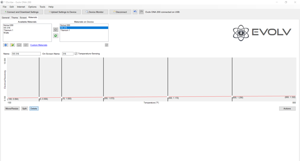

Go to the 'material' tab to see what wire types are available, and on your mod.

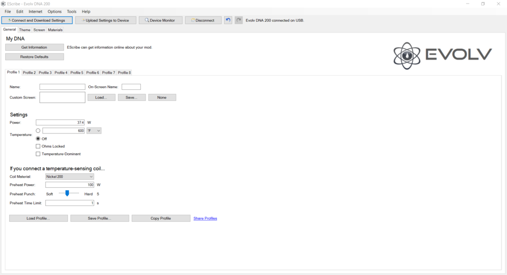

If you don't connect a wire capable of TC, it will fire at the wattage selected.
If you do connect a wire capable of TC, it will fire using the material profile selected, in the screenshot 'ni200'.
So you're vaping kanthal @ 37.4watts.

On your 'material' tab, left side, see the one called 'watts', click to highlight, then that right arrow -> in between the two windows to put it back on your mod.
You should still have SS316 in the right window. If not, do the same thing as before for 'watts'

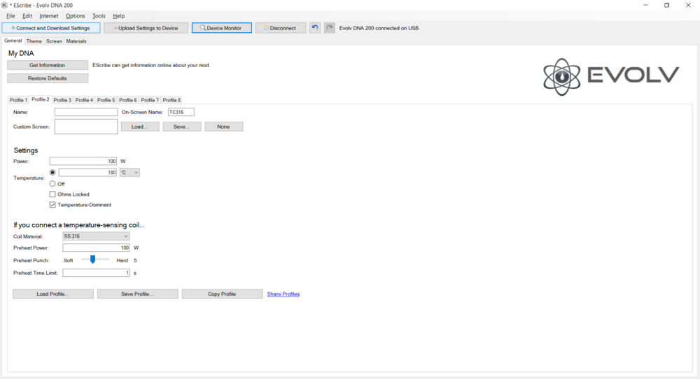

Check your watts material in the right hand window. Make sure 'temperature sensing' is not selected below it, just above the graph.
Set a profile, I usually set Profile 1 back to your watts material
Go to Profile 2.
Put Power at 100 watts, temp of your choice (150C) is fine.
Click on temperature dominant.
Do not lock resistance.
Leave the other defaults for now alone.
Near top of screen -> Upload settings to device (always gotta do this)
Atty should be at room temperature, wicked and ready to go.
Device Monitor.
Bottom left side should say Normal or charging. Over to the right it should say Profile. Click on that, change it to Profile 2
Put mod down on table.
Device Monitor, far right, see Puffs, click and set to 3 seconds. Your mod will fire, and no lava for you. Post printscreen like the second one you did before.

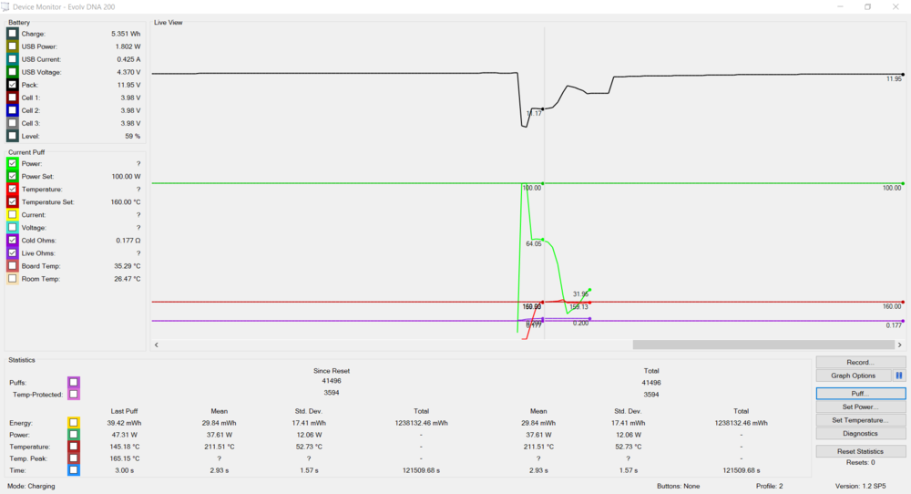

8 minutes ago, InvisibleRasta said:
still fires quite lavaish...sometimes at 150C it will fire lava... some other times it will fire godod...
Rasta, overall that looks good. Couple comments. The only ways I can see you getting lava is if it's firing 100 watts straight (non TC) OR the wrong wire profile. If you don't plan on using Nickel or Titanium in the near future, go into profiles and change them to SS. Then go to Material tab, right window, select, then remove from mod.
Preheat should be greater than the Power number. Yours show both at 100w.
100watts, is clearly too much to maintain the watts required, so you can drop the Power to 50w, leaving preheat at 100 if you wish (if you liked that ramp up) You can tweak any of those 5 values to your desire. Note that even though we said 100w, your temp was ~150c.
Always remember to upload settings to Device after you make changes in escribe
Under File -> Save As you can save a backup of all your settings.
