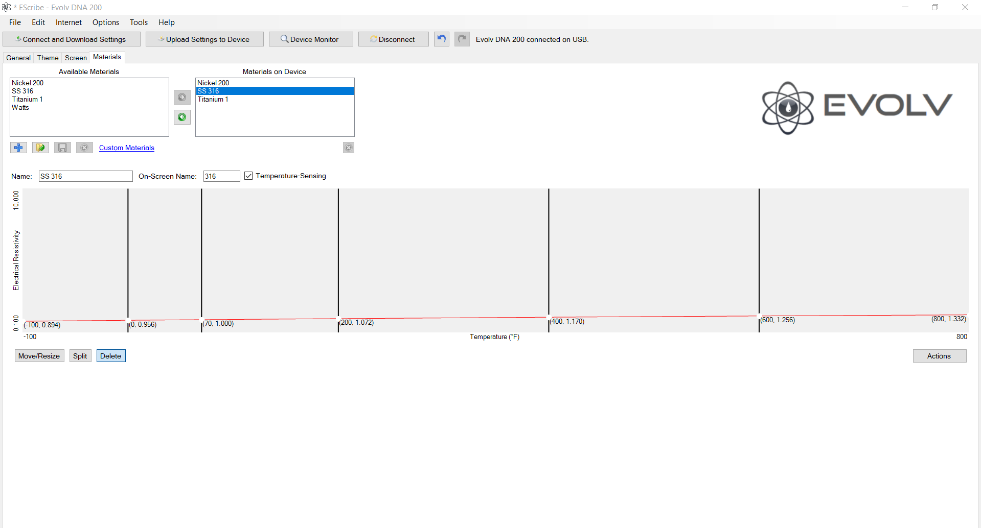

  1. Hello guys, I have a Lost Vape Thelema Solo DNA100C that is just falling into pieces. The DNA 100C board tho is in perfect working conditions. Is there anywhere I can buy a kit with an enclosure so I can keep using the board? I did some searches but all that I have found requires 3D printing or driling and such. Thankyou

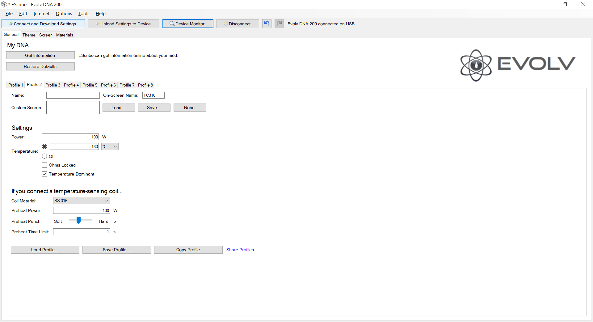

  4. seems like its working now... only thing is how do i switch profiles from watts to 316 profile? really this chip with each update has become more and more hard to use.. i do not understand anything of it anymore... it used to be easy to select watt profile or 316 profile... now i had watts enabled for my rdta.. i want to switch to TC... i select preset 316 and boom... firing at full power... cotton burnt in a second

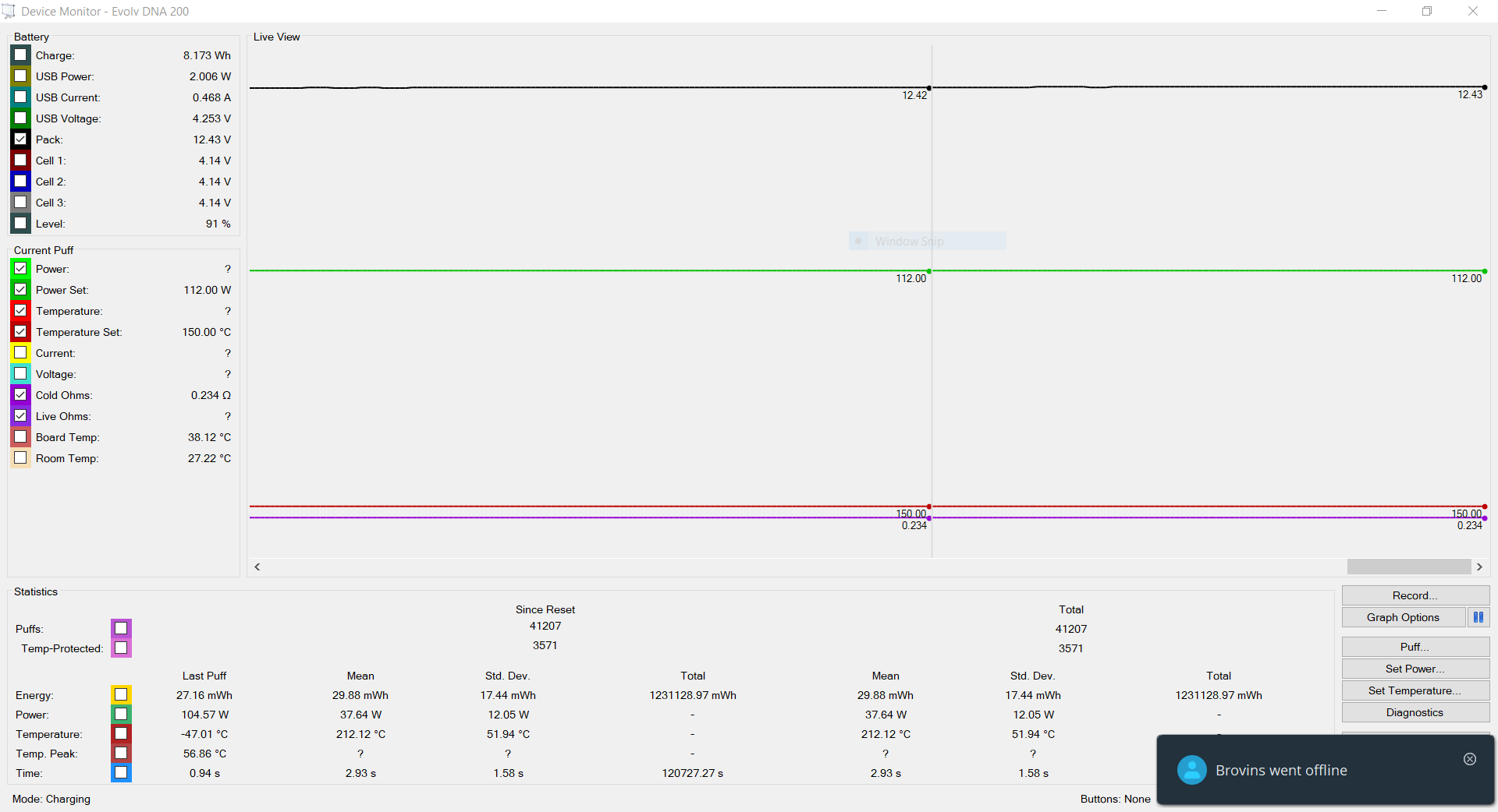

  10. i do not fully understand your instructions. I opened device monitor,fired and took a screenshot i tried to set at 150C but when i fire it shows it goes up to like 1300C.... thats like about to blow up the wire Is there
  11. i restored defaults and i am on the latest firmware... my build is spaced 24 gauge SS316L with 7 wraps on a 3mm drill bit. I selected the SS316 profile as described on my red comment and put the temperature to 130 Celsius but it fires vapour like lava... like if it was on power mode at 200 Watts... Teh Watts output with TC enabled is at max power that i set at.. Watts dont change according to temps... liek i set watts to 50W and it will fire 50W all time TC not working
