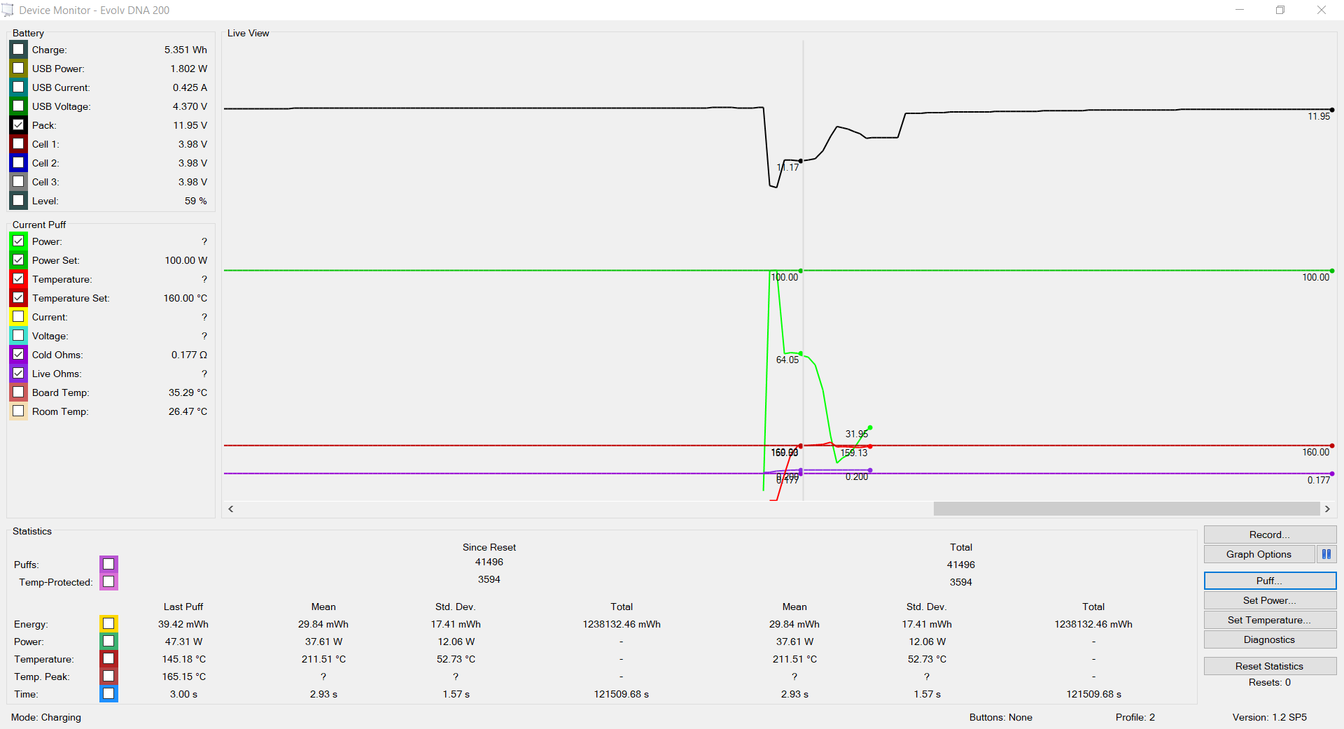

  5. this are the results.... still fires quite lavaish...sometimes at 150C it will fire lava... some other times it will fire godod... with same options profile and whats so ever...without touching anything...super unstable
  6. i did not do anything.. everything is as after i did a firmware update, without profiles. but after i did the restore defaults i didnt have a watts option available.. so now i wanted to vape with my rda since my RTA with SS316 is firing lava. I now have the watts option back, thank you for the information. Back to the ss316 problem, what can i do?

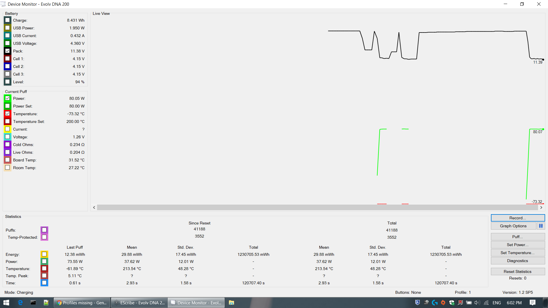

  9. one time it fires like lava... without changing anything other time it fires and says temperature protected but no vapour comes out

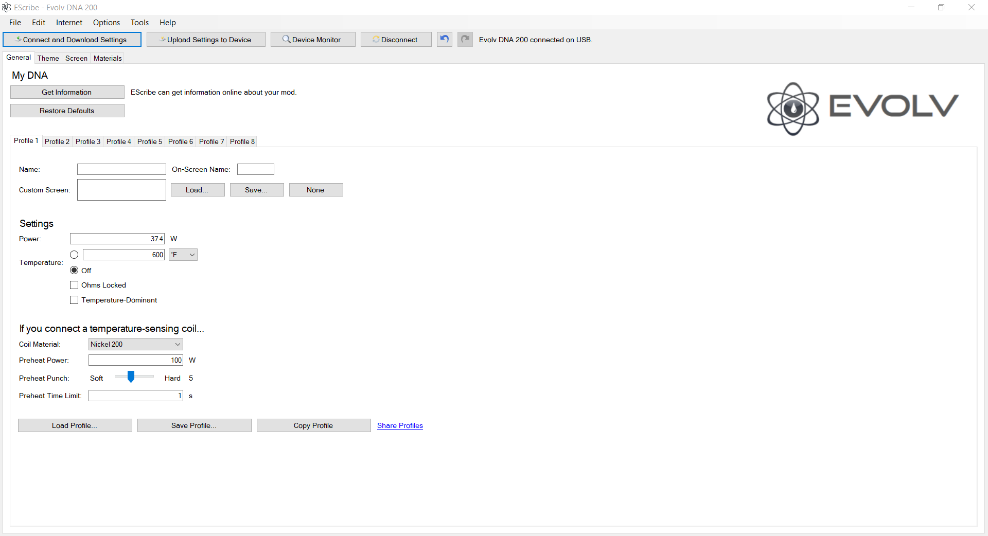

  10. i do not fully understand your instructions. I opened device monitor,fired and took a screenshot i tried to set at 150C but when i fire it shows it goes up to like 1300C.... thats like about to blow up the wire Is there
  11. i restored defaults and i am on the latest firmware... my build is spaced 24 gauge SS316L with 7 wraps on a 3mm drill bit. I selected the SS316 profile as described on my red comment and put the temperature to 130 Celsius but it fires vapour like lava... like if it was on power mode at 200 Watts... Teh Watts output with TC enabled is at max power that i set at.. Watts dont change according to temps... liek i set watts to 50W and it will fire 50W all time TC not working
