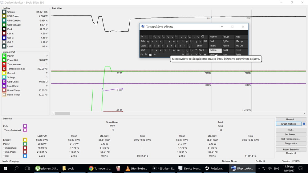

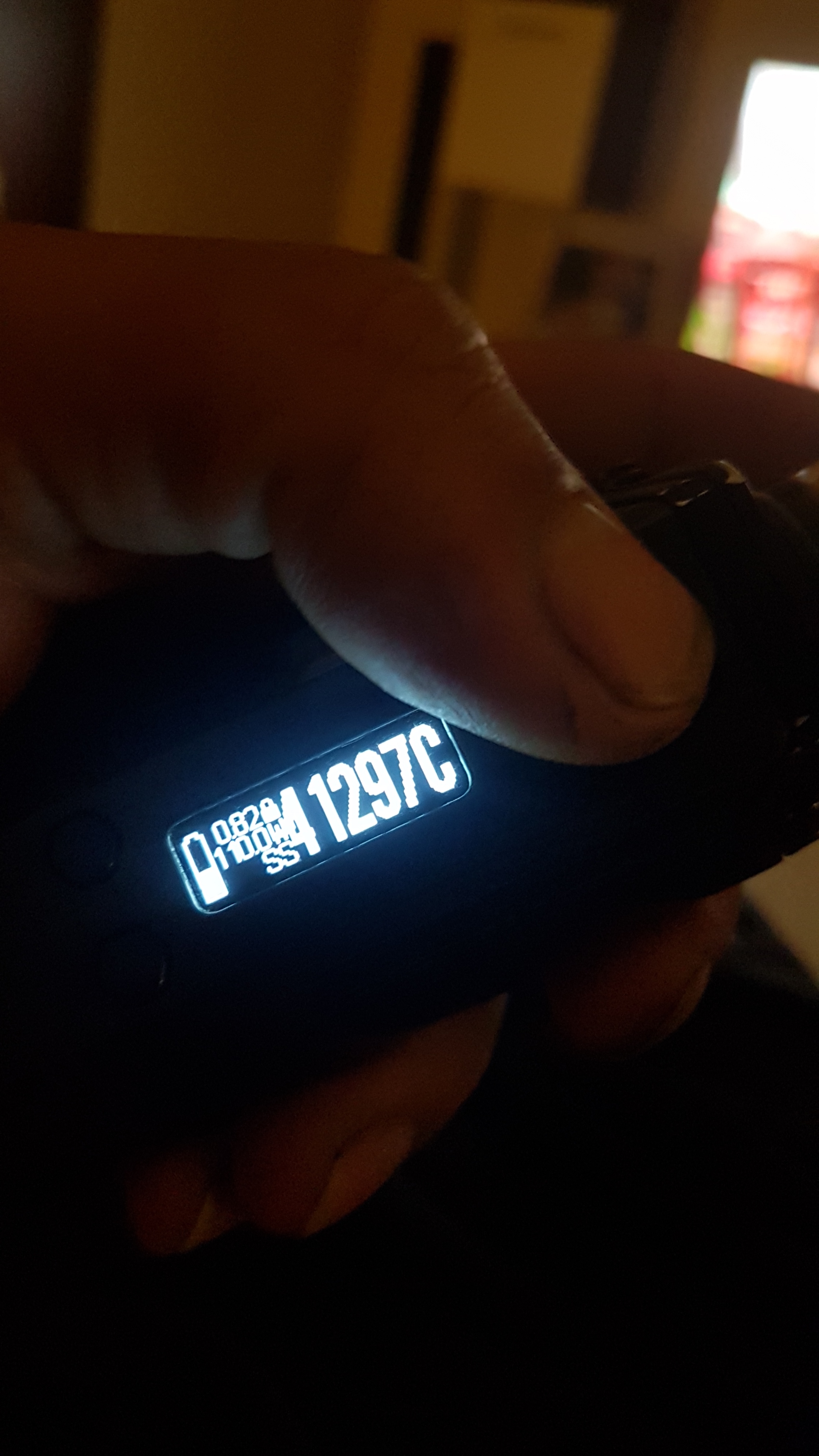

S.laga Posted September 14, 2017 Report Posted September 14, 2017 Hello guys! Does anyone have this problem with their mod? Tc mode the temp goes whatever !
S.laga Posted September 14, 2017 Author Report Posted September 14, 2017 Oh sorry this is while firing!

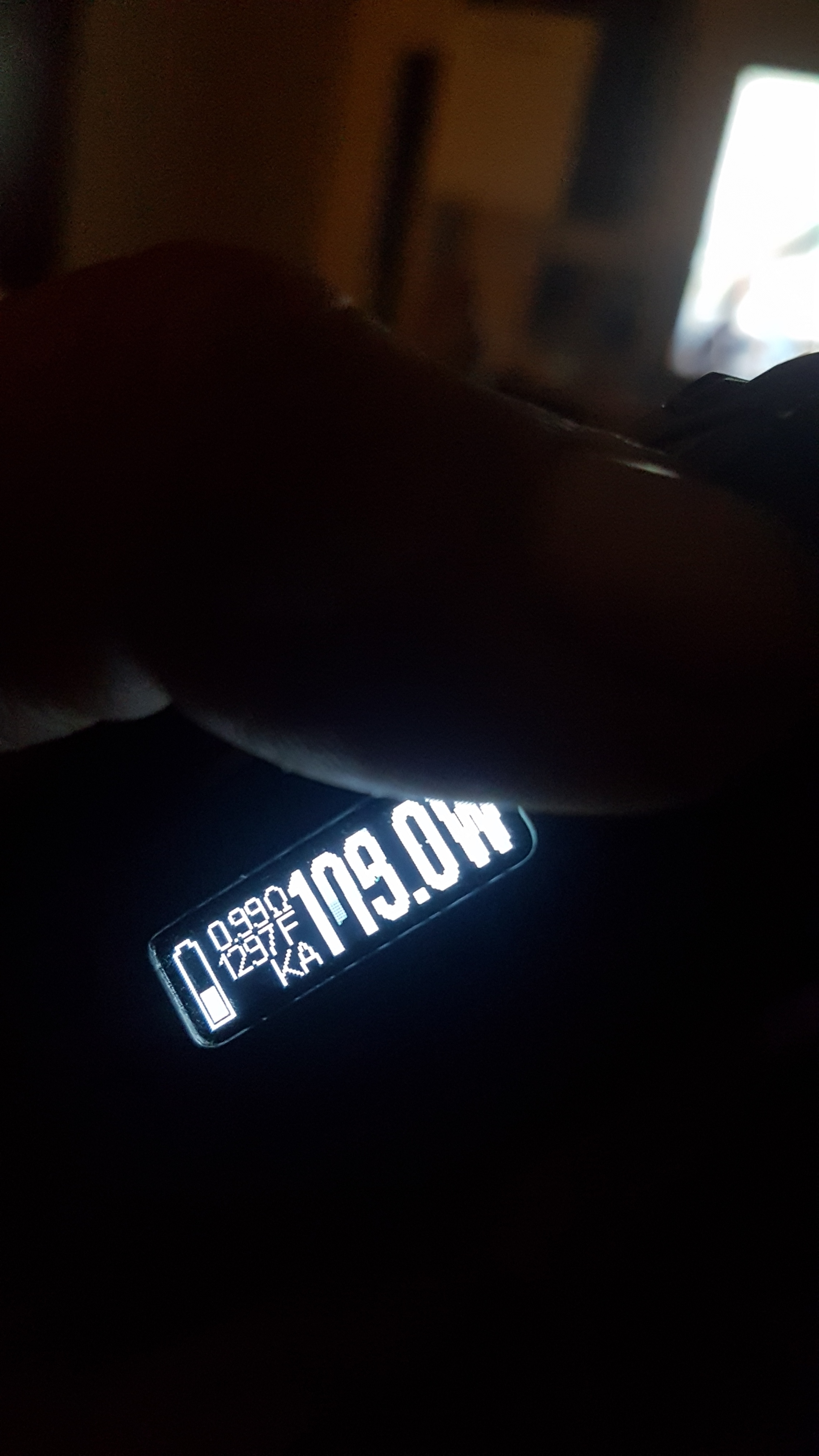

S.laga Posted September 14, 2017 Author Report Posted September 14, 2017 The sane thing happens in kanthal preheat I have! Is it something I can fix in escribe?

Lowbytes Posted September 14, 2017 Report Posted September 14, 2017 Try to use escribe - device monitor and look at the numbers - i´m sure that everything is fine except the Display is showing wrong

Wayneo Posted September 14, 2017 Report Posted September 14, 2017 Hmmmm, have you leaked or spilled juice? I'd try removing your atty and cleaning the 510 threading on the mod and the atty. Questions: Why does pic 1 (SS) show you locking the ohms AND pic 2 (kanthal) show it NOT locked. Ideally, that's backwards for each. Kanthal preheat is a non standard cheat. With its own dedicated thread. So I won't make any more comments on that one 1

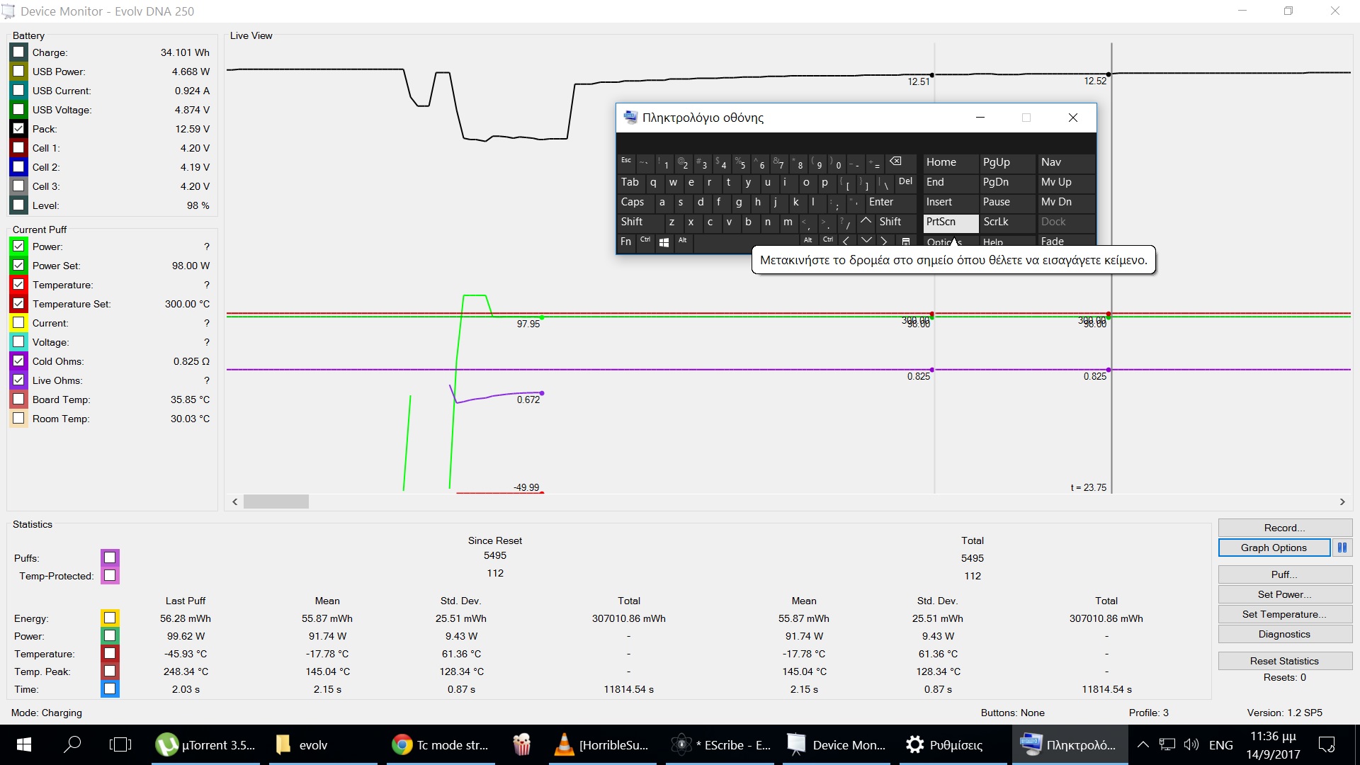

giz_60 Posted September 14, 2017 Report Posted September 14, 2017 Usually, seeing crazy numbers like that is an indication that the device is dropping out of TC mode. Looking at the screen shot of Device Monitor, your coil resistance is dropping while firing. That resistance fluctuation is usually do to a bad connection with the coil....either as @Wayneo stated, some cleaning is in order, or you have loose connections on the build deck.... 1
Wayneo Posted September 14, 2017 Report Posted September 14, 2017 1 hour ago, giz_60 said: your coil resistance is dropping while firing @giz_60 Yeah, that's probably cuz he's locked the ohms while hot/warm, the coil has not quite cooled, so it drops to it's resting ohms, then starts rising (or I could just be having some crazy delusional thoughts)
