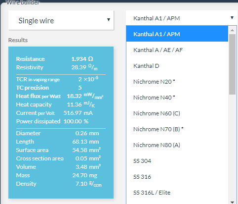

FnZ Posted September 5, 2017 Author Report Share Posted September 5, 2017 (edited) Hi @awsum140 , thanks for reply. I agree but the dubt start using steam-engine and reading instruction on "wire wizard page" : TCR If you want to download the TCR profile as a CSV file to your DNA 200, click the DNA200 tab. This function is only available if all your selected materials have an associated TFR/TCR profile. Materials that lack a TFR/TCR profile are marked with an asterisk in the dropdown menu. Looking on the wire drop down menù I saw that kanthal and ni80 have a tcr profile.... So, it make no sense starting from consolidated point KA1 and Ni80 cannot be used in TC mode....It makes me a little be confused Edited September 5, 2017 by FnZ Link to comment Share on other sites More sharing options...
giz_60 Posted September 5, 2017 Report Share Posted September 5, 2017 Most any wire you apply an electrical current to is going to warm up, therefore most DO have a TCR value applied to them. However, doesn't mean that they will work in TC mode. Because the TCR value of Kanthal & Ni80 is so low, they will not work in TC mode. 1 Link to comment Share on other sites More sharing options...
Wayneo Posted September 5, 2017 Report Share Posted September 5, 2017 @FnZ According to Evolv, their chips need a material with minimum coefficient of 0.0008 in order to control it in TC. See that second value in the blue box (TC Precision) with a value of 5 .......... that means it's almost impossible (higher values are better). If your question is more related to steam-engine wording you might pose that question to them 3 Link to comment Share on other sites More sharing options...
