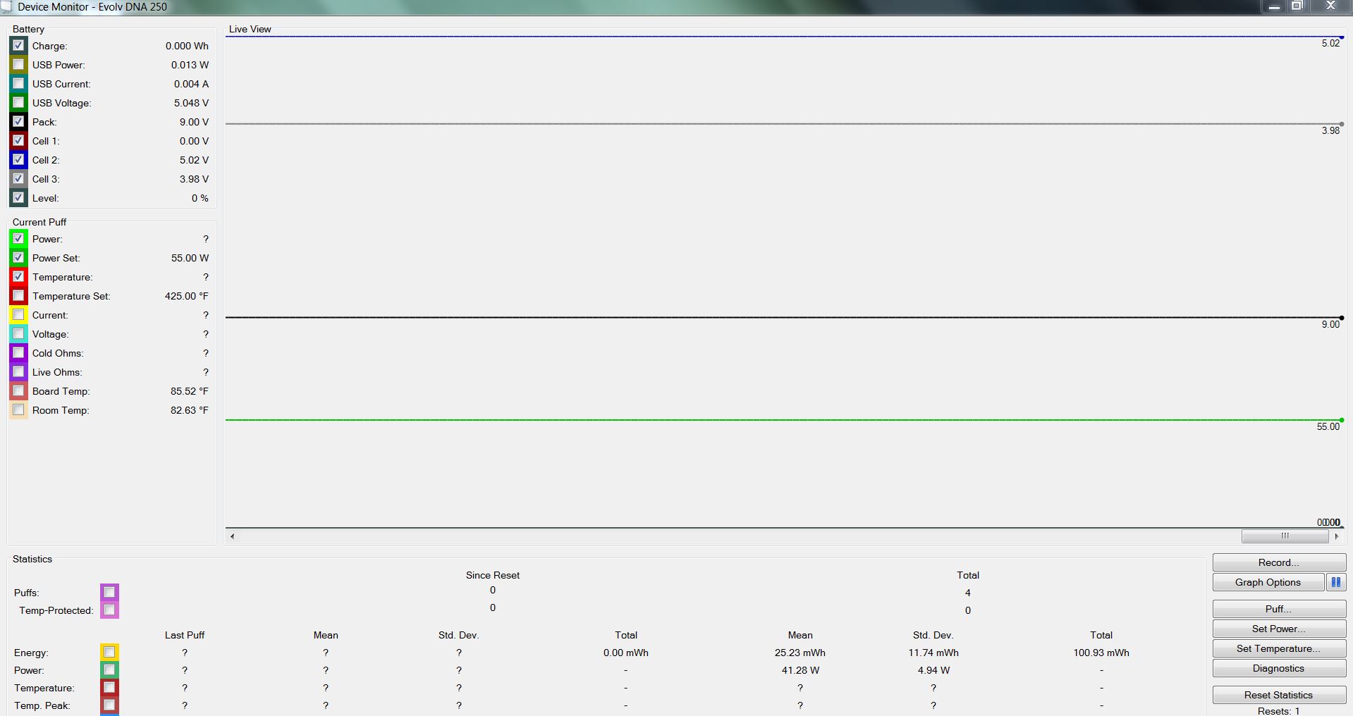

Toaster79 Posted August 14, 2017 Report Share Posted August 14, 2017 (edited) I'm on the same boat. Brand new Hcigar VT250S in 2 cell config. Cell 1 reads 0V, cell 2 reads 5.02V. Removing both cells, cell 2 still reads 2.26V. I've got 4 puffs on this device. I put 2 charged batteries in, the battery indicator shows empty batteries, so I plug my 1.5A USB charger in and after unplugging, the device won't come on again. Holding the fire buttun for long enough will show both initial screens and then "CHECK BATTERY" Edited August 14, 2017 by Toaster79 Link to comment Share on other sites More sharing options...

Toaster79 Posted August 14, 2017 Report Share Posted August 14, 2017 On 8/14/2017 at 11:21 AM, retird said: What are the voltages for all 3 cells? Expand Cell1 0V Cell2 5.02V Cell3 3.98V Pack 9V Link to comment Share on other sites More sharing options...

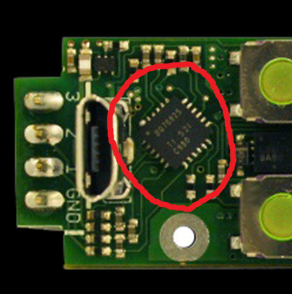

Toaster79 Posted August 14, 2017 Report Share Posted August 14, 2017 On 8/14/2017 at 11:33 AM, retird said: You might have HCigar replace it... Expand It's the board, the wee little chip mentioned above. It happed the same moment I disconected the USB charger. Link to comment Share on other sites More sharing options...
