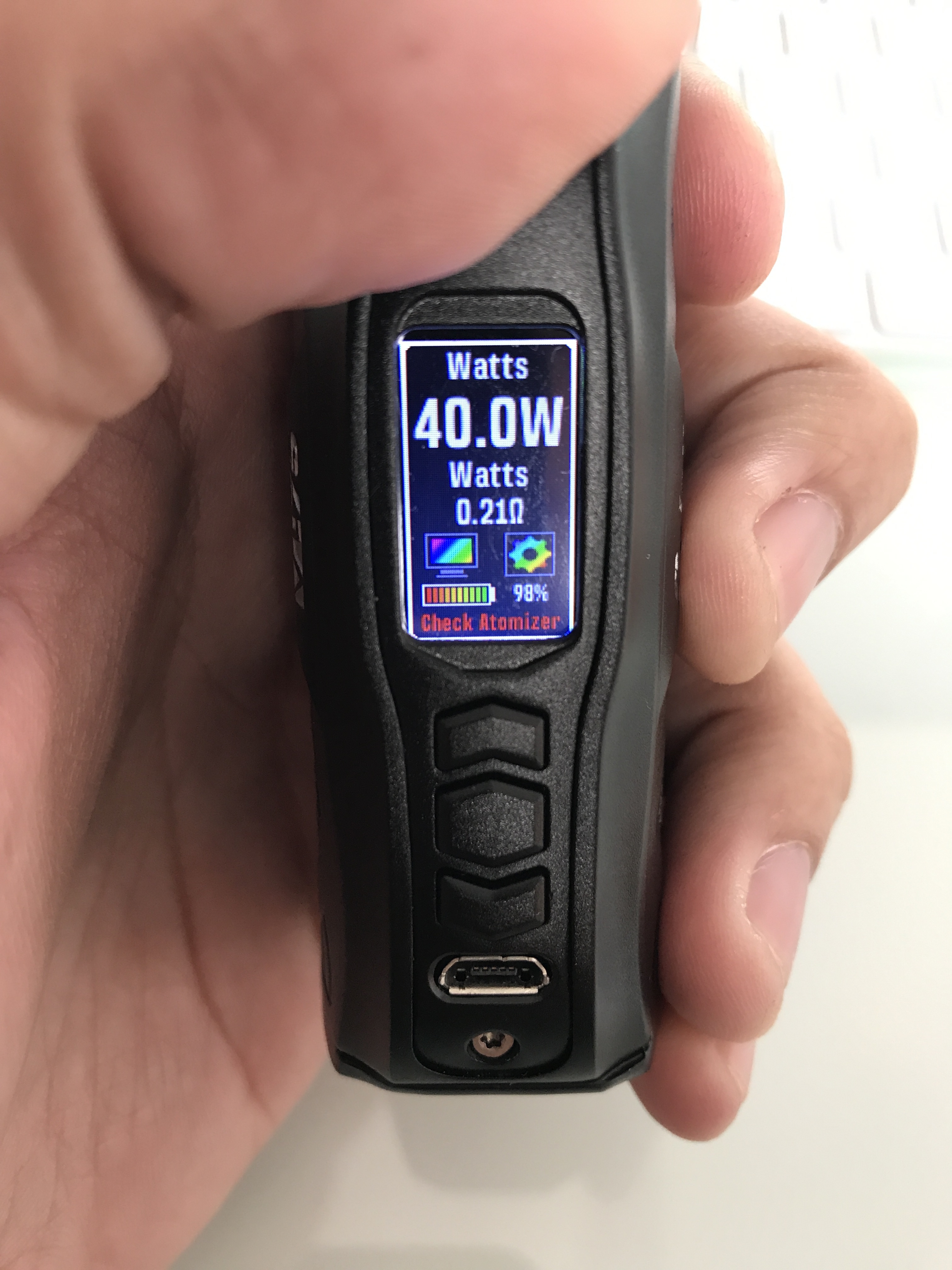

Hi there,
I`ve bought the VT 75c from Hcigar about 2 days ago. Everything was working flawlessly. After updating to the latest service pack (SP23), I've been getting a check atomizer message and the mod is not working anymore.
Is there anyway i can downgrade the firmware to check if its a software issue? Where can i find the file for downgrade?
I`ve tried a lot of different atomizers, changed battery... same thing.

The only profiles I've tested were watts and SS... both of them were the same!! But now that I've downgraded I'm not getting the message anymore!!
Thanks james!
