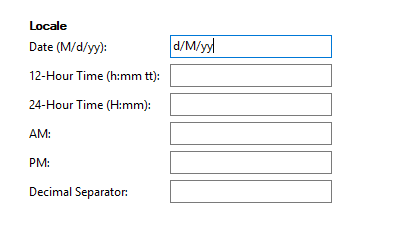

Andersen Posted June 7, 2017 Report Posted June 7, 2017 There are some countries that write the date in a another order, so I was just wondering if its was, or could become possible to change the date between M/D/Y and D/M/Y?
eucalyptus. Posted June 7, 2017 Report Posted June 7, 2017 Hello. eScribe -> Theme Tab -> Theme Designer -> Language Tab -> Locale : Date (M/d/yy) ex) 17/6/8 : yy/M/d 17/06/08 : yy/MM/dd 17-06-08 : yy-MM-dd
giz_60 Posted June 7, 2017 Report Posted June 7, 2017 Yes, in Theme Designer, go to the 'Language' tab...right column, last section 'Locale', you can change the order there....d/M/yy...that should change the order on the screen...

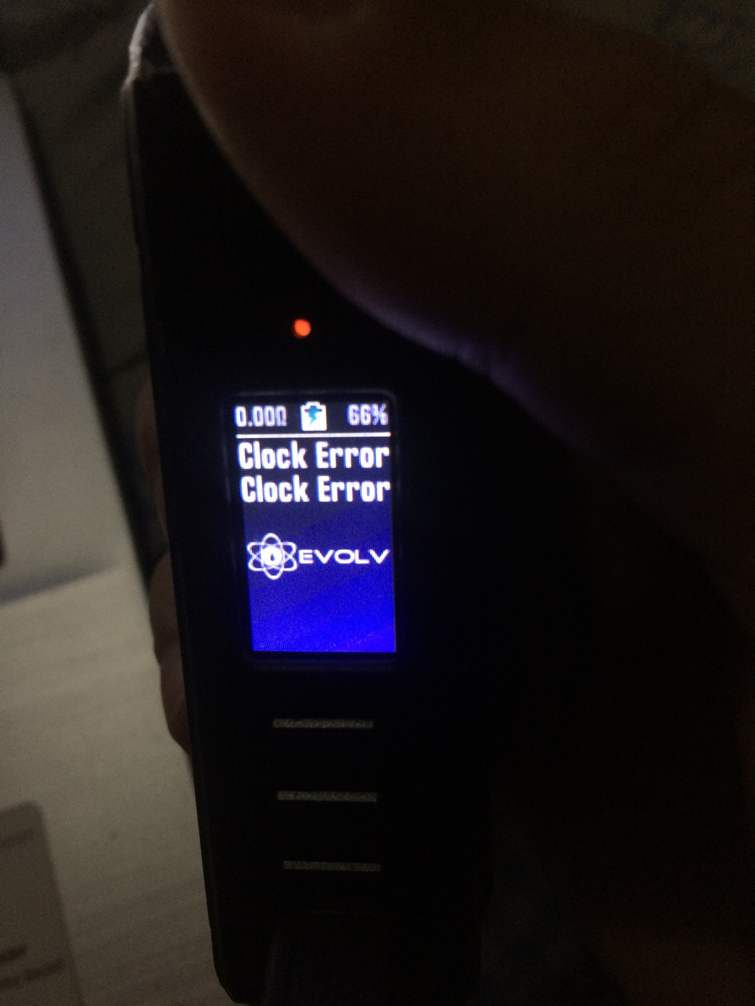

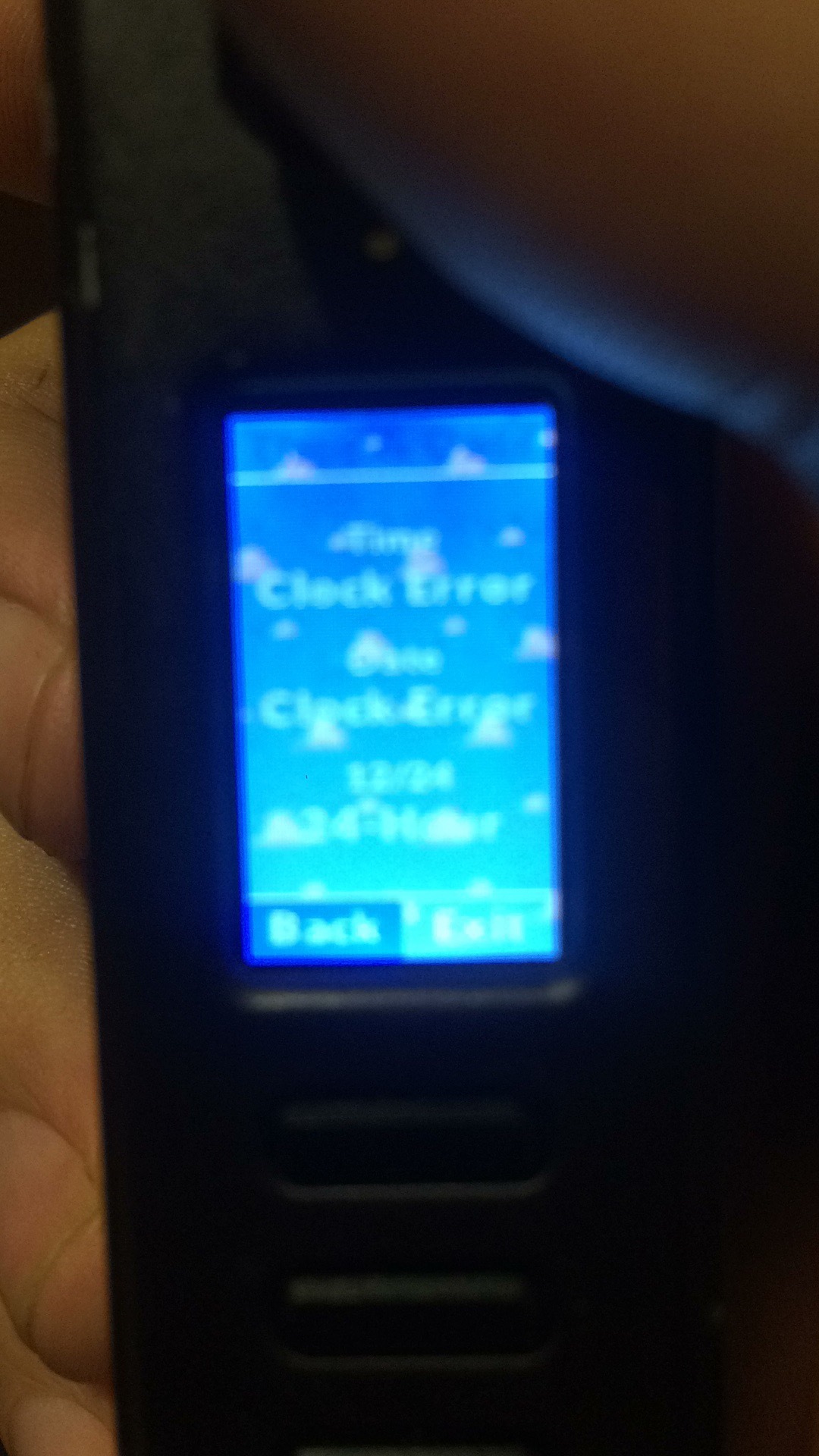

Fathur Rahman Posted August 10, 2017 Report Posted August 10, 2017 please help me, time and date "clock error". How fix problem?
retird Posted August 10, 2017 Report Posted August 10, 2017 Have you tried reloading the original ecig file or the theme from the original ecig file? Have you made any changes to the theme or ecig file recently? If you can post a copy of your ecig file we can look at it for anything that may need setting again...
James Posted August 11, 2017 Report Posted August 11, 2017 Hmm. @Fathur Rahman, one thing to try: remove the battery and leave it without power for about 15 minutes. Then put the battery back in. (That will reset the clock. The clock stays on for a while after unplugging the battery.)
giz_60 Posted August 11, 2017 Report Posted August 11, 2017 Had this same error before...hooked mod to Escribe & opened Device Monitor...time & date were reset...
Fathur Rahman Posted August 12, 2017 Report Posted August 12, 2017 6 hours ago, James said: Hmm. @Fathur Rahman, one thing to try: remove the battery and leave it without power for about 15 minutes. Then put the battery back in. (That will reset the clock. The clock stays on for a while after unplugging the battery.) Done, btw tks🙏🙏
