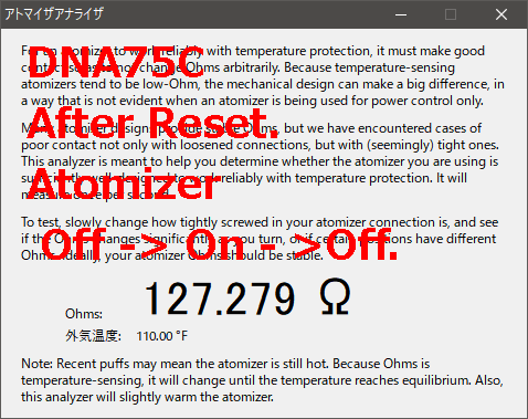

eucalyptus. 15 Posted May 28, 2017 Report Share Posted May 28, 2017 Hello. My DNA 75C is "short" when remove the atomizer. After resetting, it becomes "CHECK ATOMIZER" before attaching the atomizer. I examined it with ATOMIZER ANALYZER, after removing the atomizer, the value of 100 ohms or more appears. My MOD is actually not short-circuited. Is there a problem with my board? . Revision:20 Theme:Default Theme. ( "Factory Setting Reset." ) Link to post Share on other sites

eucalyptus. 15 Posted May 28, 2017 Author Report Share Posted May 28, 2017 Thank you for your reply. 510 The connector is removed once it is confirmed. Resistance value between ATM and GND is about 500 ohms when the board is not connected and nothing is connected. Since this value is almost equal to normal DNA 75, it is judged that it is not physically short-circuited. Link to post Share on other sites
