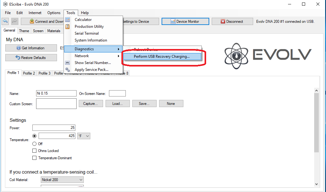

retird Posted May 20, 2017 Report Posted May 20, 2017 You received your new device with batteries that drained down too low. You can try to do a USB Recovery Charge to see if they will recharge. This takes a long time and you may need to do it more than once. It may not recharge however and the 3 cell battery will need to be replaced... If this is a new device you may want to see about getting it replaced by your vendor.
Fruhji Posted May 20, 2017 Author Report Posted May 20, 2017 Thank you for your fast answer. How can I notice if the USB Recovery Charging is working or still going on?
retird Posted May 20, 2017 Report Posted May 20, 2017 You can see if it is charging in Device Monitor after you start the recovery.... You can monitor it and see if the cells "come back in balance and charge".... as stated this will take some time and may need to be done more than once.

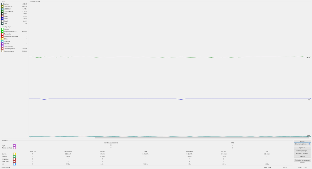

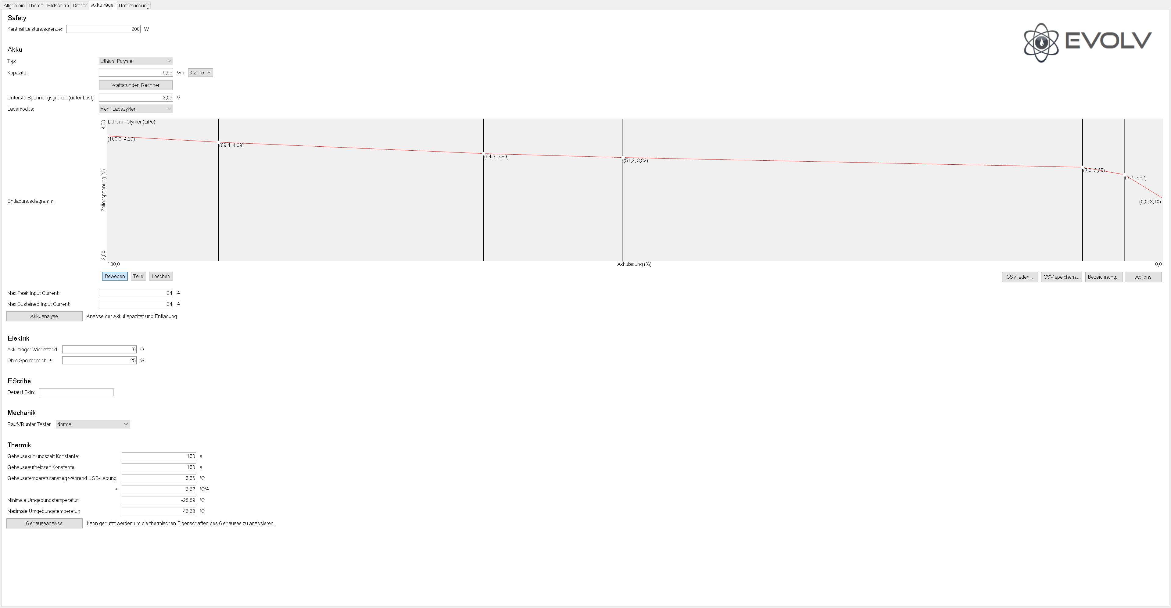

retird Posted May 20, 2017 Report Posted May 20, 2017 The battery cells have not charged at all and the voltage has not increased or changed on any cell? It would be helpful if you can post a screenshot of Device Monitor (while doing a Recovery Charge session). Also post a screenshot of the EScribe Mod tab settings.
Fruhji Posted May 20, 2017 Author Report Posted May 20, 2017 One picture shows the monitoring while doing the recovery charging. The other one shows the "Mod" tab.
retird Posted May 20, 2017 Report Posted May 20, 2017 It shows the battery cells have changed from the voltages you listed in your first post. My best guess is the battery is bad thus it won't properly charge. Is this the battery: https://vapingcheap.com/hotcig-dx200-battery/
