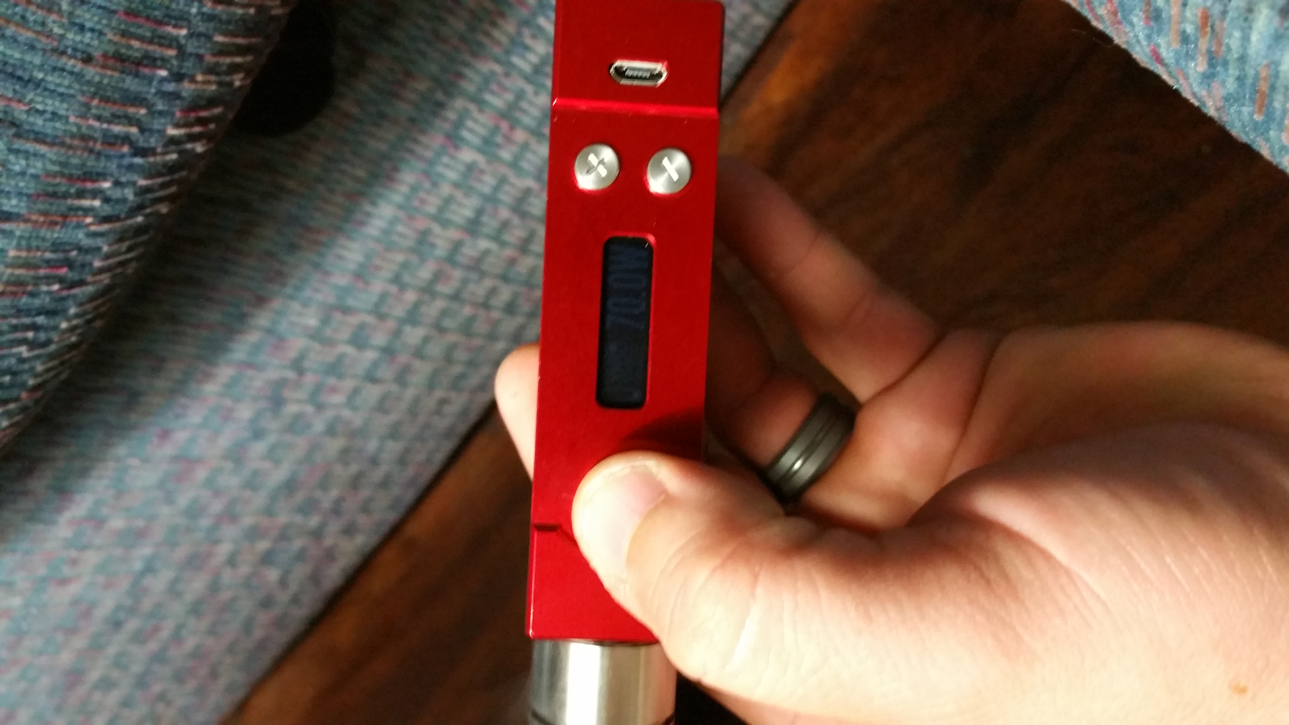

Fuzzyje Posted July 30, 2015 Author Report Share Posted July 30, 2015 I got my Hana V200 in today and the fire button was stuck down. I eventually got it unstuck and then found the screen was very very dim. It is on it does vape. I can see it if I'm in a dark room. I tried updating the brightness setting in Escribe but it stayed the same. Any ideas??? Link to comment Share on other sites More sharing options...

Fuzzyje Posted July 30, 2015 Author Report Share Posted July 30, 2015 It is always dim. Does not change brightness when the fire button is pressed. Update settings does display on the screen but very dim. Link to comment Share on other sites More sharing options...
Fuzzyje Posted July 30, 2015 Author Report Share Posted July 30, 2015 This as bright as it gets. Link to comment Share on other sites More sharing options...
