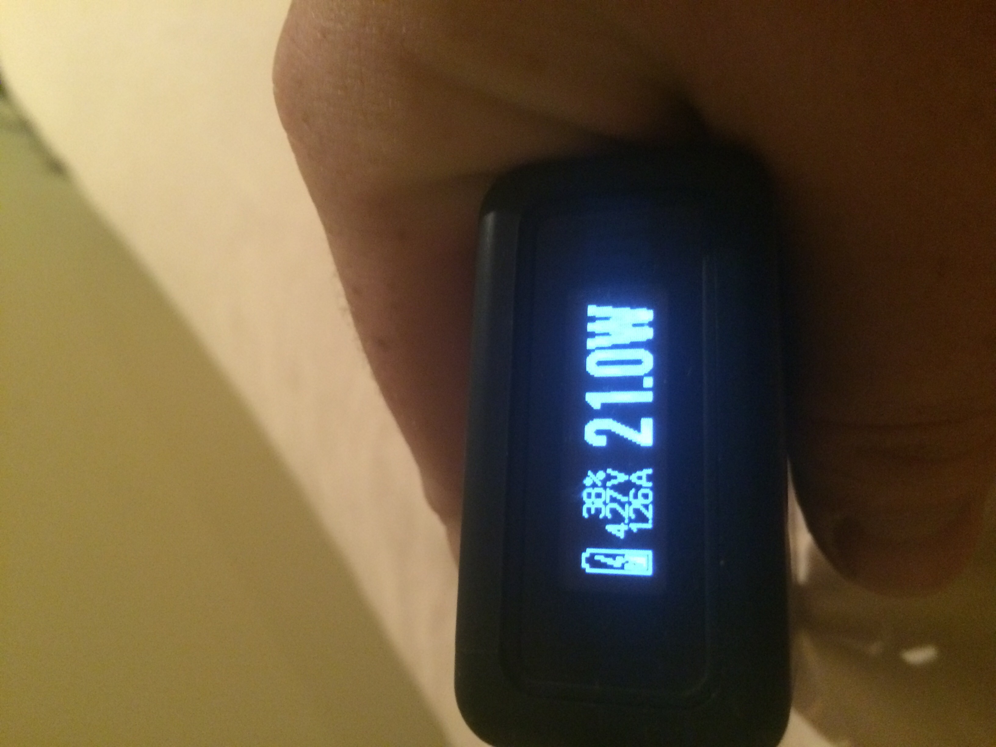

Just got my vapor shark DNA 200 yesterday and I think something happened while charging... I plugged it into my usb power bank shortly after I got it and plugged it in the 2.1 amp port and saw it charging at 1.94 amps... Came back a few mins later and the usb battery was dead... Appears to me that it's fried... Won't work at all now.. I've tried plugging my vapor shark into 6 different usb chargers advertised as being a 2.1 amp charger and I'm only getting 1.0-1.3 amps max now... Has anyone experienced this?

It will charge at .5 amp and 1 amp but not 2.1 amp anymore.... The vapor shark has a "zip" charge feature that you can charge at 2.1 amps
