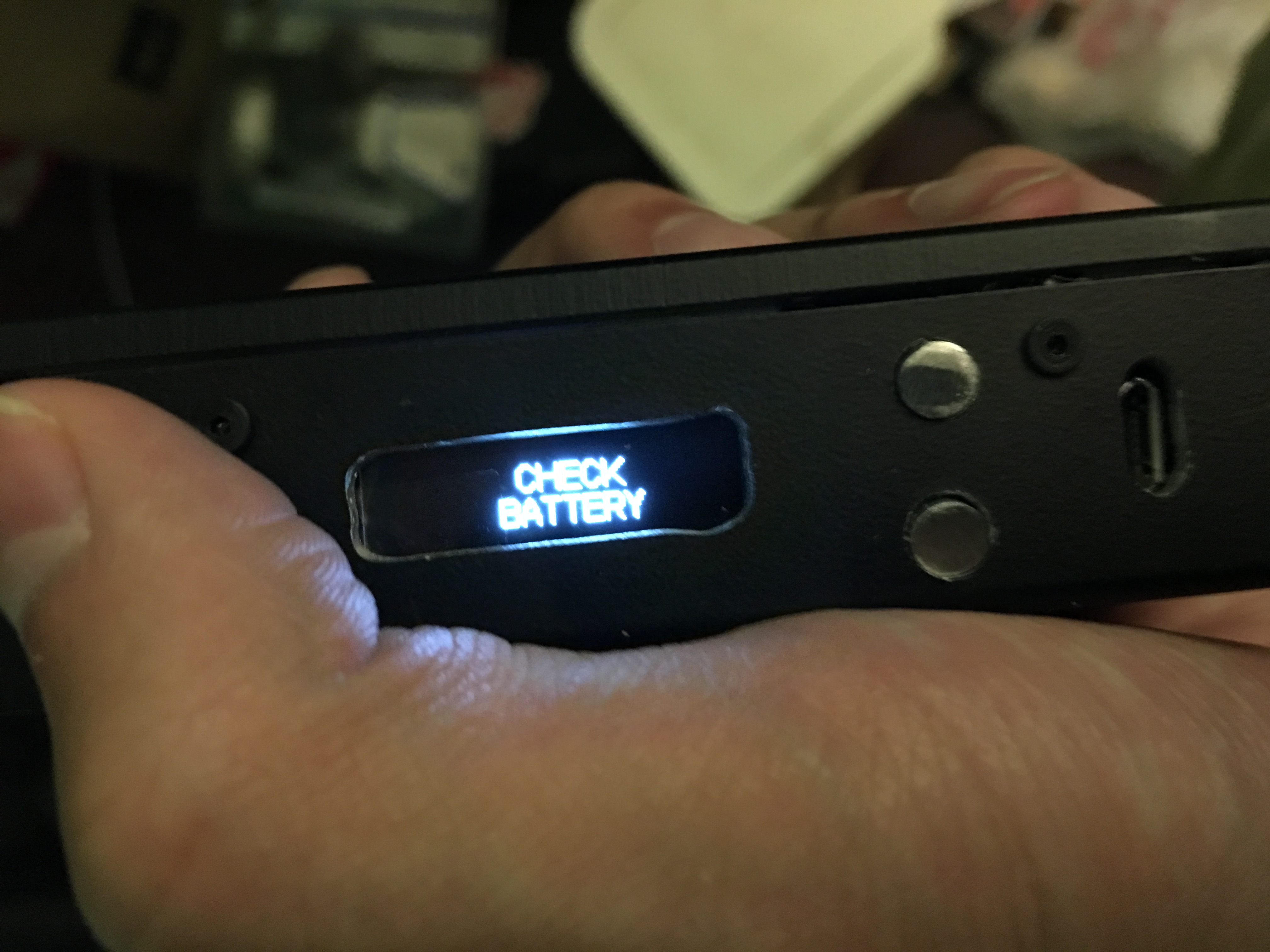

Jonnyvu Posted October 29, 2015 Author Report Posted October 29, 2015 Helllo guys, just built my first dna200 box so I'm not sure what to expect. When ever I fire it reads check battery without the battery display. I put the battery brightness to 80% on escribe aswell. Dont even know if my battery is charging. Anyone know what's wrong and how to fix ?

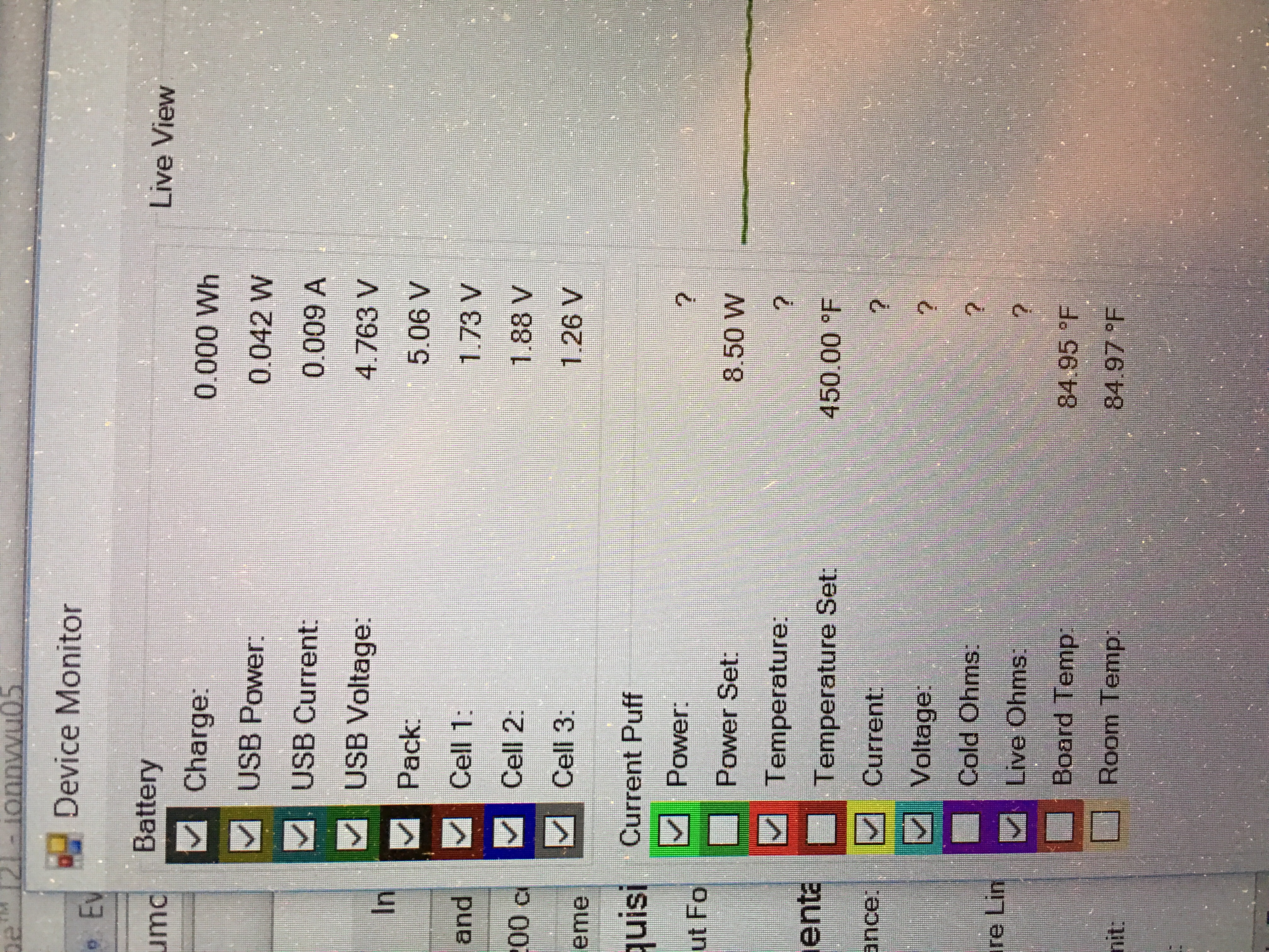

awsum140 Posted October 29, 2015 Report Posted October 29, 2015 Have you checked using device monitor in eScribe? That will give you detailed information on the battery condition.
Jonnyvu Posted October 29, 2015 Author Report Posted October 29, 2015 Yes I have there's no data on the battery. It just stays at zero.

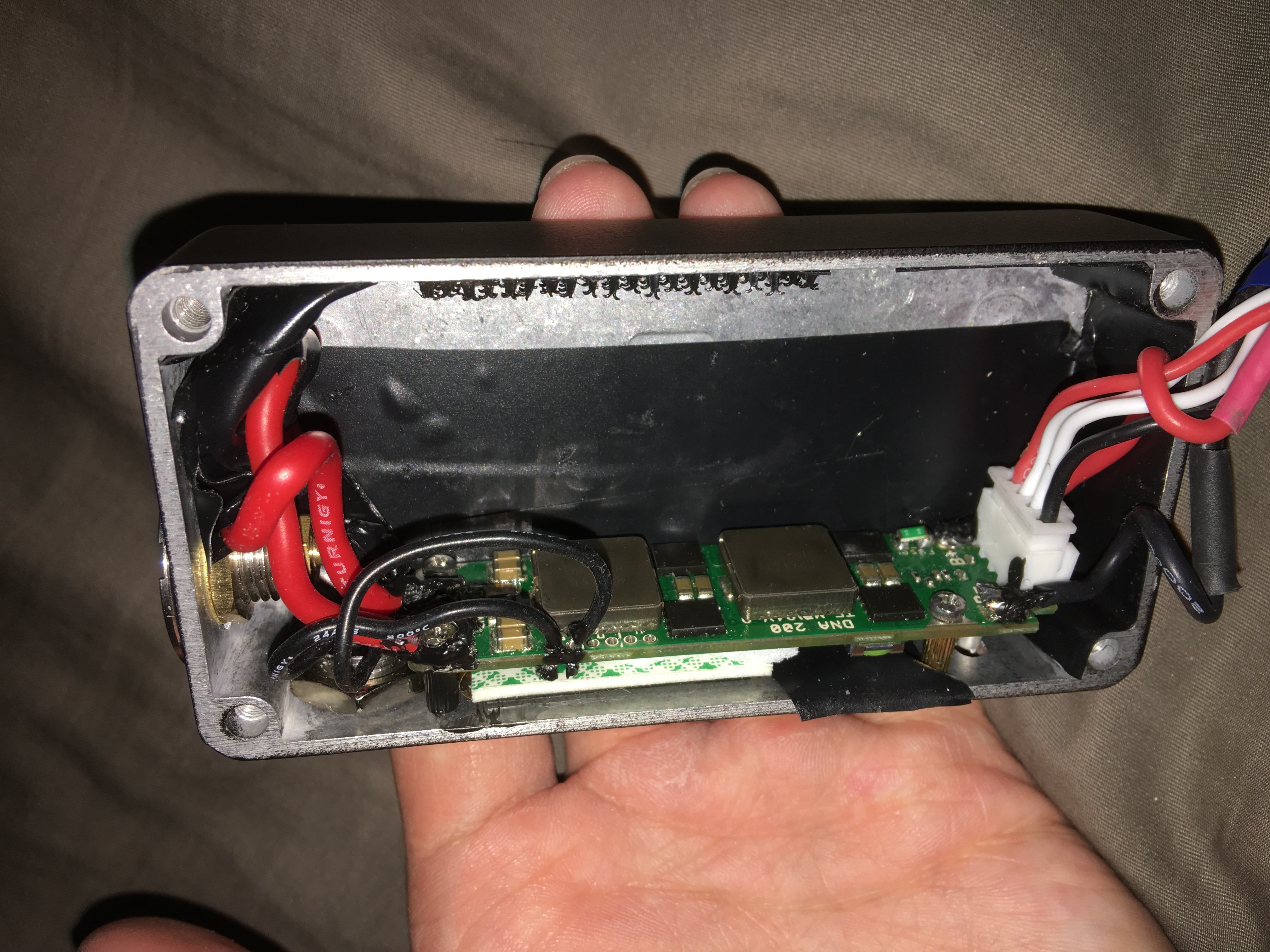

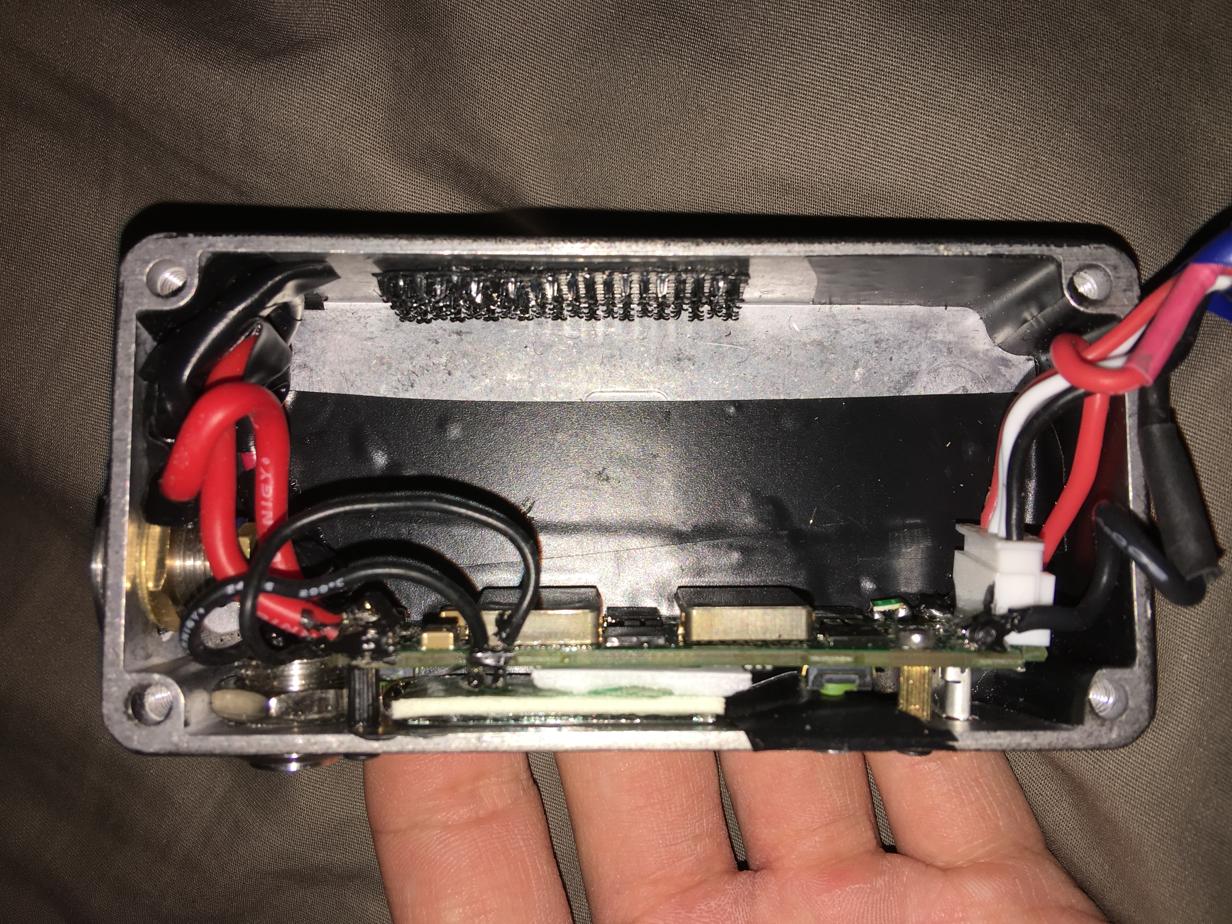

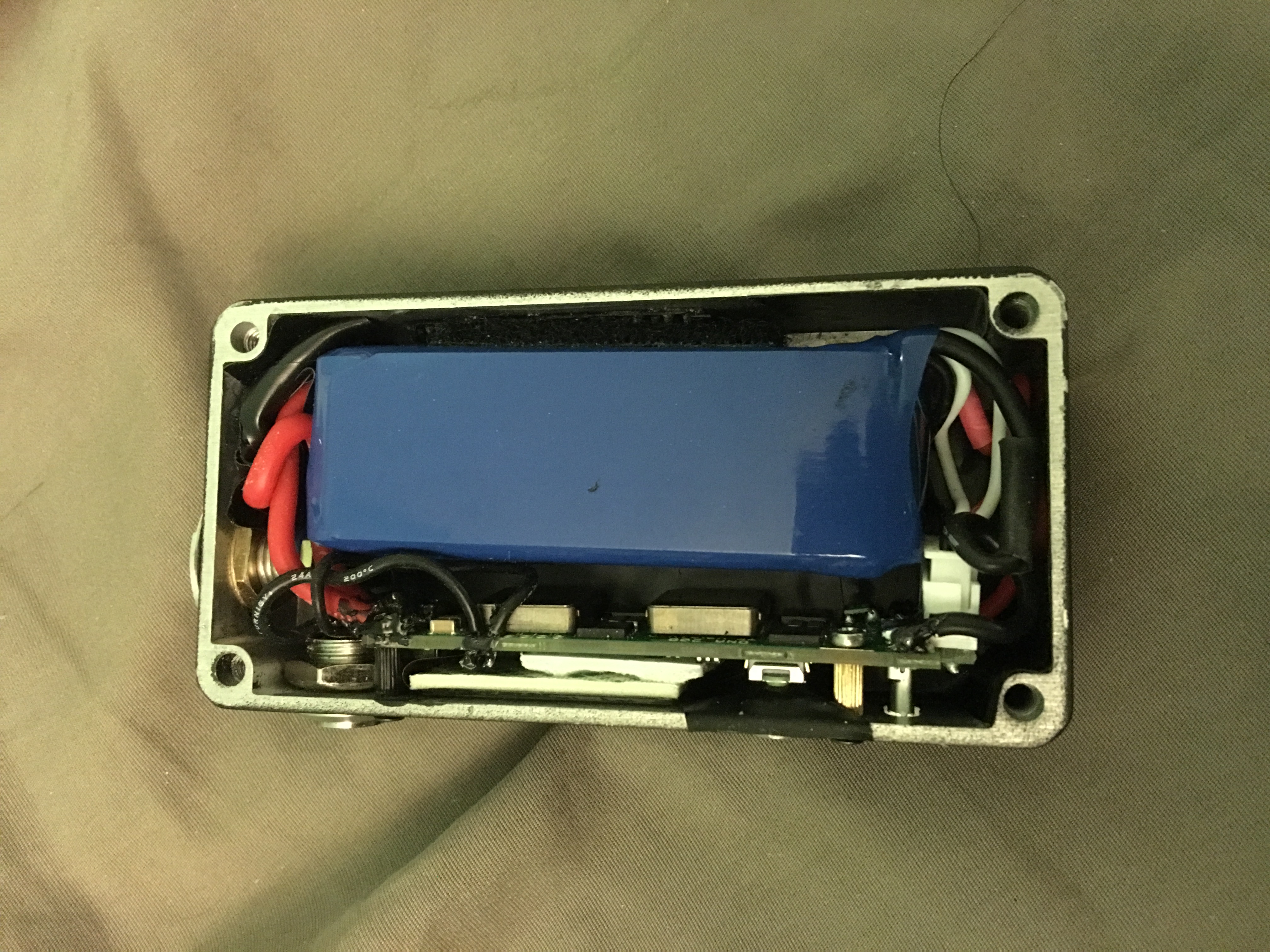

retird Posted October 29, 2015 Report Posted October 29, 2015 How about some pictures of the inside of your build?

Jonnyvu Posted October 30, 2015 Author Report Posted October 30, 2015 Here are some photos. It's a Hammond g box, mitec switch, fdv4 510, fullymax 900 Lipo 3s.
Jonnyvu Posted October 30, 2015 Author Report Posted October 30, 2015 On device monitor what charge settings should I have?
scoopy Posted November 3, 2015 Report Posted November 3, 2015 Try a USB recovery charge........your battery cell voltages are very low
blueridgedog Posted November 4, 2015 Report Posted November 4, 2015 The pack is below what can take a charge. As scoopy mentioned, try the recover option (you may have to try it a few times) or replace the pack. Is it new?
