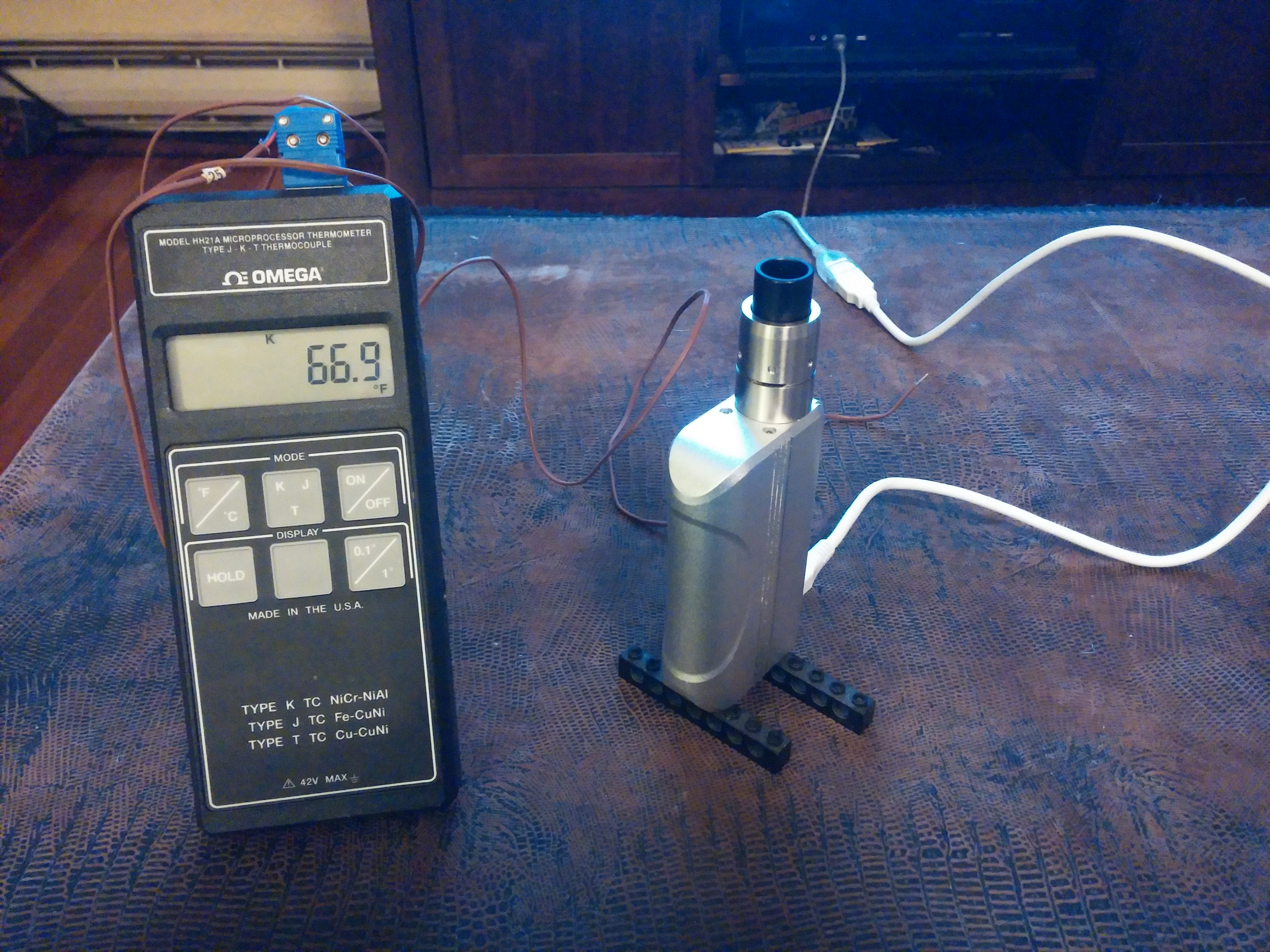

I just ran the case analyzer for the second time on my new VT200. Once yesterday and once today. Details below. Silver VT200, serial 10545 (supposedly has the gold plated 510) with the original battery that's gone thru about 3 cycles.
-Room temp at 67F and held within .5 degrees throughout duration of test.
-Very slight cross draft at about .5 ft/sec -Mod standing upright on plastic Lego blocks to allow air into bottom case vents.
-Mod had a stainless Velocity RDA (used, woth dual coils and juice in it) installed throughout duration of test.
-Battery charge level at beginning: 40%
Test duration was 4.5 hours
1st test result:
Cooling: 454.15
Heating: 1232.73
USB: 6.37
F/A: 15.61
Second test was the same except there was no Atty installed and there was a slightly greater down draft from a ceiling fan.
2nd test result:
Cooling: 498.72
Heating: 1283.26
USB: 6.78
F/A: 19.91
Pic of the test in progress attached
As a side note: I set the mod resistance to 0 as it reported incorrect Atty resistance if I used the values found around the internet. I measured the atty myself using a Fluke multimeter. Mod reporting now matches. Battery test underway now.

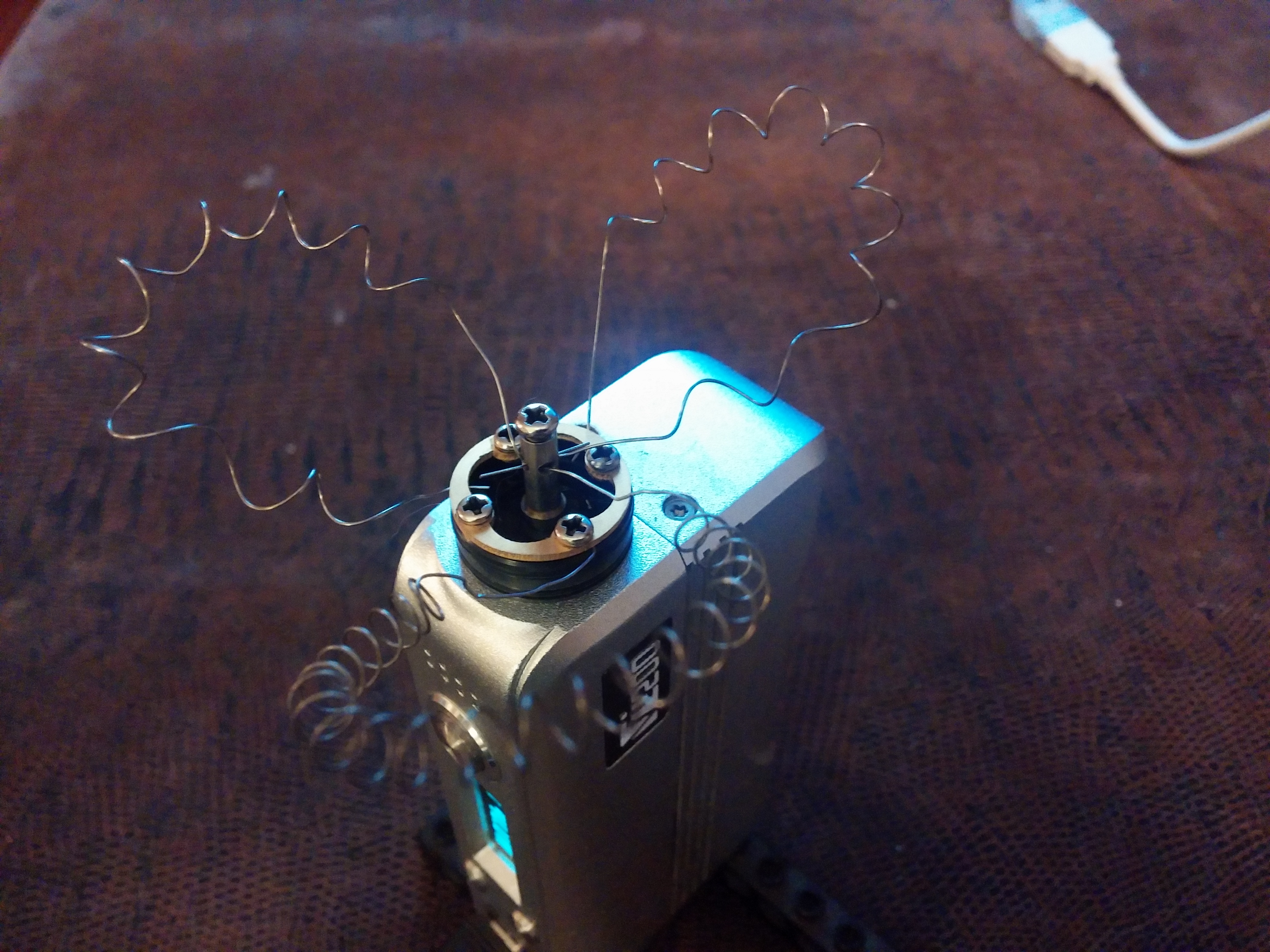

Follow-up on mod resistance...I threaded a copper slug and ran the atty analyzer again.  It reported .004 Ohms.  I've read people advising to use between 50-80% of the reported value, so I went ahead and plugged in .002 as the mod resistance. It didn't make much, if any, difference.  Just reporting my measurement results.
Battery test finished. Took about 45 minutes. I took a couple junk coils I had laying around and put them in an empty big block build deck to act as the resistor. Two wasnt enough but three was way more than enough. They got hot but didn't glow during continuous 40W test fires. The test pulses the coils. On for 10 seconds. Off for 20. I believe this continues until the weak cell drops to the programmed cutoff voltage. In my case this was 3.09V. The pack has one cell that diverged quickly as voltage approached 3.3V or so. The other two cells never dropped below 3.2 before the test concluded. Result: 9.07 Wh I'll probably run it again every day for a couple days to see if the battery pack improves after a few more cycles. Pic of Atty "resistor" attached. I think the coils were about 26ga kanthal and measured 2.46 ohm each. I had a ceiling fan blowing to keep things cool.
