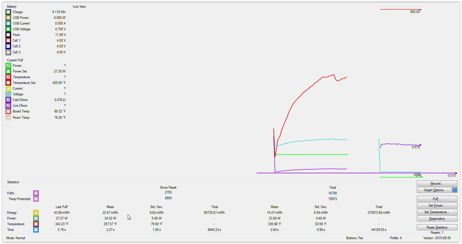

I'm using the hCigar VT200.  I have a 0.08 ohm NI200 coil in an Steam Crave Aromamizer tank using my own coil in the RBA section.  Watts are set to 27.3 and the temp is set to 420 degrees.  As you can see in the graph, I take 1 hit and everything is perfect.  When I take the 2nd hit, the coil doesn't fire and Evolv software says my coil is at 800 degrees.  So I have to wait a while till I can take another hit.  Does anyone have any idea on how I can fix this?  Thanks in advance :)

Thanks VapingBad.  I replace the coil and see if it stops.  Thanks
UPDATE:  I changed the coil and it is now working fine.  The screws were not as tight as they were when I made the coil but they seemed to be still making a good connection.  But after changing the coil and having no problem, there must have been a loose connection.  Thanks again VapingBad.
