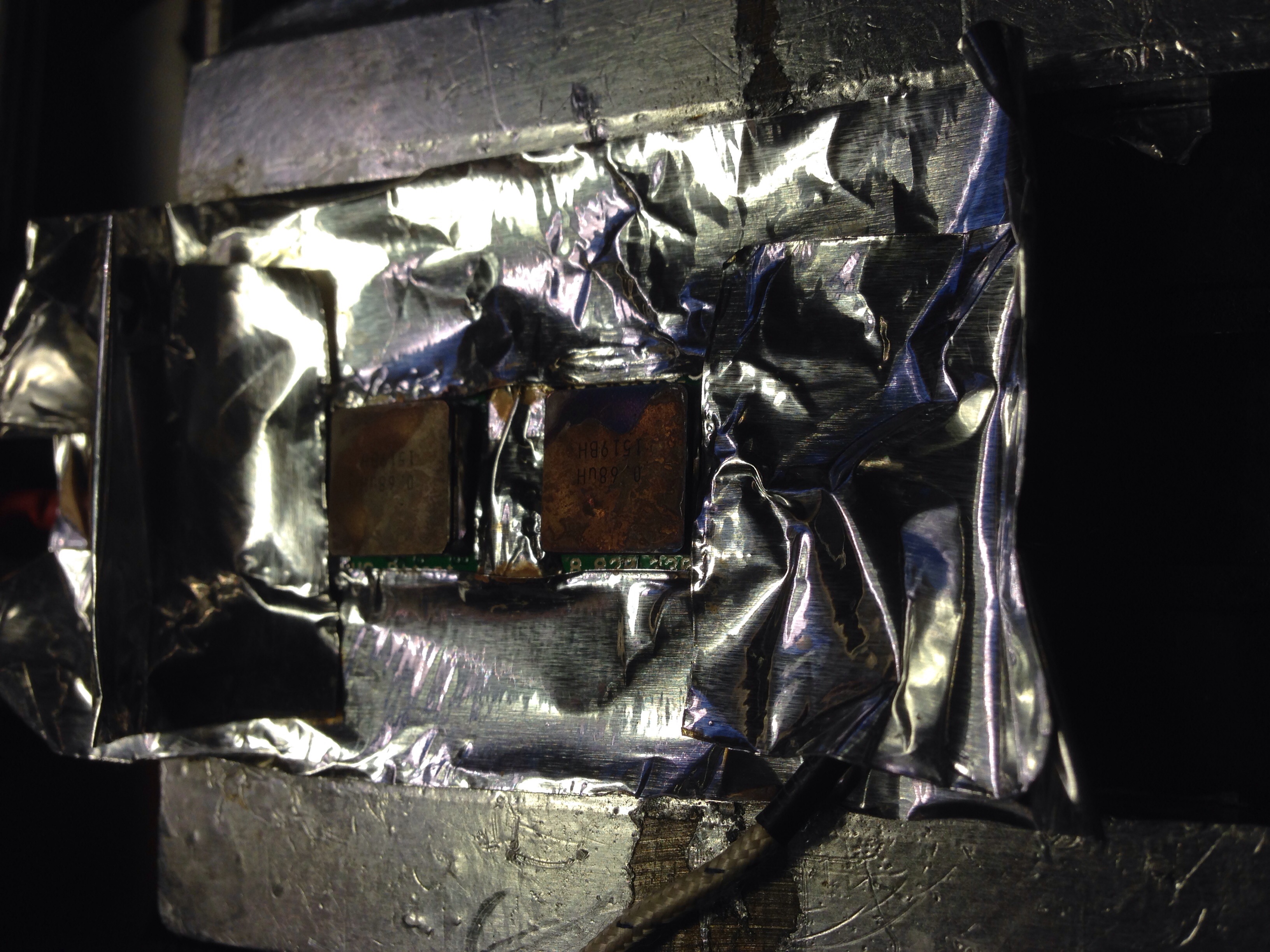

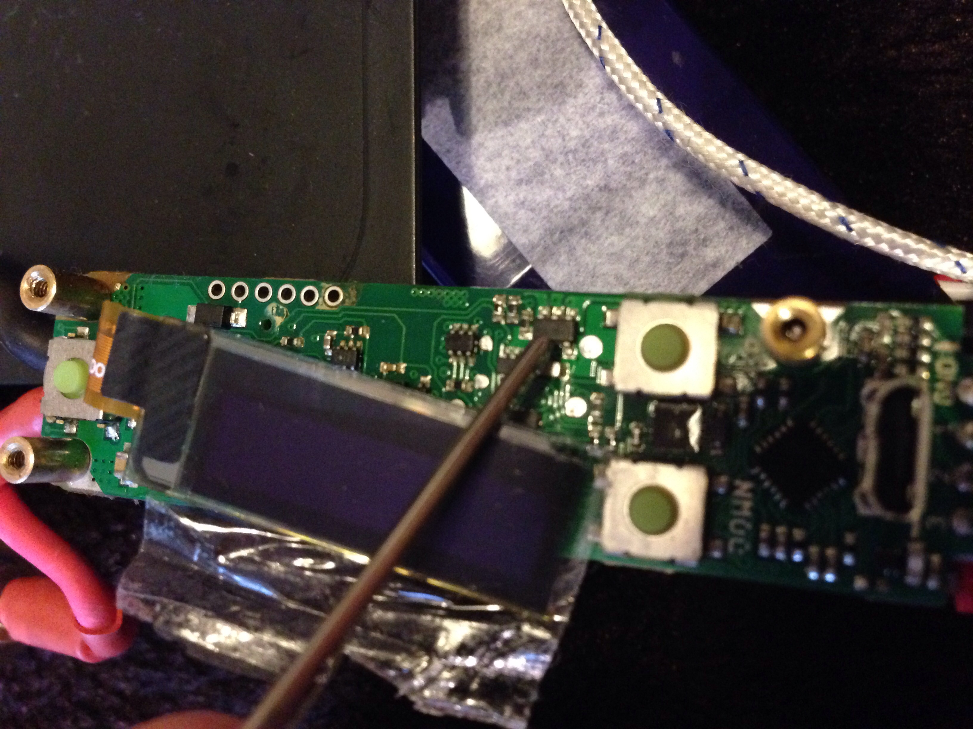

Hi I am an avid fan of the DNA 200 and own 3 home made mods and in the process of building a 4th. My first 2 builds are the 2 I use all the time and get plenty of stick and have run flawlessly. The 3rd has been a bit of a pig 1st fault was constant firing and "warranty service " message after loading a ti csv that had worked great on my other 2 mods. Stealthvape replaced the board without issue ( rob dam fine chap) The replace ment board has had very little use but with a kanth coil it suddenly died with "warranty service " message I sent a photo of the board to rob he pointed out that one of the large inductors looked slight raised in the photo As I have a ir rework station and am used to reflows and bga work I decided to attempt to drop the chip back to where it should be This was a success although the temps involved were higher than I like due to the thickness of the smc All seemed well I tested the board out of the case and noticed a component getting hot even at idle (see photo for part that's getting hot) It carries on getting hotter and hotter and the board goes dead the on/off button won't work but when plugged into USB it starts up and works but the heating issue starts all over again. I think the initial lifting of the inductor was a symptom of what ever is causing the over heating. I have checked the board for shorts Any help or pointers greatly received All equipment is esr safe All joints nice Heat protection used while reflowing Bga flux used Boards cleaned with isopropyl after any work

Hi thanks yes I have tested the buttons and they are fine, it fires fine it just won't do the initial boot. It will come out of sleep. I make my own buttons so they alway run with a little to spare. I think the issue is with the what I assume is a fet but I can't fine a board diagram to confirm it Thanks for the reply though Jim
