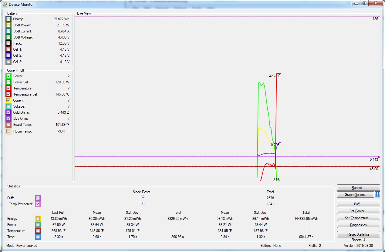

That's what i want, but its not what i am getting.
an example of my problem would be this picture
Try a higher temp, it will stop treating the coil as temp sensing if it does not increase temp by at least 150 degrees F in the first second, I know that your temp is greater than that + room temp, but it may get you closer to finding the solution.  Also I would lower the wattage so when this happens you are not getting that much power.

I increased the tempreture to 200C and reduced the resistance manually to 0.42Ohm's and it seams more stable now.
