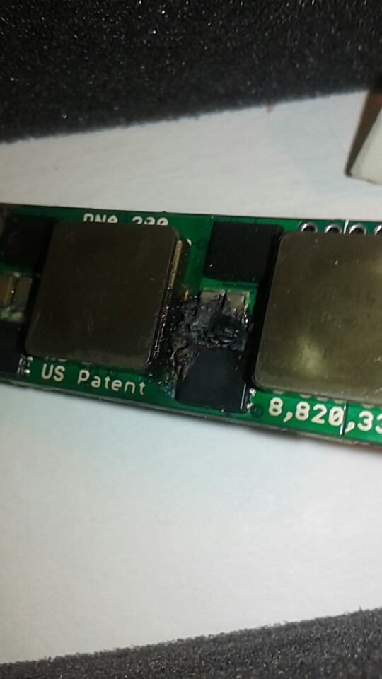

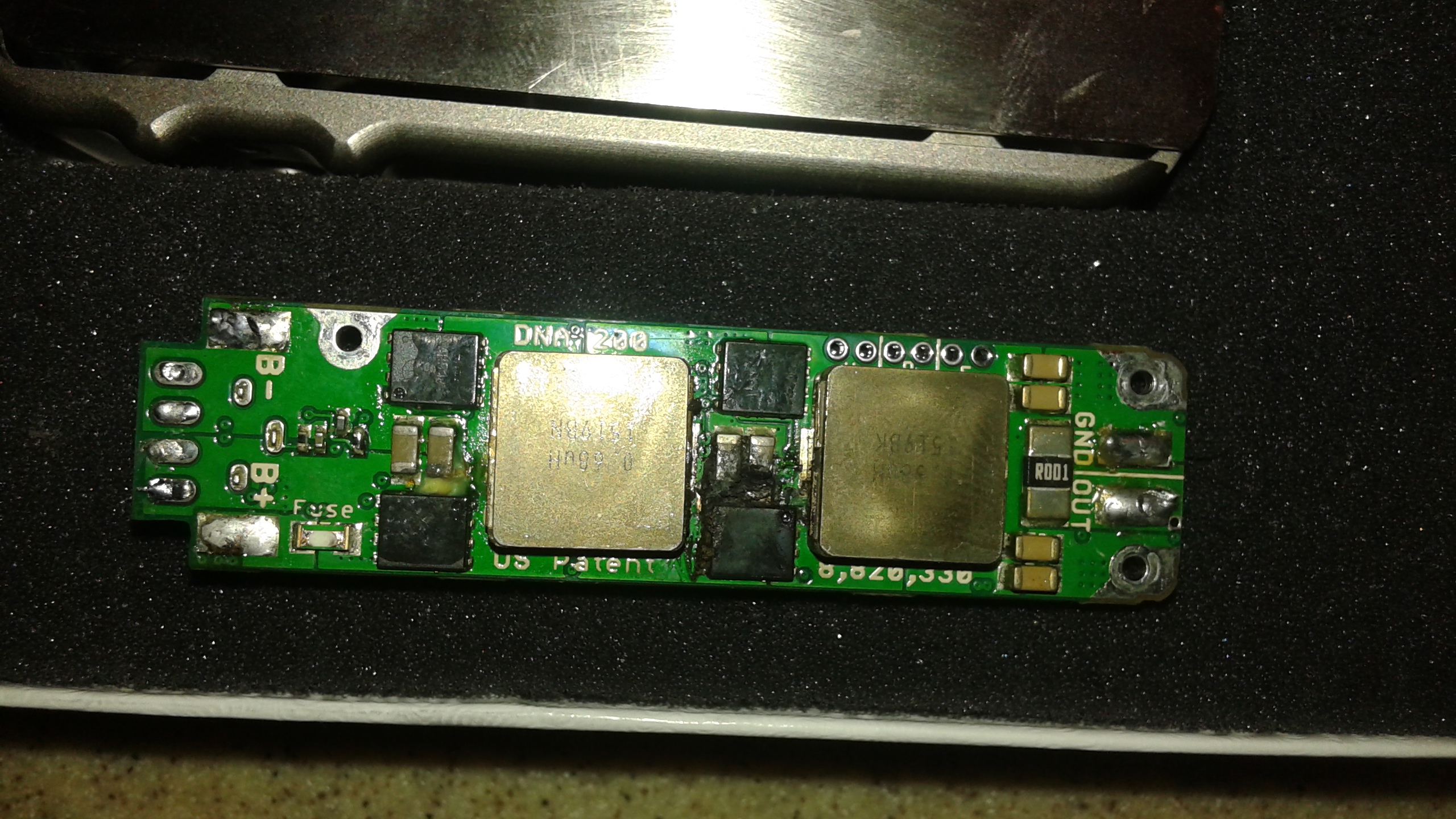

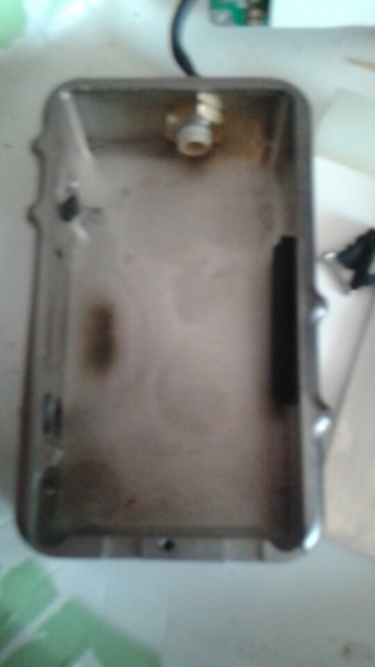

Yes I am working on that being the weekend I decided to open it up it did blow the fuse but not until if fryed the board thank full it has a fuse batteries still charged by volt meter 4.1 each pack my only concern is how long I am going to be down my opus DNA 200 has spoiled me for life big time

I could not find anything shorting touching anything the mod did what I thought was a hard auto fire for less than 2 seconds it was sitting next to me on the night stand looked over seen puff of smoke coming from the box getting ready to get it out of the house quick but when I picked it up it was cold same with the atty and dead my battery packs are still showing 4.1 volts each glade it has a fuse I really tock my time opening it up on a super clean work zone everything looked perfect but board and fuse are history man I fell sick
yep, you fried that mosfet. definitely need a new board.
Posted
ChunkyButt200 said:
[QUOTE=Modbustets]Yes I am working on that being the weekend I decided to open it up it did blow the fuse but not until if fryed the board thank full it has a fuse batteries still charged by volt meter 4.1 each pack my only concern is how long I am going to be down my opus DNA 200 has spoiled me for life big time
yep, you fried that mosfet. definitely need a new board.[/QUOTE] any idea why ?
Posted
Modbustets said:
[QUOTE=ChunkyButt200][QUOTE=Modbustets]Yes I am working on that being the weekend I decided to open it up it did blow the fuse but not until if fryed the board thank full it has a fuse batteries still charged by volt meter 4.1 each pack my only concern is how long I am going to be down my opus DNA 200 has spoiled me for life big time
yep, you fried that mosfet. definitely need a new board.[/QUOTE] any idea why ?[/QUOTE]there's a couple of theories on how it could of fried. as black lace stated in his post, if there was a stray piece of wire (one tiny strand of copper is all it takes), it could of found a spot on the board where there was no conformal coating and hard shorted. sometimes when soldering, a tiny blob of molten solder will fling off of the iron tip or the pad you're soldering and roll around inside of the enclosure, eventually finding it's way to the board shorting out a section. a direct atty hard short i.e. super low resistance, poor soldering at the GND and Out pads creating a hard short. pretty much anything conductive, creating a hard, will fry electronics.

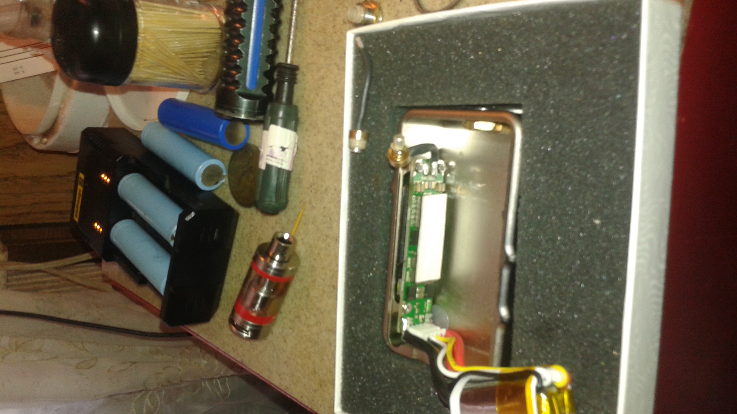

Sorry no it had been setting for about 20 min. and then I hear what I thought was the mod firing looked over to see puff of smoke grab the mod and from past experience with lower end mods auto firing ready to head for the door and remove the atty but mod and atty were cold it was at that point i relized it had not fired the atty .And the mod was dead I guess do to fuse popping.his all happened real quick .after opening the mod up hoping to find something simple I realized how much damage was done the kanthal .33 ohms build was another thing that confused me a lot of the fuse problem seam to be tied to titanium or nickel temperature control and is what I use on this mod 99% of the time . 0.07.to 0.15 builds .again sorry about the grammar. More pic after getting the board cleaned up
Posted

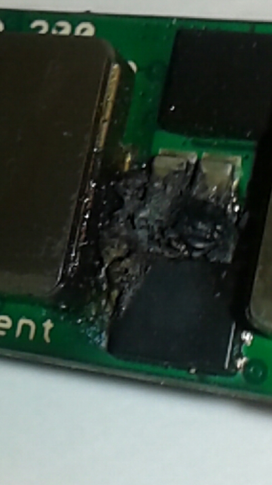

The puff of smoke came from the componeny that burned out, it may have been burning up for several minits beffor you noticed it give out. If you go over it with a magnifiying glass you may find somthing melted. Your pics arnt clear enough for us. when i did mine i melted a small hole in one of the flat black components , and the strand of wire was a single piece of 16 guage resting on two of the connector leggs,,, i had also done a repaire to the 510. It was thiner than as a hair and no.longer than a 1mm doing repairs with the board insitue is always a risk of further problems, breaking a component while .... ect. Ect....
Posted
O it did a lot of burning chunkyButt200 noted the mosfet gone I am finding stuff meted All over the board solder splater from high drain that blew the fuse I am impressed it did not melt one wire. I for one am glade for the way evolv builds safety in to there boards . I do not even pretend to know what caused the falt this board and the opus box are one nice setup. I just hope evolv and Roger can find a solution to this . I was told before I ordered my mod there was a problem .with some of them but I like the mod and the DNA 200 board and I refuse to buy any more Chinese mods . I am confident this can be worked out

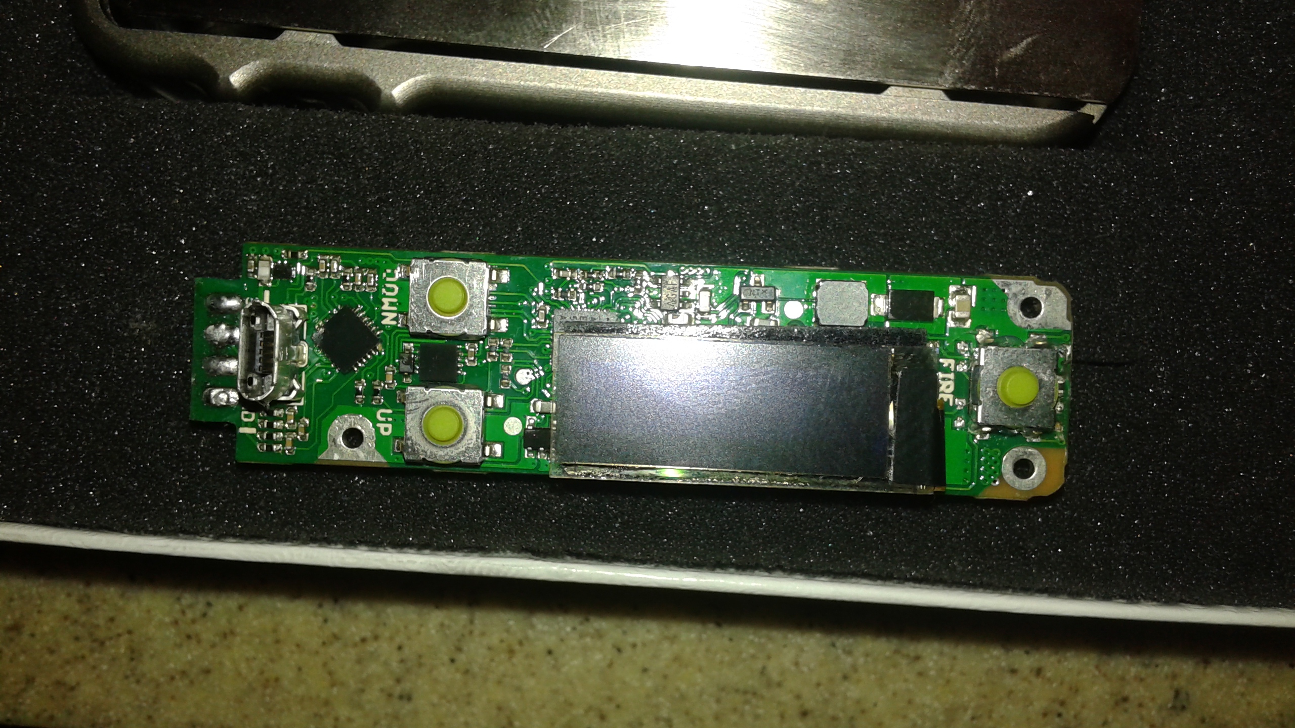

:D  A big thank you to Evol. Nick sent me out a new board and even with my shaky hands I was able to get the board installed and working great. I was really concerned about not damaging the ribbon as I was putting it in. Because I had the old board and ribbon for the screen to play with I was able to practice with it. I believe the original ribbon might still be good but I didn't want to chance it. I found the suggestions on this form about how to fold the ribbon using a card and a tooth pick to help slide it in. It worked beautiful. From what I read the ribbon was fragile. The ribbon was one of the first things i installed and got bumped around harder than I would of liked a few times. I was afraid I damaged it but it survived. If I had to do it again I'd take roger"s offer to send it back to opus to let them do the repairs. I think. I really missed my Opus DNA 200. It was down for a whole eight days. The biggest problem I run into was after installing the up dates for some reason the board stopped working and E scribe would not recognize it. I kept trying different things and then it said up dating drivers that took care of the problem. It really confused me because I had already hooked it to E scribe before updating with no problems. The only other problem I ran in to was I didn't align the screen properly. That was my fault. It was not that big of a deal to me except for my perfectionism. I also want to thank everyone that replied to this and pointed me in the right direction on opening a ticket. 20160217_135900[1].jpg
