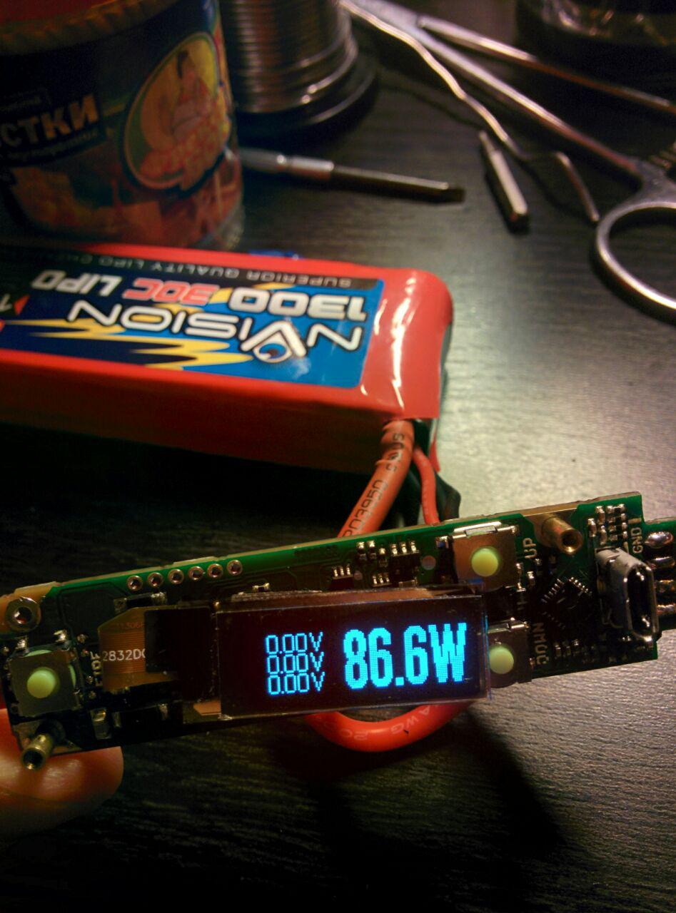

Hi everyone.
Old lipo has damadged, so i changed lipo. Now it shows 0 volts, but multimeter shows 3,61 on each cell. When i click fire button it shows error "Check Battery".
What can i make with it?

In your 1st post it shows it powered on with the battery, I don't think it would be able to do that with a bad fuse.
Does your battery have plugs or did you have to solder the wires to the board?
Are you sure that the first battery was bad? What was the problem do you think with the first battery?

I have to solder the wires. First battery was inflated and wires isolation was almost burn and red cable (V+) was close to metal case (GND). Also one cell was dead (0 volt). There was some noise on the screen and i thought the reason was bad power. ________ Hope you understand my English...

Can you put up a picture of the bottom of the board where the wires attach?
I've already cut it off. I plugged DNA to 60w power supply and it works. Probably the problem is charge controller which is above the USB. TI BQ76925
