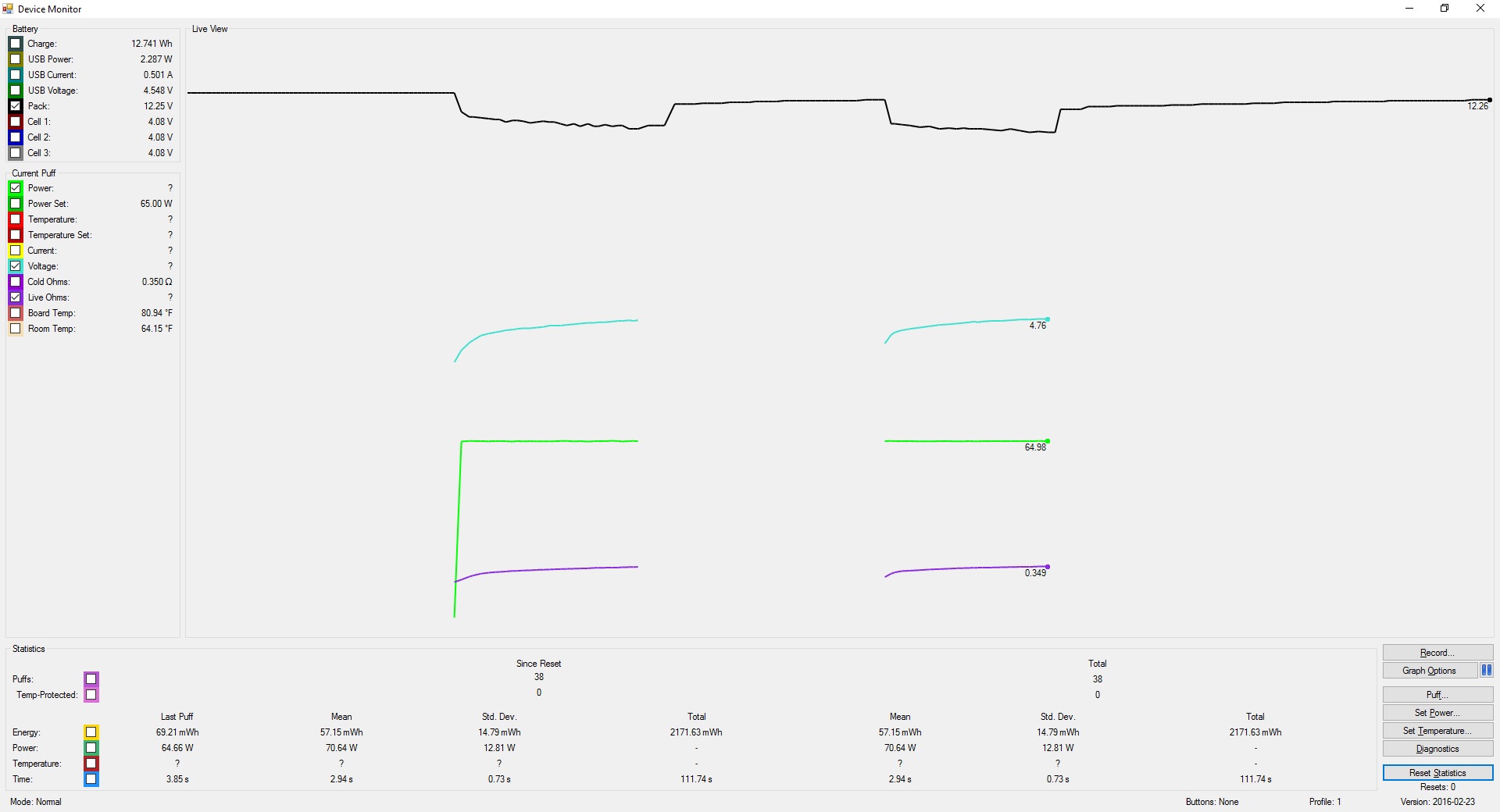

When you fire up EScribe and run the Device Monitor. Check boxes for Power, Voltage, and Live Ohms. Now vape normally and what does the graph look like? For Voltage and Power you might see a quick rise, but all three should quickly become a perfectly straight line during the vape. If they are, then I can only think of one thing. Your Laisimo isn't really hitting at the wattages you set it at, but something less (so you have to set the DNA less to match). The Laisimo also uses pulse output at higher wattages while the DNA gives you true steady wattage output.

Your post with EScribe Device Monitor screen shot also shows the live ohms increasing a bit as the temperature of the coil rises. I am guessing you are using SS in wattage mode. Thus the Laisimo is adjusting the voltage higher as the live ohms increases to maintain the same wattage.
This is correct. I'm fairly new to all this so I apologize for not understanding everything ahead of time. I figured that both devices would work somewhat the same.
