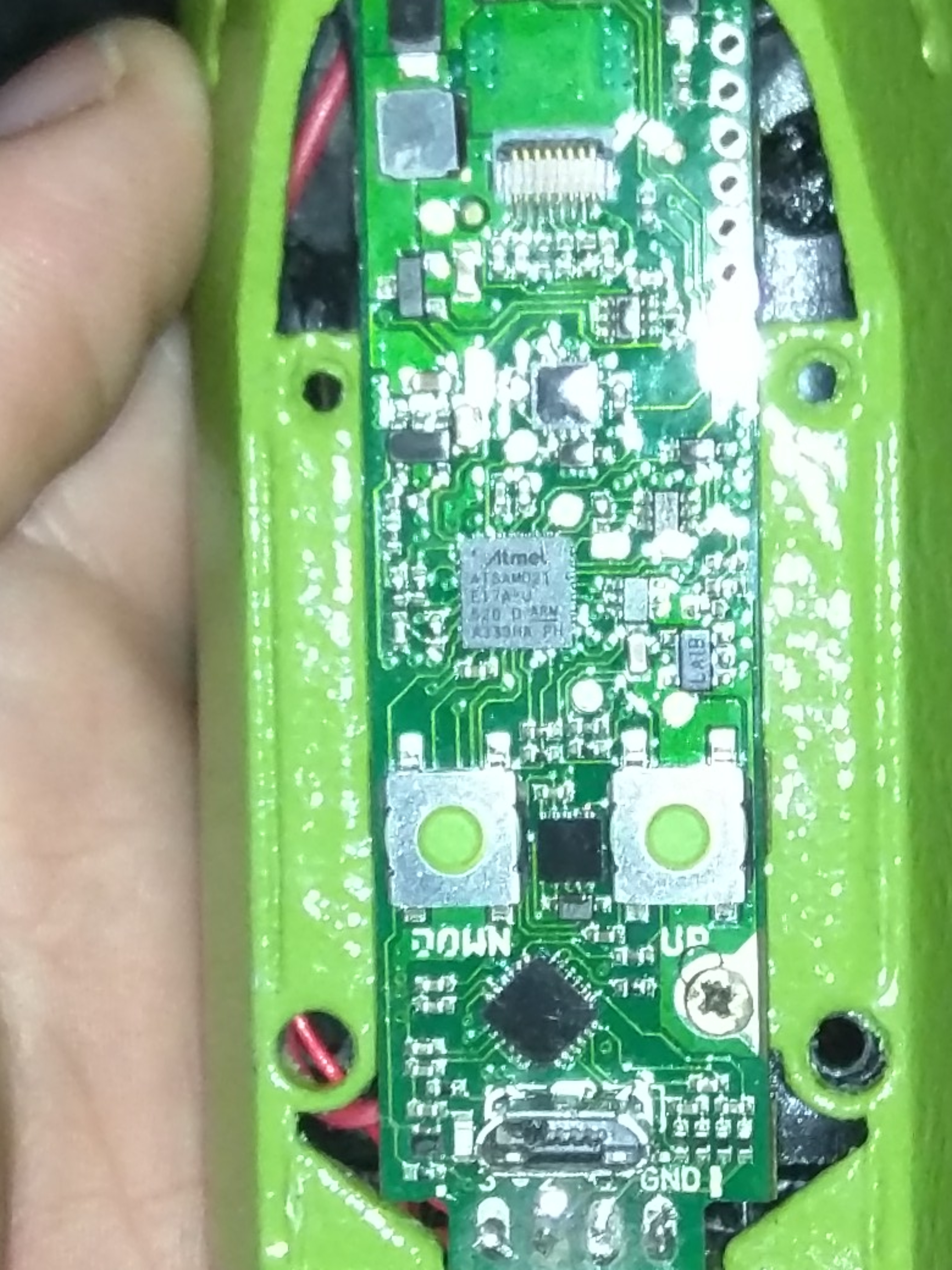

iandvaypes Posted August 2, 2015 Author Report Posted August 2, 2015 This was working fine until it suddenly went dead. I tried to connect to connect to escribe, nothing. Tried to force a firmware, nothing. Then I desoldered the battery and let the chip set for a while without power. Then I soldered the battery again and this is the weird part. The dna 200 will turn on and completely shut off after 5 seconds. The battery symbol isn't on the screen at all. All of the battery and balancing connections are solid. The pc still won't detect it. The weird part is that if I connect it to my high powered port, it will get very hot and smell like it's burning. The battery is still fine and my reader reads the correct voltage. If I hold the fire button, it will say check atomizer over and over again without turning off. If i press the power button once, it will turn off in 5 seconds. If I turn up the wattage, it will turn off and start back at 15 watts when turned back on. Plugging the usb in will light the screen up. Plugging it in without a battery will do nothing. This would be from one of the first batches and is obtained from the coop on ECF. Thanks
John Posted August 2, 2015 Report Posted August 2, 2015 No battery display means there is something wrong with the taps, resistors or the battery management ic. Similarly, it sees a battery error so it will shut down. Can we get an image of the board?
iandvaypes Posted August 2, 2015 Author Report Posted August 2, 2015 What are you looking for in the photos?
iandvaypes Posted August 2, 2015 Author Report Posted August 2, 2015 John said: No battery display means there is something wrong with the taps, resistors or the battery management ic. Similarly, it sees a battery error so it will shut down. Can we get an image of the board? Expand Do you need a close up of anything specific?
Brigrz81 Posted August 2, 2015 Report Posted August 2, 2015 Was just reading some of these issues on this Dna 200 forum and thought I would throw my issue in also just so its out there and known. Just received an opus 200 mod on July 31st, vaped it one night and woke up this morning took a hit and then board/mod went dead. Couldn't get anything from it, plugged inton escribe and not detecting it at all either. So not sure what happened, needless to say just have to return to opus for repair. Won't help now at this moment to anyone but once I find out what the issue was I will update. Been seeing a few issues lately so thought I would let people know my issue.
John Posted August 2, 2015 Report Posted August 2, 2015 Brigrz81, just totally nonresponsive? Not the popped fuse symptoms ( only turns on with USB connected) and not the screen issue ( board fires, screen isn't communicating) but dead is dead no response?

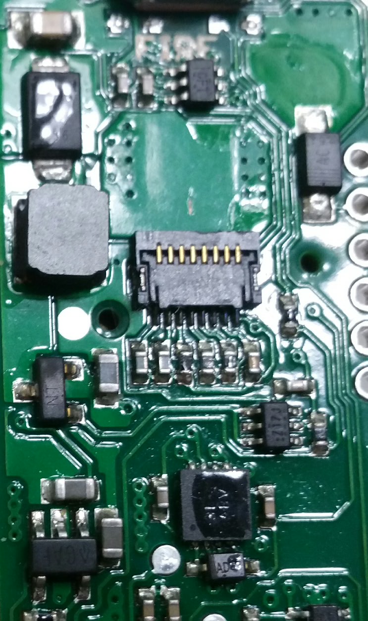

John Posted August 2, 2015 Report Posted August 2, 2015 Iandvaypes, can you get a closeup of the three legged component near the screen connector? That is the only thing that looks even a little wrong on yours. Pm me your address and I will cross ship you one Monday. You have a failure mode we haven't seen before exactly, so I would like to know what exactly it is doing. Thanks.
iandvaypes Posted August 2, 2015 Author Report Posted August 2, 2015 You have some really good eyes to see that one. That's why you're the genius. What does that little component do?
John Posted August 2, 2015 Report Posted August 2, 2015 Well, it is part of the charge circuitry. It ia 99% knowing where to look first based on the symptons. It looks a bit discolored, but I don't see any burning on it. Will see when we get it back. Is there anything unusual about the charger you typically use with this guy? We hadnt seen a lot of charger relates issues yet.
iandvaypes Posted August 3, 2015 Author Report Posted August 3, 2015 John said: Well, it is part of the charge circuitry. It ia 99% knowing where to look first based on the symptons. It looks a bit discolored, but I don't see any burning on it. Will see when we get it back. Is there anything unusual about the charger you typically use with this guy? We hadnt seen a lot of charger relates issues yet. Expand I use a normal 1 amp samsung phone charger. That cable worked great for escribe also. I also used my two laptop usb ports. The port with the lightning bolt symbol is the one that made it really hot and smell like it's burning. It started doing this after the chip went out. I do remember that it got very hot by that three port component and burned my finger.

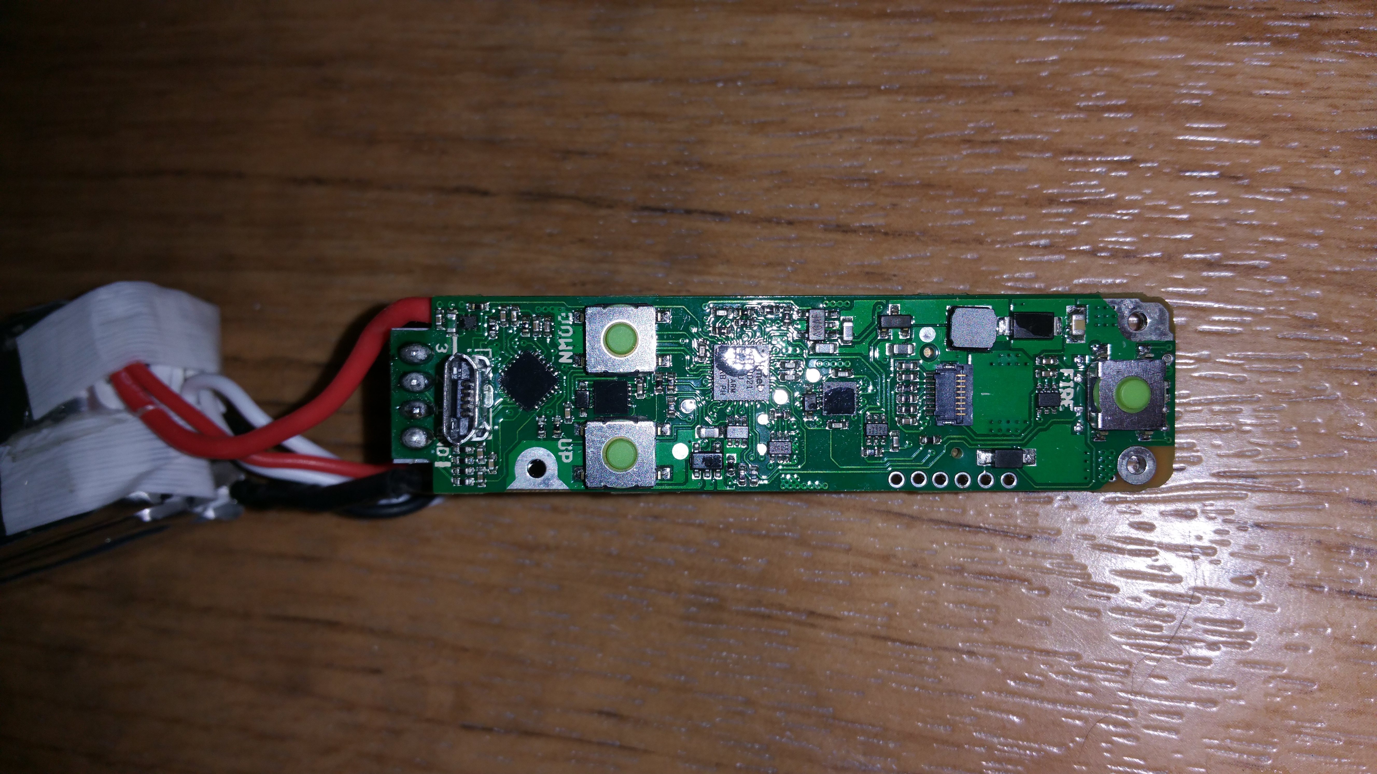

gorganzolia Posted April 6, 2016 Report Posted April 6, 2016 hello i got a dna200 chip from a Dyi mode kit someone bought me from NONAMé Box Mods but it was a dyi for a duel 18650 sled and i didn't want a 133 so i had a blown up rx200 mod and i have a dna200 wismec so i figured why not just use the case from the rx200 and the board so anyway i copied the wieing from that one in the rx and the screen came on but showed not battery witha a atty on if no atty it said check atty plus it would not stay on unless i held the fire button down soon as i let go it died. so i thought maybe i had to two wires in the front backward so i fliped then now it would stay on but still showed no battery and would say the same things so then looking around i found this https://drive.google.com/file/d/0B4koYNhAh1fLcUpVTUZCYlVXOUU/view so as hard as it was i copied that wiring still no battery shows and i had to ass so many wires to the rx200 mod i cold not property close it anymore anyway so now i am trying to decide if i should spend 70 bucks in parts getting a enclosure 510 chip sled and so on to make a lipo box mod or not. Problem is i dont know if the board is messed up or the wiring was just off or what i will send some pics too of the board..... it still wired in the mod atm so i cant get the back but i took a screw out and got to wear you could see the fuse and it has a bit of solder on it but i think the fuse looks ok correct me if i am wrong.... i dont know wh to do to be honest i am willing to buy all the stuff cus i want the mod to work but this should be a new chip oh and it does conect to ecribe but it wont do anything

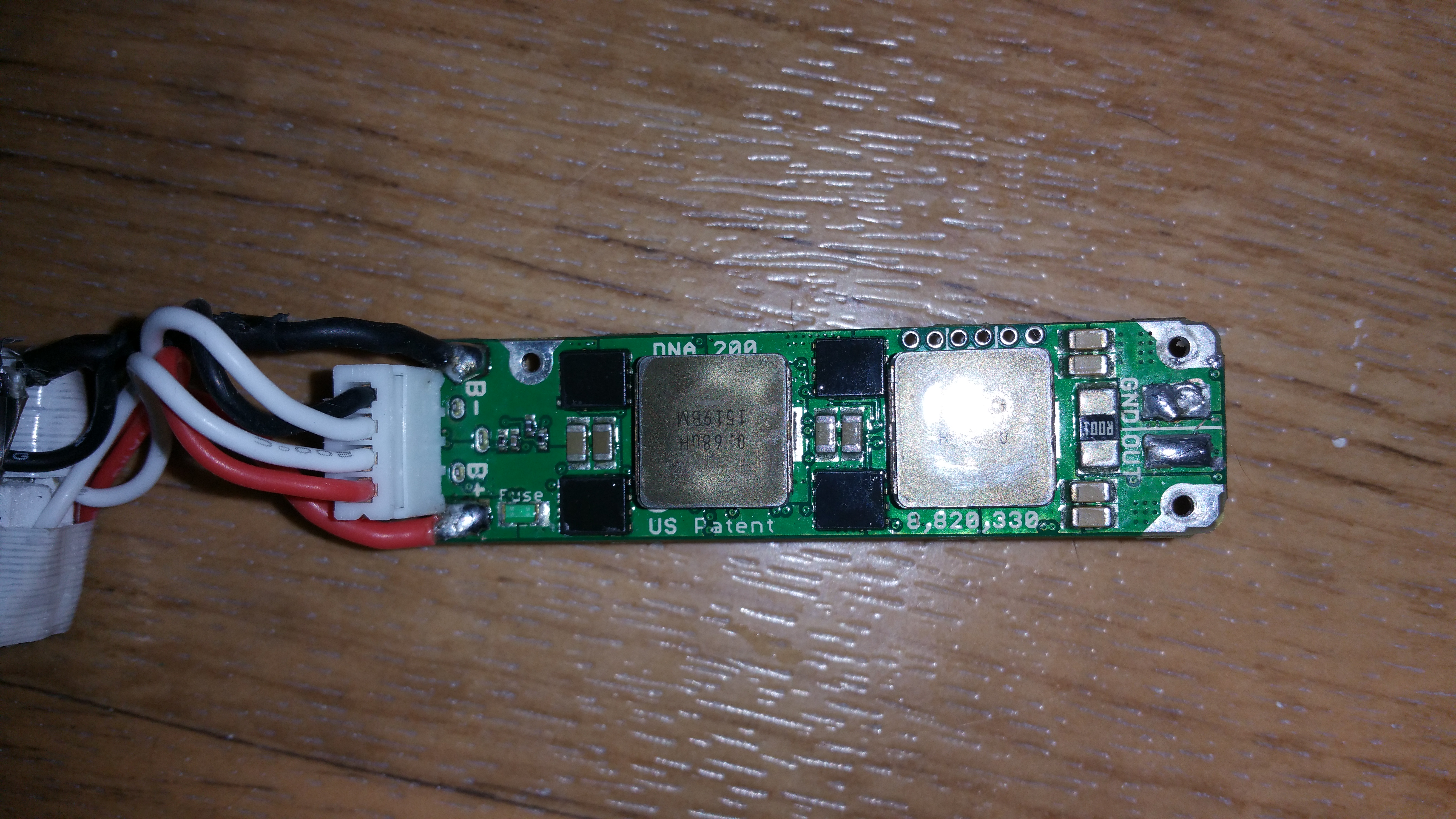

Lowbytes Posted April 7, 2016 Report Posted April 7, 2016 I am also having a problemWismec DNA 200 not bootingCell 1 is showing 0.01 Volt - all 3 Cells are charged external to 100%Checked all cabling inside of the wismec ---- replaced the horrible Cabling with better cables but problem resistsThink there is something blown - but looked to the whole board - no discoloration no smell of burned resistors or soConnected to USB with escribe it shows cell 1 0.01 Volt - disconect from USB pushing fire button screen shows Evolve Logo - no AtomizerAh i´ve forgotten to say - it´s fuse was blown once and someone replaced the fuse - but the DNA was working since yesterday it it suddenly went deadAny suggestions where to look at?It´s not that easy to find a Replacement board here in GermanyKind regardsMikel
gorganzolia Posted April 7, 2016 Report Posted April 7, 2016 it not a easy board to find any place they sell like they on fire nobody can keep them in stock
Lowbytes Posted April 8, 2016 Report Posted April 8, 2016 I´m sure that it is still under warranty but someone else (i´ve bought it as a defective device) replaced the fuse (sadly)Maybe evolve is interested in this kind of failure an offers me a replacement board - waiting for John to come along to this post ;-) If not i will kept the Housing / display / knobs and all the bits and peaces as Spare parts - 25Euro is not that much to cray about - but surely wouldbe nice to reanimate the beast ;-) I´ve thought that the horrible wismec wiring was the reason for the failure but it must be something on the board
