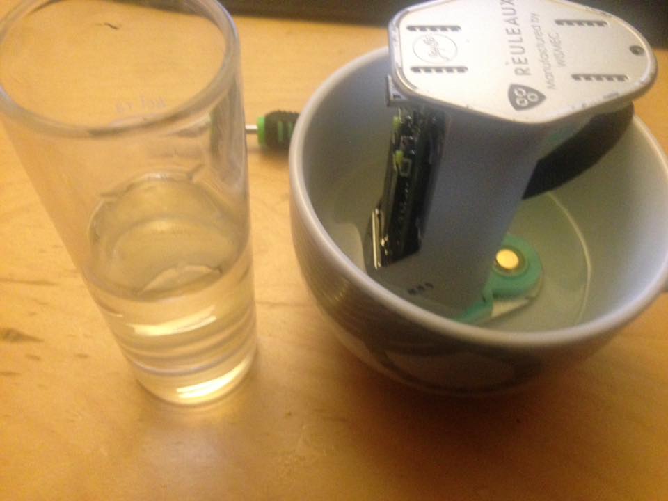

The ribbon cable is not on the way of the button. I already fixed this long ago. now, i opened it again, and cleaned with air spray, and other things.. the button is back to life, but for how long? I don't know how to open the front cover, to access the button. Do you know of any video or instruction to do it safely? I already ordered another reuleaux, this one is dying on me, and i love this mod. So i will get another one and this will be a guinea pig. The funny thing is my hanna modz V200 from August last year, is still alive and rocking, even if it is supposed not to be solid. but the battery life is just awful.

What kind of alcohol do you plan to use? Denatured alcohol would be a big no-no since it eats lots of things. I'm not crazy about rubbing alcohol because it contains lubricants and stuff. But many still use it anyway. Ethyl alcohol would be the best I would think. Not sure what is all in Vodka? But if nothing dangerous to plastics or leaves a film or anything, it might be ok.

i thought of using denatured alcohol that is used to clean wounding and so on..  that's all i have here.. well besides vodka, and other stuff of course.. but not sure that would be good either.. so basically i should do nothing at this point. so far it is still working after a few hours.. but i'd rather clean it properly, as this autofiring that happened without me noticing was a little scary
