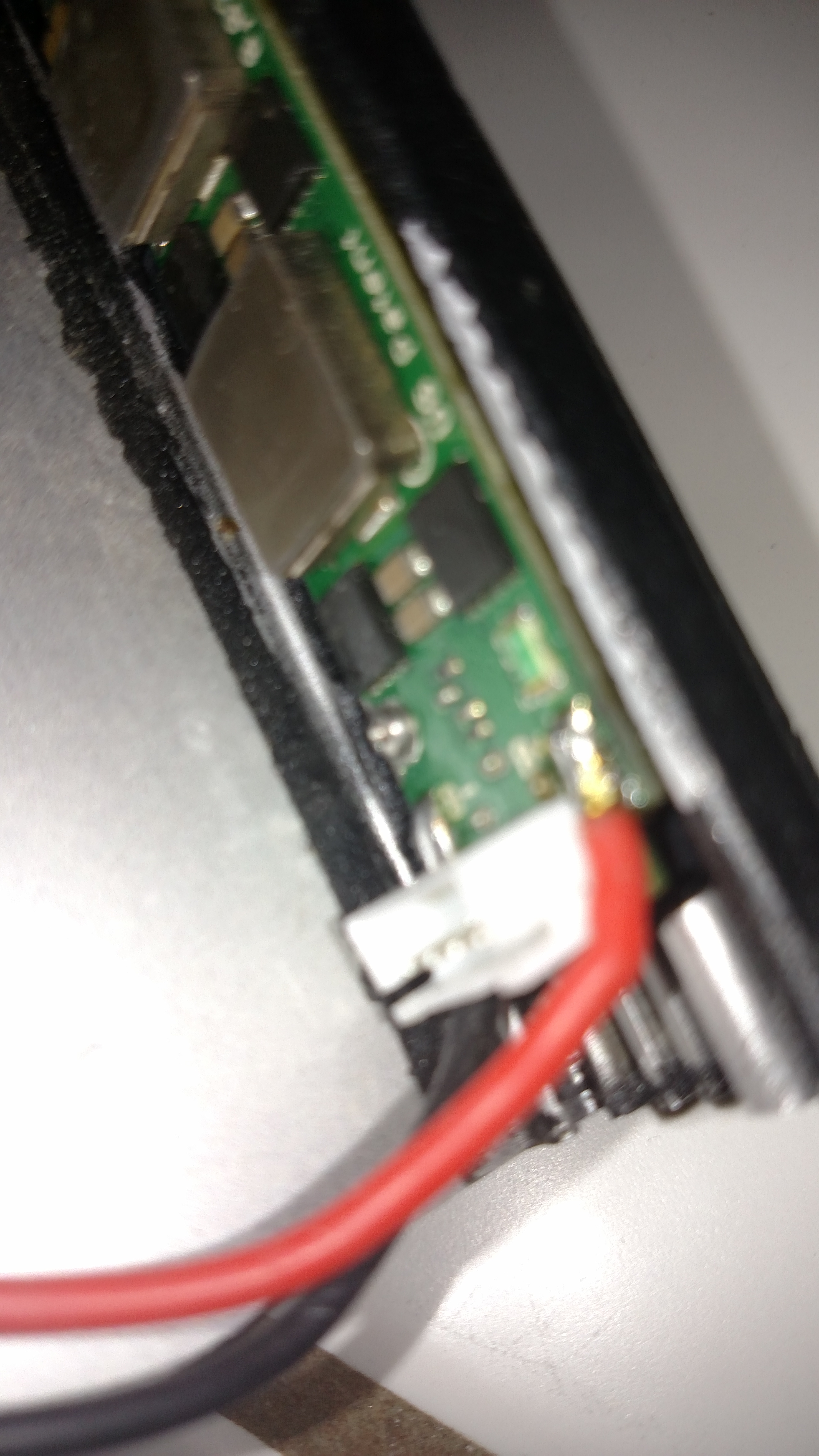

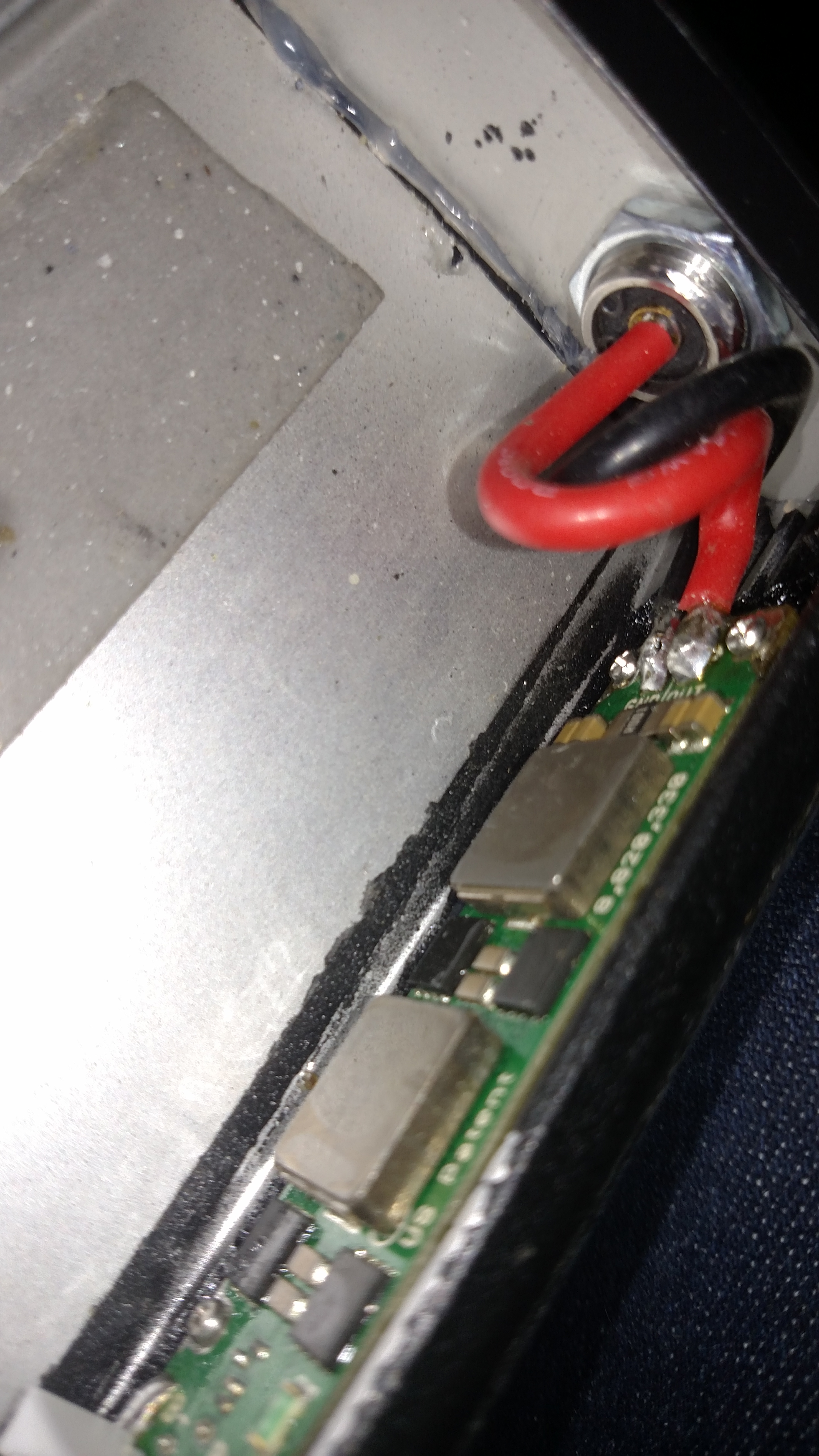

BillW50 Posted May 7, 2016 Report Share Posted May 7, 2016 Oh crap! Well it sure looks like it is draining the cells for sure. What kind of mod is this again? There is no juice or anything in there right? The wires doesn't have any insulation scraped off or anything, right? Maybe if you can take a photo or something of the insides? Link to comment Share on other sites More sharing options...
combatwombat Posted May 7, 2016 Author Report Share Posted May 7, 2016 No juice that i can see. I tried to take some photos but my phone wont focus. Ill check the insulation on the wires. I noticed when i plugged it into my lipo charger it had drained down to 2.03 from 2.11. Very strange because within 4 days cell 2 went from 2.8 to 0, which leads me to believe it is a bad battery. I made this mod so I cannot search for potential problems. Link to comment Share on other sites More sharing options...
