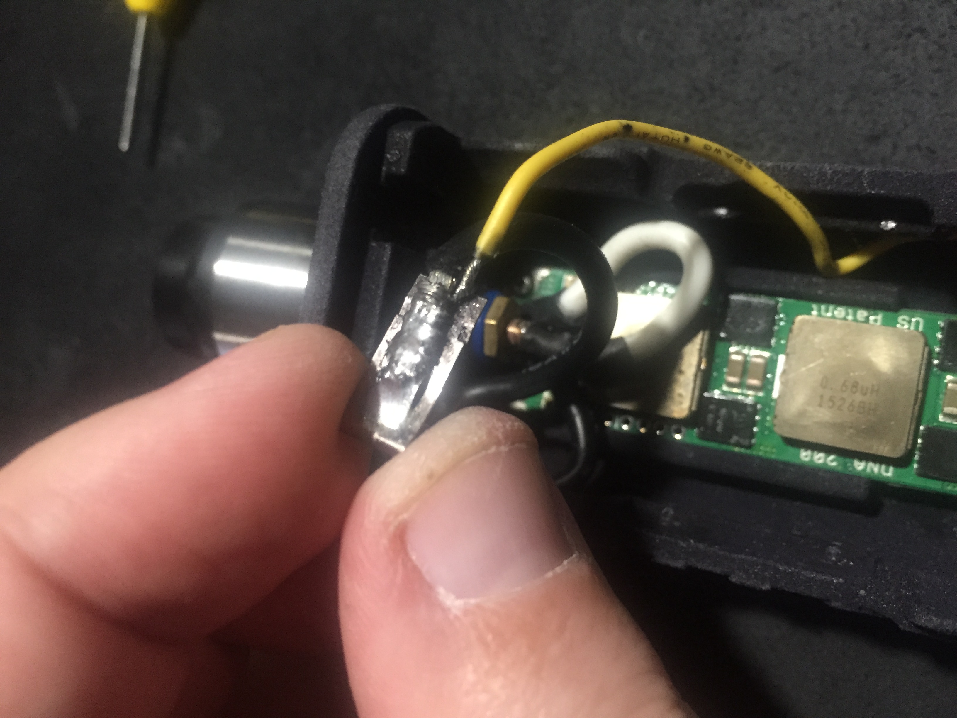

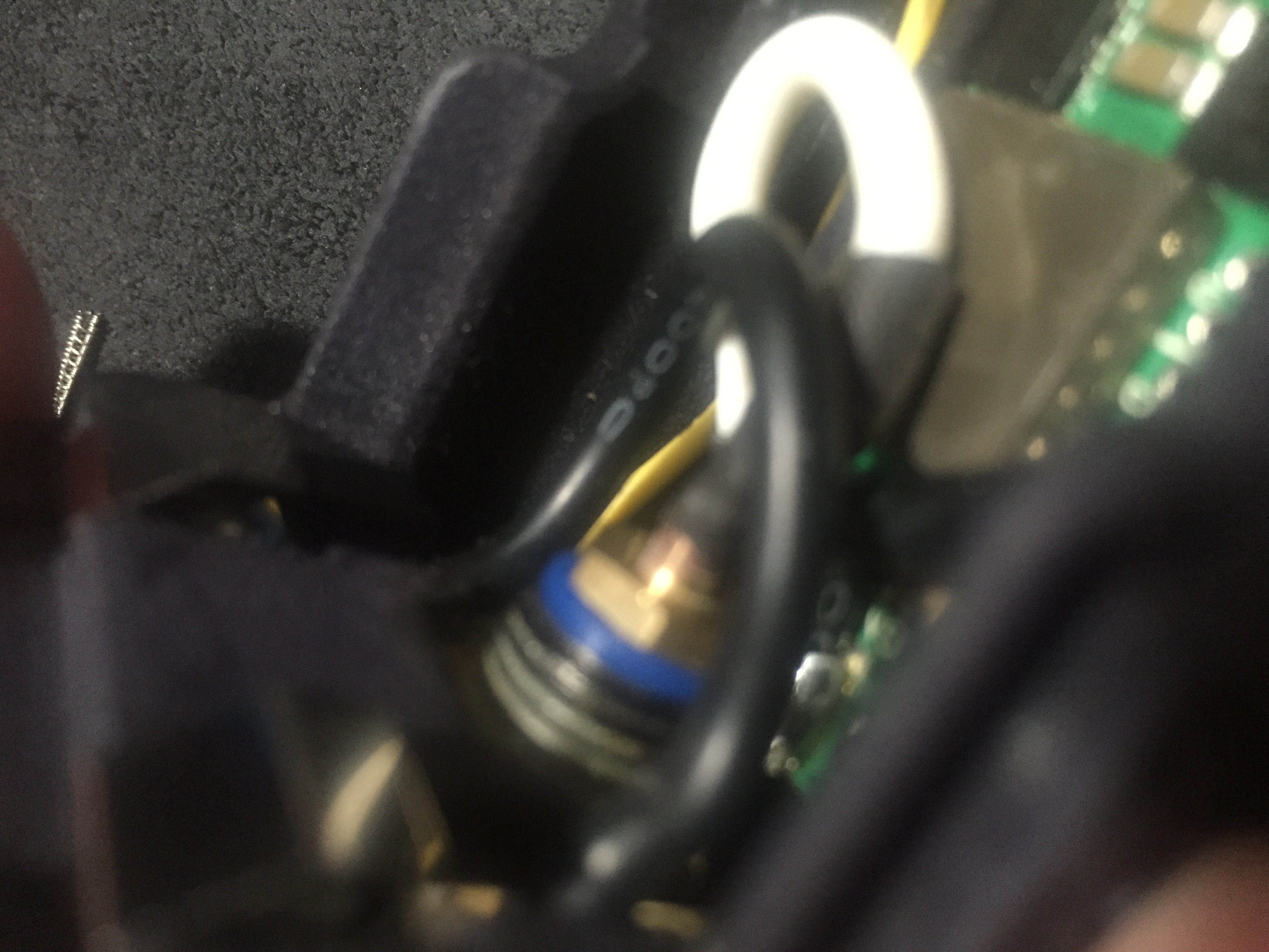

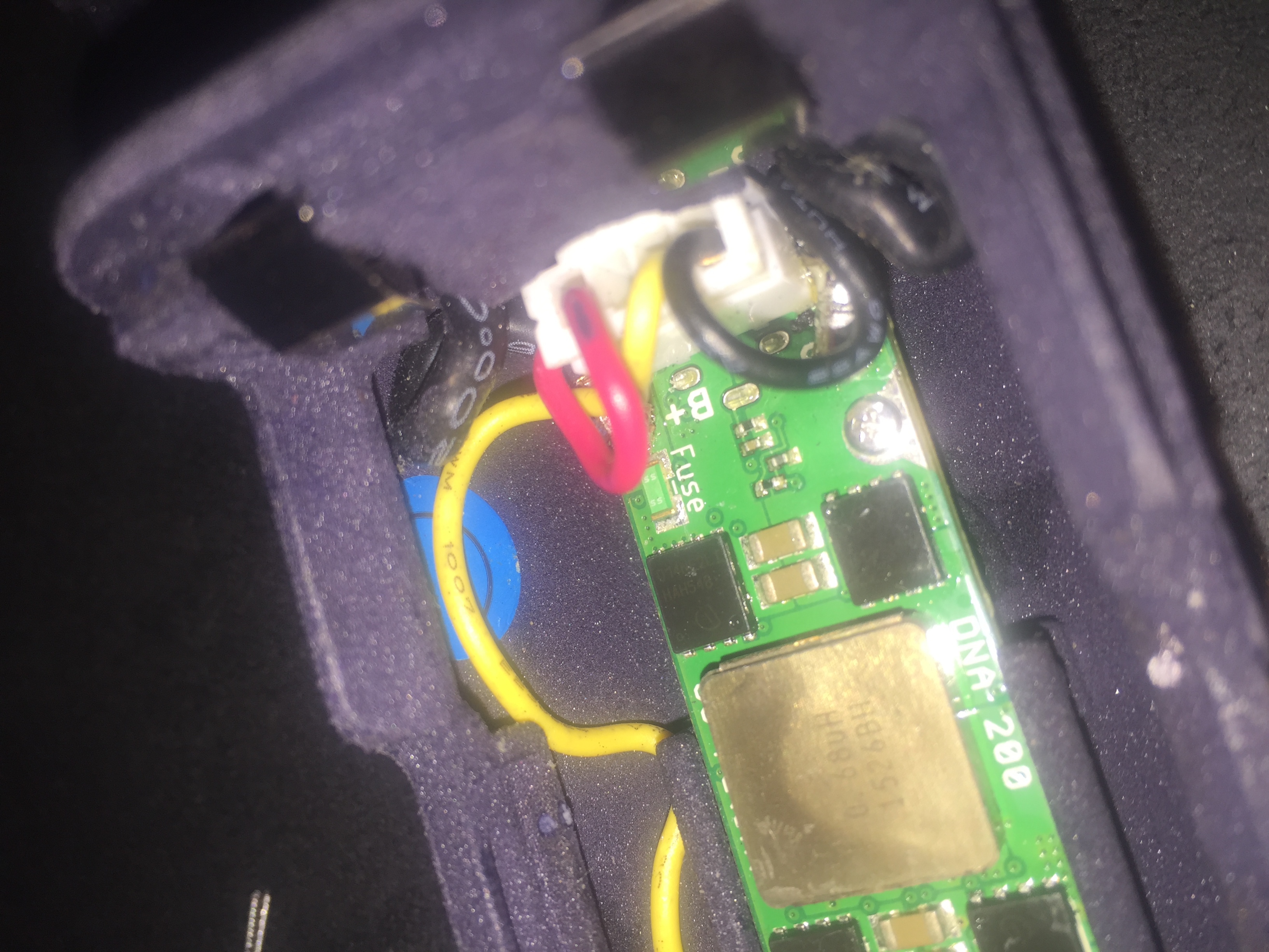

JaI Haze Posted May 6, 2016 Author Report Share Posted May 6, 2016 Ok so quick question. This sounds really weird and I dont know what would be causing this. I have a brand new dna installed from Ginger Vaper as my fuse went on my old one. The issue I am having now is it WORKS fine after it wakes up via usb. When it goes back to sleep it wont turn the mod back on until I wake it up with USB. What would cause this? Link to comment Share on other sites More sharing options...
