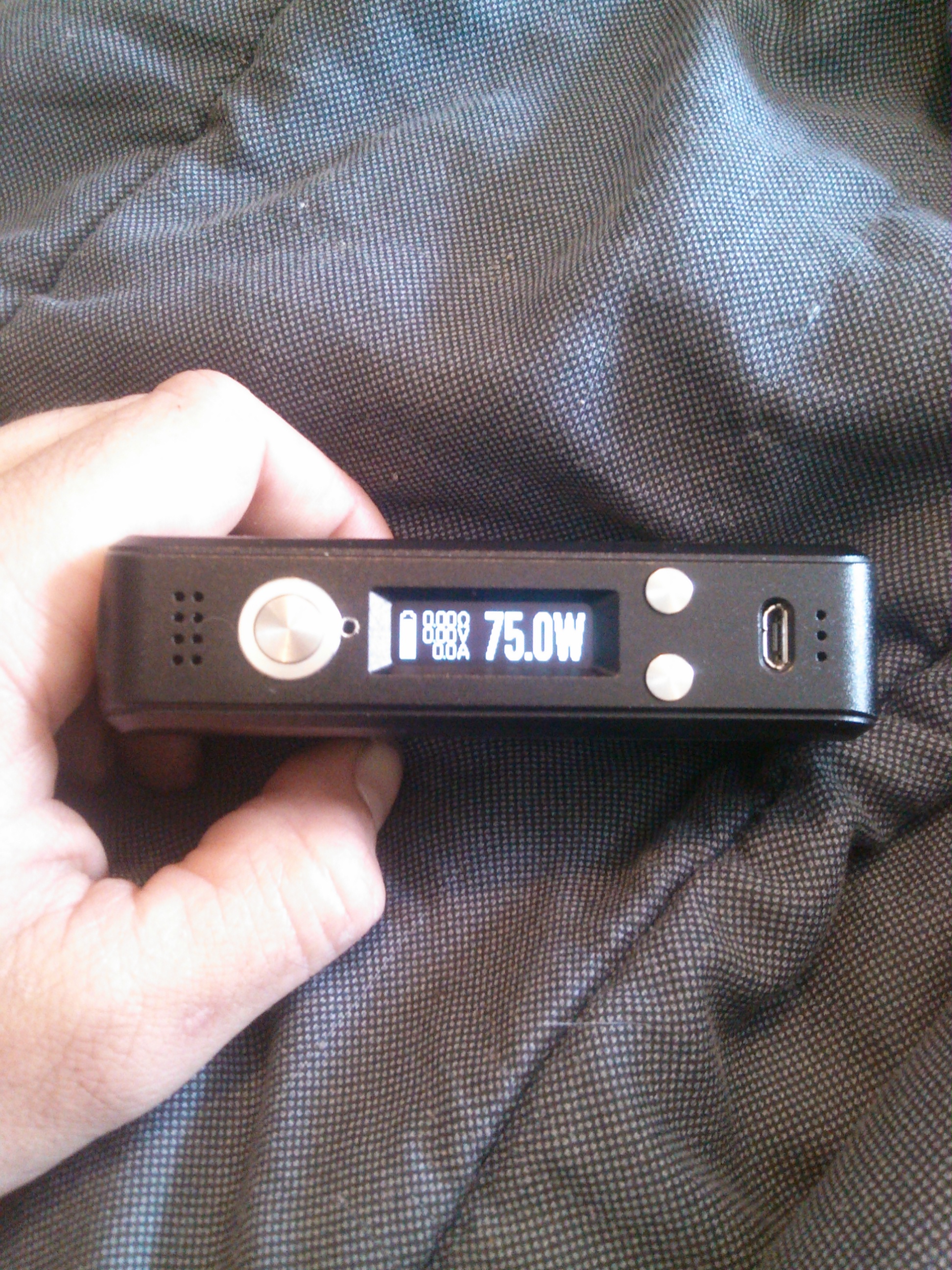

my dead VT200 has a new life now. put the 75 board in with some modifications. rewired the 3s hcigar lipo for 3p.  drilled a not so perfect hole for the LED. is this an ideal enclosure......no, but i have some 18650 75's on the way so this was just kind of a "why not" project.

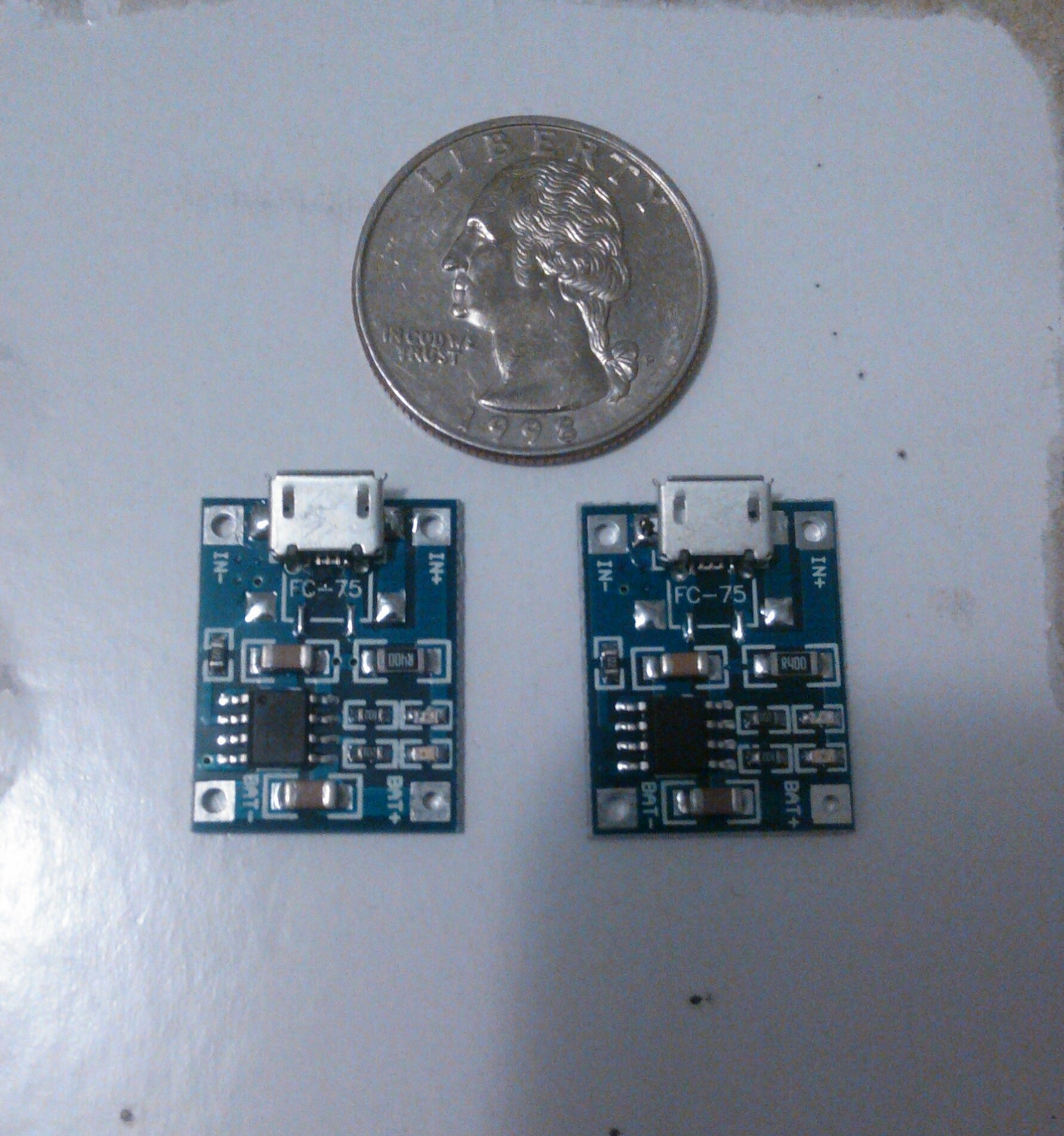

although, i do have some tiny 1 amp micro usb lithium battery charging board. there's room inside for them. maybe i'll put them inside somewhere.
you can stack these charging boards (parallel the outputs) to double the charge rate from 1 to 2 amps.
