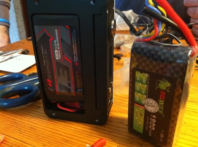

robby Posted October 23, 2015 Report Posted October 23, 2015 Received Turnigy nano-tech 1300mah today and fitted, it`s a bit longer than the original Lion Power (supposed to be 1800mah , but a better fit widthways than the original (not as tight), Charged up and vaping. Wii let you know when I have to recharge.
robby Posted October 24, 2015 Report Posted October 24, 2015 A big improvement in the battery performance from fitting the Turnigy Nano-Tech 1300mah Lipo. From just under a days vaping to just under a day and a half. This from a battery rated at 1300mah replacing a Lion Power 1800mah battery. Either Lion Power or Vapecige or both pulling a fast one. I am only up to first recharge on the battery so hoping it will improve more after 5 or 6 cycles.

dwcraig1 Posted November 3, 2015 Report Posted November 3, 2015 I just finished putting the above Turnigy 1300 mah Lipo in my Vapecige box. I used a Deans connector but considered just cutting the plugs off and soldering the wires together. I did shorten the two big wires on the battery as there is very little space. If I were to do it over I think I would have just soldered the wire together where the plugs are, I wanted to avoid soldering on the board if possible. The wires from the battery are exiting the battery on the opposite side of the case from the board. It was successful, charging now.

dwcraig1 Posted June 3, 2016 Report Posted June 3, 2016 This is the one that I put into VTbox200:Turnigy nano-tech 1300mah 3S 25~50C Lipo Pack (AR Warehouse)The XT60 has to be changed to T plug and the power wires shortened. The battery is just slightly longer than the original.
