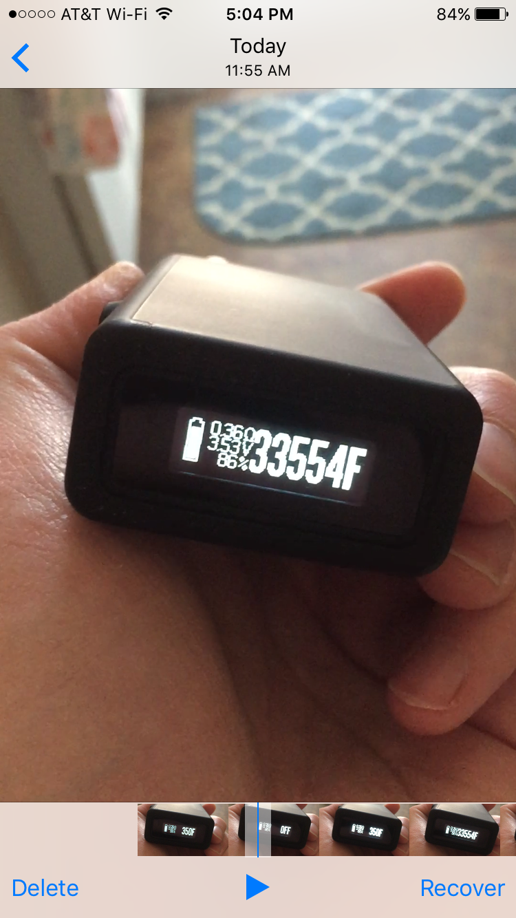

smashyrhead Posted May 19, 2016 Author Report Posted May 19, 2016 Have had this issue the past few weeks on my Vaporshark. No temp builds or premade temp coils work. Using correct TCR csv files, different materials, tanks, drippers you name it.. Temp always fires in straight power mode or the screen will glitch and display 33000+ degrees or it will be set at say, 450 degrees and go up to 800 on the screen. Seems this started happening after the 2/29 firmware update got pushed through escribe. Has anyone seen this before? Mod is just out of warranty with VS.

Nick Posted May 19, 2016 Report Posted May 19, 2016 A TCR curve is just that, a curve. The board performs the calculation based on resistance, and displays the temperature. For your device to display that high of a temperature something triggered a massive resistance spike while firing.

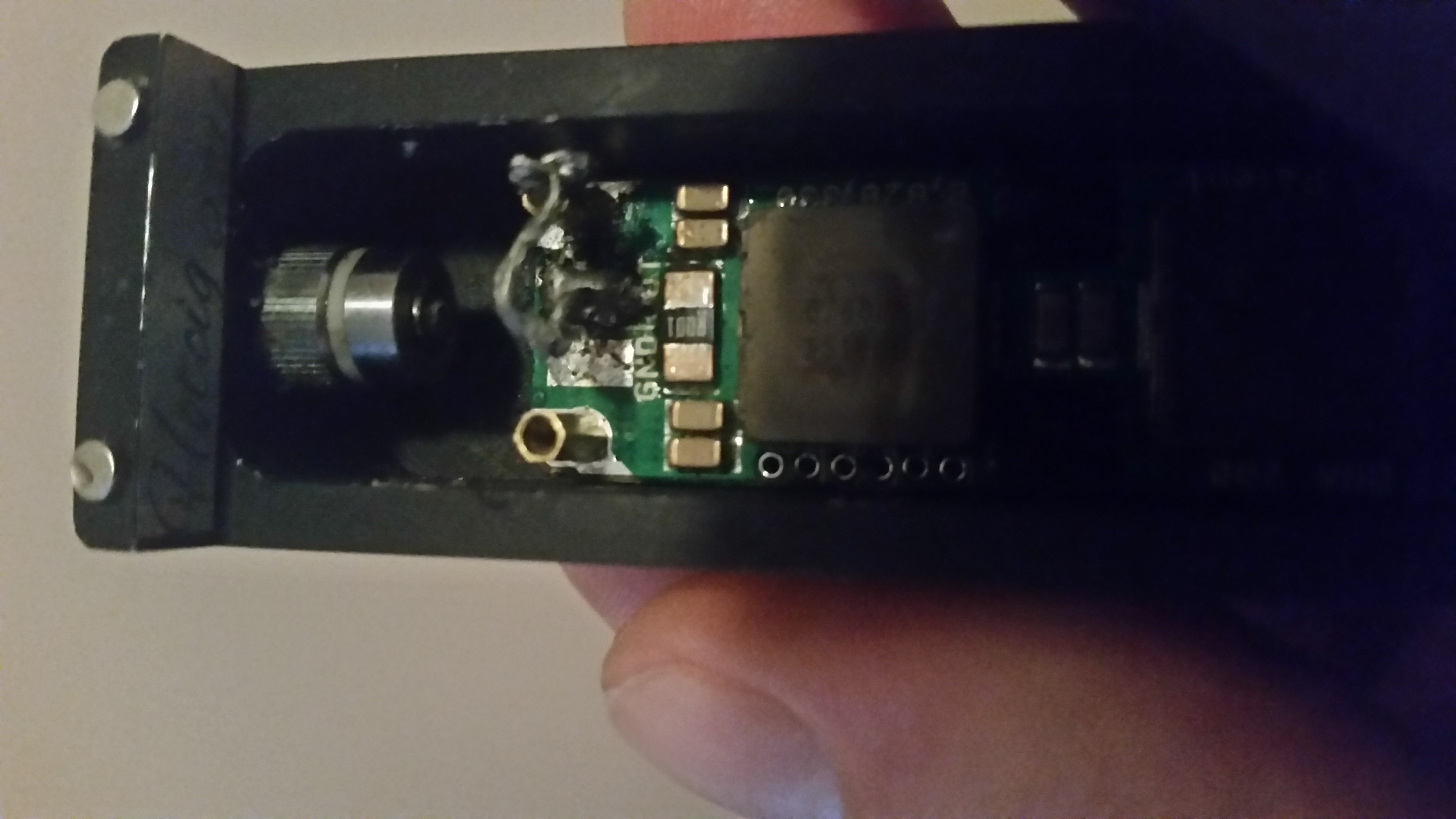

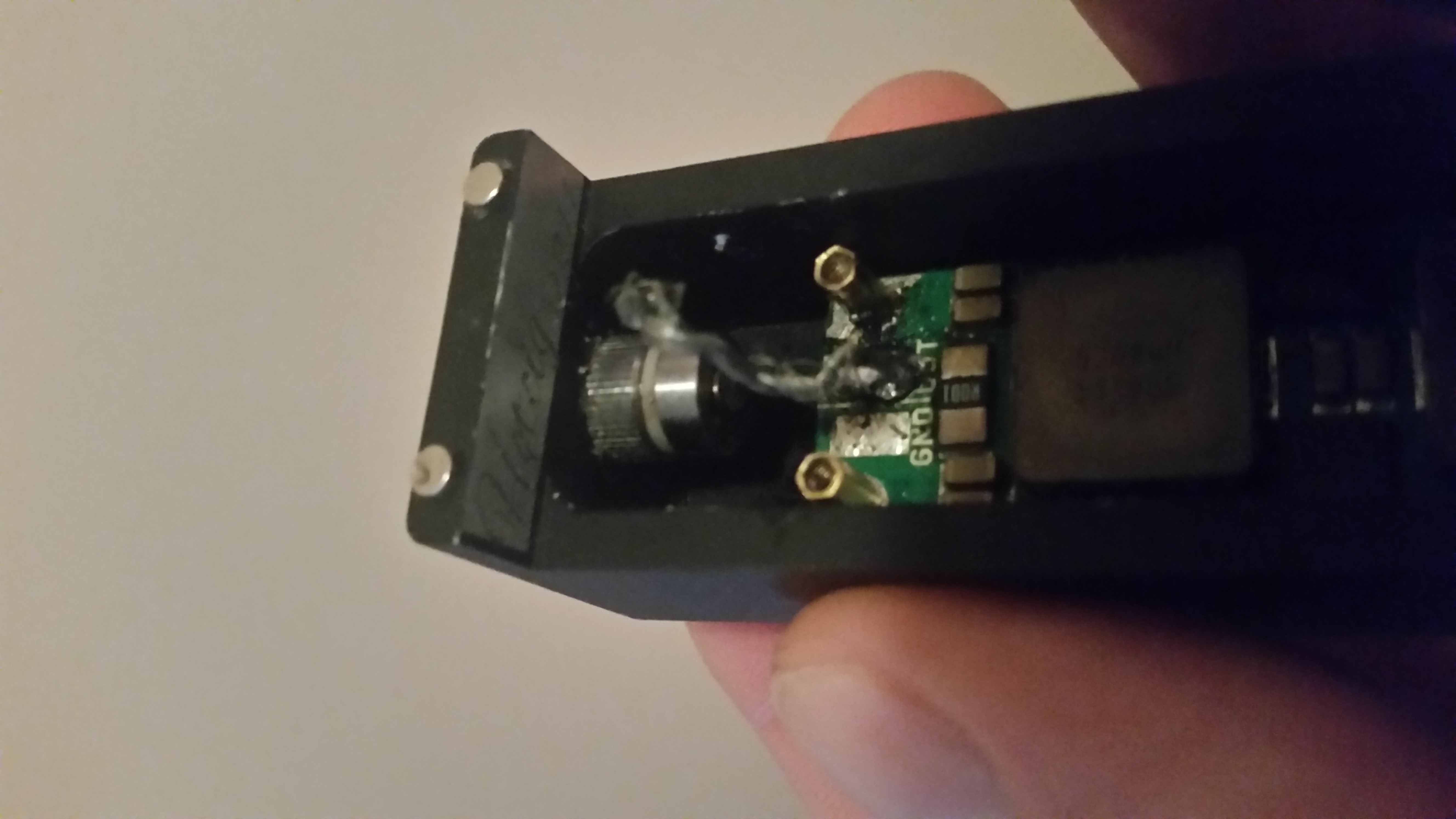

TechnoGeek Posted May 24, 2016 Report Posted May 24, 2016 I had the EXACT same issue with a HotCig DX200 I purchased used.It worked fine for about 2-3 weeks, and then TC was not stable, eventually started displaying bizarre temperatures like you're seeing, and bounce out of TC.Turns out the person I bought it from had an issue when HE first bought it new from Gearbest.com. So, he returned it to them, and they fixed it.....It was the WORST repair job I have ever seen! They used BARE wire, without insulation, it was two thinner pieces of wire soldered together to make one thicker piece, and the frayed end that was attached to the 510 connector was BARELY attached by SOME of the frayed ends. When I used a small screwdriver to move some of the frayed wire out of the way to get a better view of the connection to the 510, the wire just came completely off! I'm shocked/surprised it ever worked! Since the 510 on the HotCig DX200 was a press fit, I had to make a small tool to I made pull the 510 out, and replace it. I used a Varitube to replace it, and some 14 gauge silicone wire. The hardest part was getting the nut inside the case tight, and lined up so the back cover of the module containing the DNA200 board could be put back on without interfering with the cover being installed.The person I bought it from was great, offered to pay to have it repaired, or pay me for the cost of the parts to repair it after he saw the pictures of the Gearbest.com repair job...... I learned a valuable lesson, NEVER buy anything from Gearbest.com that you may have to send back to them which they may choose to repair!
Spector NS5 RD Posted May 24, 2016 Report Posted May 24, 2016 TechnoGeek said: I had the EXACT same issue with a HotCig DX200 I purchased used.It worked fine for about 2-3 weeks, and then TC was not stable, eventually started displaying bizarre temperatures like you're seeing, and bounce out of TC.Turns out the person I bought it from had an issue when HE first bought it new from Gearbest.com. So, he returned it to them, and they fixed it.....It was the WORST repair job I have ever seen! They used BARE wire, without insulation, it was two thinner pieces of wire soldered together to make one thicker piece, and the frayed end that was attached to the 510 connector was BARELY attached by SOME of the frayed ends. When I used a small screwdriver to move some of the frayed wire out of the way to get a better view of the connection to the 510, the wire just came completely off! I'm shocked/surprised it ever worked! Since the 510 on the HotCig DX200 was a press fit, I had to make a small tool to I made pull the 510 out, and replace it. I used a Varitube to replace it, and some 14 gauge silicone wire. The hardest part was getting the nut inside the case tight, and lined up so the back cover of the module containing the DNA200 board could be put back on without interfering with the cover being installed.The person I bought it from was great, offered to pay to have it repaired, or pay me for the cost of the parts to repair it after he saw the pictures of the Gearbest.com repair job...... I learned a valuable lesson, NEVER buy anything from Gearbest.com that you may have to send back to them which they may choose to repair! Expand wow, whatever that is, it's just plain horrible. worst repair i've seen yet on a dna 200 board. bare wire, bad soldering...........etc. glad to hear you have skills to repair it.

black lace Posted June 6, 2016 Report Posted June 6, 2016 I would put my money on the 510 on the mod has collapsed and the power out wire (soldered to center pin) is ratling around, fitting the aspire atty may have a slightly longer reach, so kind of works better, becsuse of a slightly firmer hold, you could ask at a vape shop if they can fit a new 510 or at least recomend someone..
