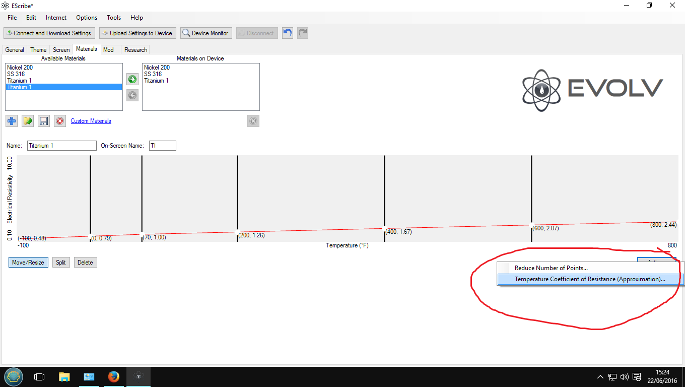

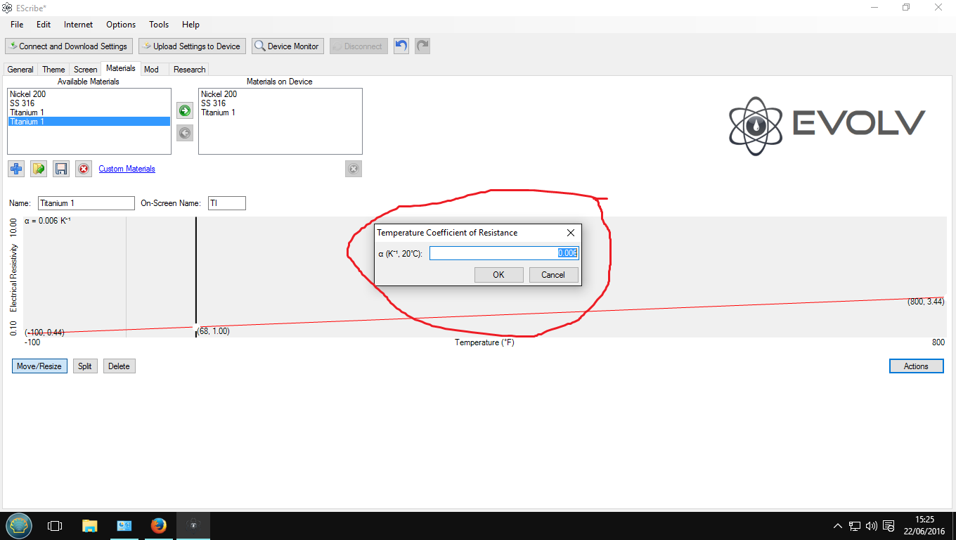

Tsavo213 Posted June 22, 2016 Author Report Share Posted June 22, 2016 I found one on Djlsbvapes profile I am new to escribe still and haven't mastered divide lines. I also see a lot of people debating a ss fix of 0.00091 If anyone knows where I can find just a really solid basic profile with correct tcr valyes Id be very grateful. Link to comment Share on other sites More sharing options...

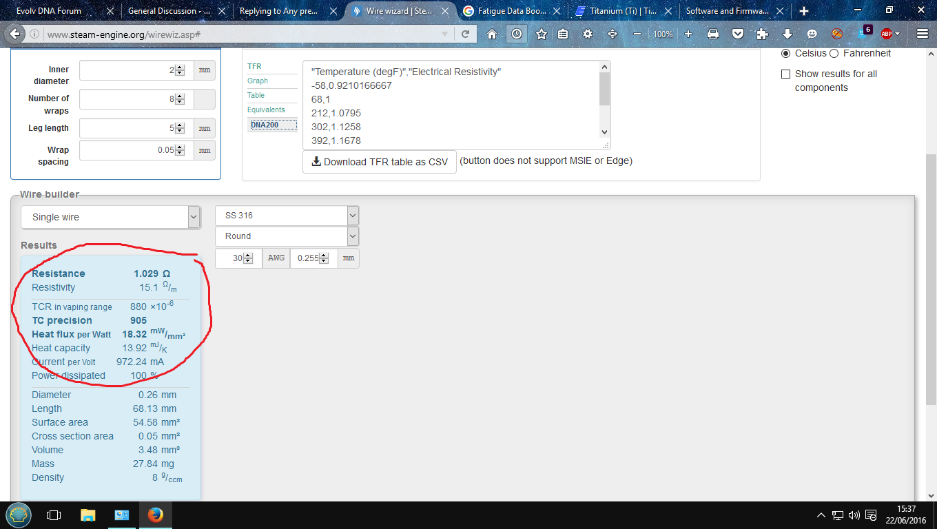

SteveF Posted June 22, 2016 Report Share Posted June 22, 2016 Try steam engine for profiles, if you don't get on with those you can enter the TCR rather than a whole curve. SS can be a difficult material to set up, very spiky either works well without preheat or with lots of preheat. Best to fine tune the power delivery so that it runs just under the temp limit. the various grades 304/316/316L ect vary from source to source, its a more complex alloy unlike GR1 titanium with a purity of 99.6? or Ni200 at 99.8316 as chemically defined has a TCR of 880 but thats not to say 316 from source A is the same as 316 from source B. But they both meet the standards for 316 on composition. Link to comment Share on other sites More sharing options...

damanaries777 Posted June 22, 2016 Report Share Posted June 22, 2016 Try all three of these for ss316L. Go with which ever works best for u. 0.00092, 0.00093, 0.00094. On my dna devices 0.00092 works the best. On my h-priv I use 0.00094. On my sigeli 213 I use 0.00093. And, once again that tcr is for ss316L. Ss316L has a tcr of 0.00092. Also, your ohms absolutely must be correct. If your ohms are off (even a little) you'll get a weak pull and little vapor. That's even with the correct tcr. So, if your not getting any vapor adjust your ohms first. When your ohms are right and it's working. Lock your ohms. And enjoy Link to comment Share on other sites More sharing options...
Tsavo213 Posted June 22, 2016 Author Report Share Posted June 22, 2016 SteveF said: Try steam engine for profiles, if you don't get on with those you can enter the TCR rather than a whole curve. SS can be a difficult material to set up, very spiky either works well without preheat or with lots of preheat. Best to fine tune the power delivery so that it runs just under the temp limit. the various grades 304/316/316L ect vary from source to source, its a more complex alloy unlike GR1 titanium with a purity of 99.6? or Ni200 at 99.8316 as chemically defined has a TCR of 880 but thats not to say 316 from source A is the same as 316 from source B. But they both meet the standards for 316 on composition. Expand Hey my thing is how do I know my coils inner diameter etc etc w a ss clapton. Bust out the caliplers? Link to comment Share on other sites More sharing options...
dwcraig1 Posted June 22, 2016 Report Share Posted June 22, 2016 Have a set of rods, drill bits, Allen keys ect. of known sizes or get out the calipers and size the rods.But you don't need to put in that info to get TCR/TFR as that doesn't change with size or ohms, it only changes with different material Link to comment Share on other sites More sharing options...
