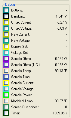

BillW50 Posted June 27, 2016 Report Posted June 27, 2016 Found it! And it was Brandon. Brandon said: attach the mod to the PC->Go to EScribe->click Help->About->Click the Evolv logo 7 times->open Device Monitor->on the left side of the screen next to Screen Disconnects, what does it say? Expand https://forum.evolvapor.com/topic/68104-topic/?do=findComment&comment=912674
BillW50 Posted June 27, 2016 Report Posted June 27, 2016 Here is the extra debug information you get.
