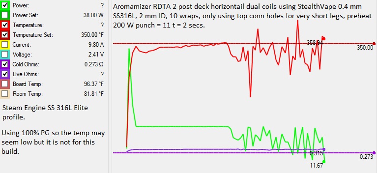

Guest Posted June 19, 2016 Report Posted June 19, 2016 Opus DNA 200 I have been using titanium since I first got my opus and been very happy I decided to try 316ss 3 builds no space glow light .space glow light space no glow . Bellow v3 24 GA 316 lighting vape wire 2.5 center 0.11 build pre heat 50 /120 punch med 1 second temperature 330 /480 .no flat line at all 2.5 second puff will get 200 degree swing once. then smaller swings up and down it's not going over the set temperature to bad but dropping I use the wire cv that I got with e scribe and tried smoke Calc cv what am I missing the same atty titanium build really nice flat line and vapor please need input thanks
VapingBad Posted June 19, 2016 Report Posted June 19, 2016 Until the 200 get the update to improve ss I find the best approach is to use preheat to get to temp and set the wattage to maintain the temp just below the limit.This show that for the first half of the vape, then I let it go above the limit to show the difference. When the update comes you will get a smooth line like the DNA 75 with ss.
Guest Posted June 19, 2016 Report Posted June 19, 2016 Thank you so much Vapingbad I was lost I had helped someone with a DNA 75 and it was a excellent Flatline I didn't realize the DNA 200 might be behind it I am sure it will not be too long before that is changed the titanium has me pretty spoiled so no problem waiting on up Date give me something to look forward too thank you again
meloserj Posted June 21, 2016 Report Posted June 21, 2016 This is exactly what I am getting! OMG, I was thinking I am the stupid one who doesn't understand ohm laws !Thanks a lot to share this photo and I will wait for update of DNA200

BillW50 Posted June 30, 2016 Report Posted June 30, 2016 Jentz9517 said: .24 ohms and then if I use titanium its fine???? Courtesy of VapingBadLooks good to me.
