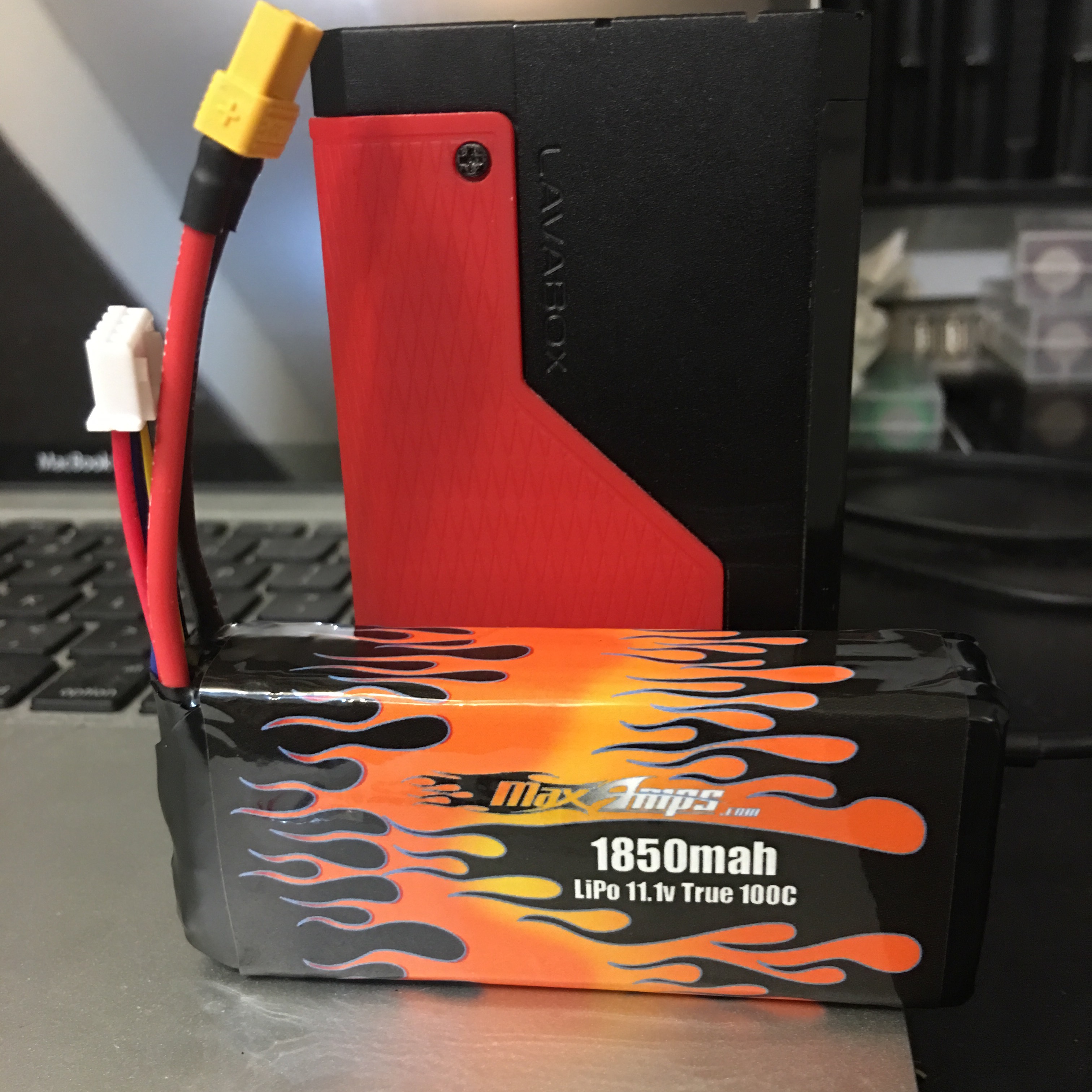

Anyone knows how do i replace the connector on the battery?
Just bought one here for my Lavabox but it doesn't comes with a connector. I'm still staring at those batteries wondering how. Please advice guys... P_20160202_202725.jpg

De-solder and resolder the connector from the old battery or get a new connector, I think the connectors are XT30 about 6mm by 11 mm, if they are bigger they are XT60.  Be very careful to only work on one wire at a time including cutting the wires and insulate with heat shrink (the stuff with adhesive inside is best) before working on the other wire, never have both wires exposed at the same time.   They are easier to solder if you have a spare for the other side of the plug not connected to act as a heat sink.

From the way you are asking, I don't think you will like the answer:- Cut off the old connector, cut off the black heat shrink wrapping, desolder the old wire from the plug, put heat shrink over new wires, cut new wires to length (one at a time!) Strip insulation from new wires and solder to old plug, slide heat shrink up and heat till formed. And you are done! Or you can get a new connector and solder that on.

Any electronics or radio repair shop could do it, but they don't ship with a connector as there is no standard connector and the Evolv Reference Mod doesn't use a connector at all.  The XT30 isn't even standard in the world of RC it is a smaller version of the XT60 that HobbyKing devised and I am not sure that anyone else produces them, you can find them on eBay and from some mod parts stores.
