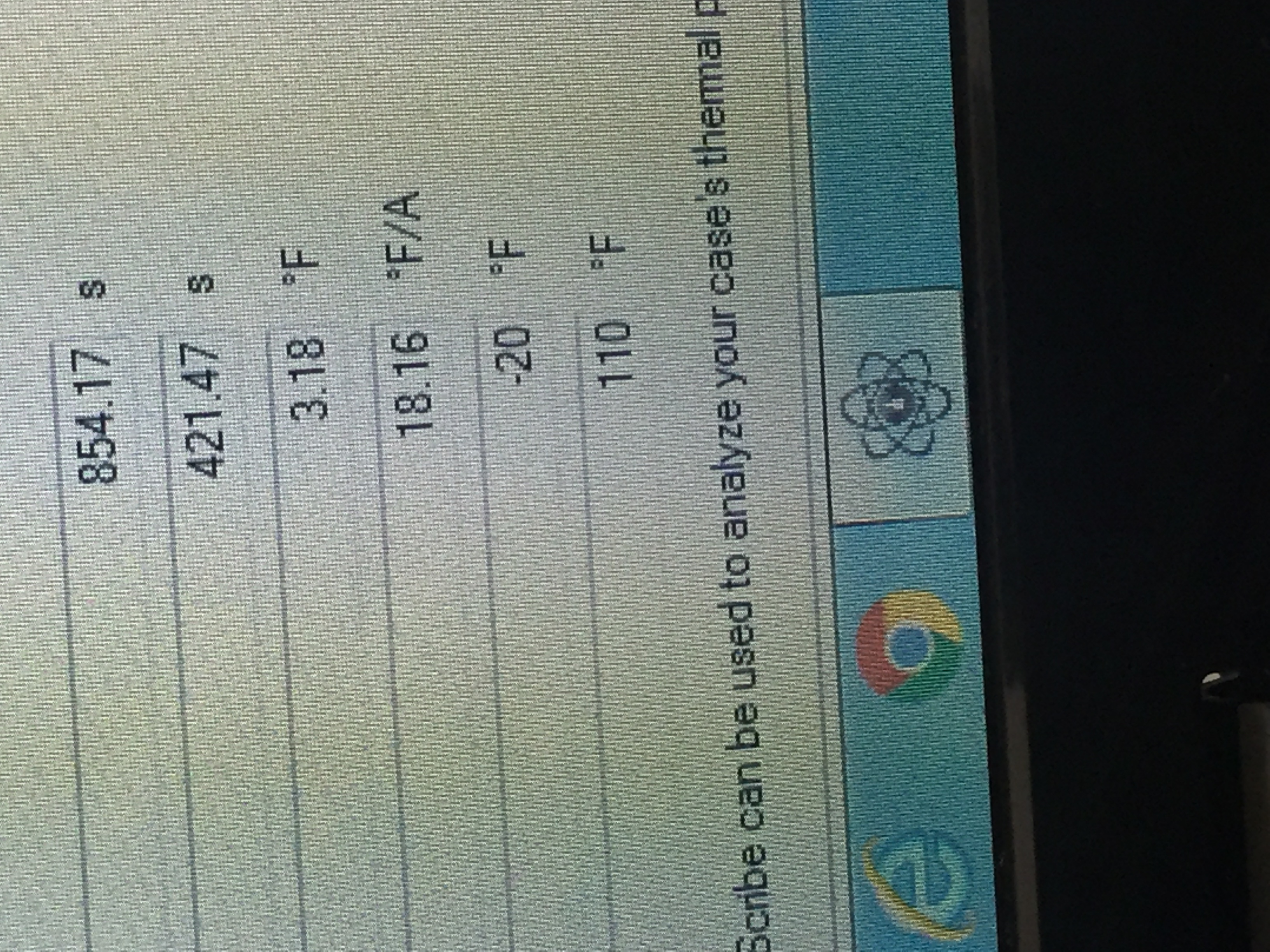

Jentz9517 Posted July 2, 2016 Report Posted July 2, 2016 as for the wire profile pre sets they are innacurate theres an ecig file somewhere with case analyzer results.. i am using them but going to run my own though.
Chris1112 Posted July 3, 2016 Author Report Posted July 3, 2016 So I guess my internal resistance a straight, so you think I should try to do case analyzer maybe, I need a real stable environment though rite.
Jentz9517 Posted July 6, 2016 Report Posted July 6, 2016 Chris1112 said: So I guess my internal resistance a straight, so you think I should try to do case analyzer maybe, I need a real stable environment though rite. Expand Sorry late response yes you would need it to be pretty consistent . I am just using the ones listed

Jentz9517 Posted July 7, 2016 Report Posted July 7, 2016 Duo Escribe settings mod res, case analyzer profile presets from ecigdo.com https://drive.google.com/file/d/0B0iI0nMz_7c4MTBZc2c5bVNmTXM/view The second link is the 1300 Mah Lipo settings https://drive.google.com/file/d/0B0iI0nMz_7c4ZXJJLUROaE5Xdlk/view?usp=sharing
Jentz9517 Posted July 7, 2016 Report Posted July 7, 2016 I am happy with 0.006 I doubt they used 90% of the value since they probably used a solid copper tap.. I am having good results with the curves I made YT.csv
