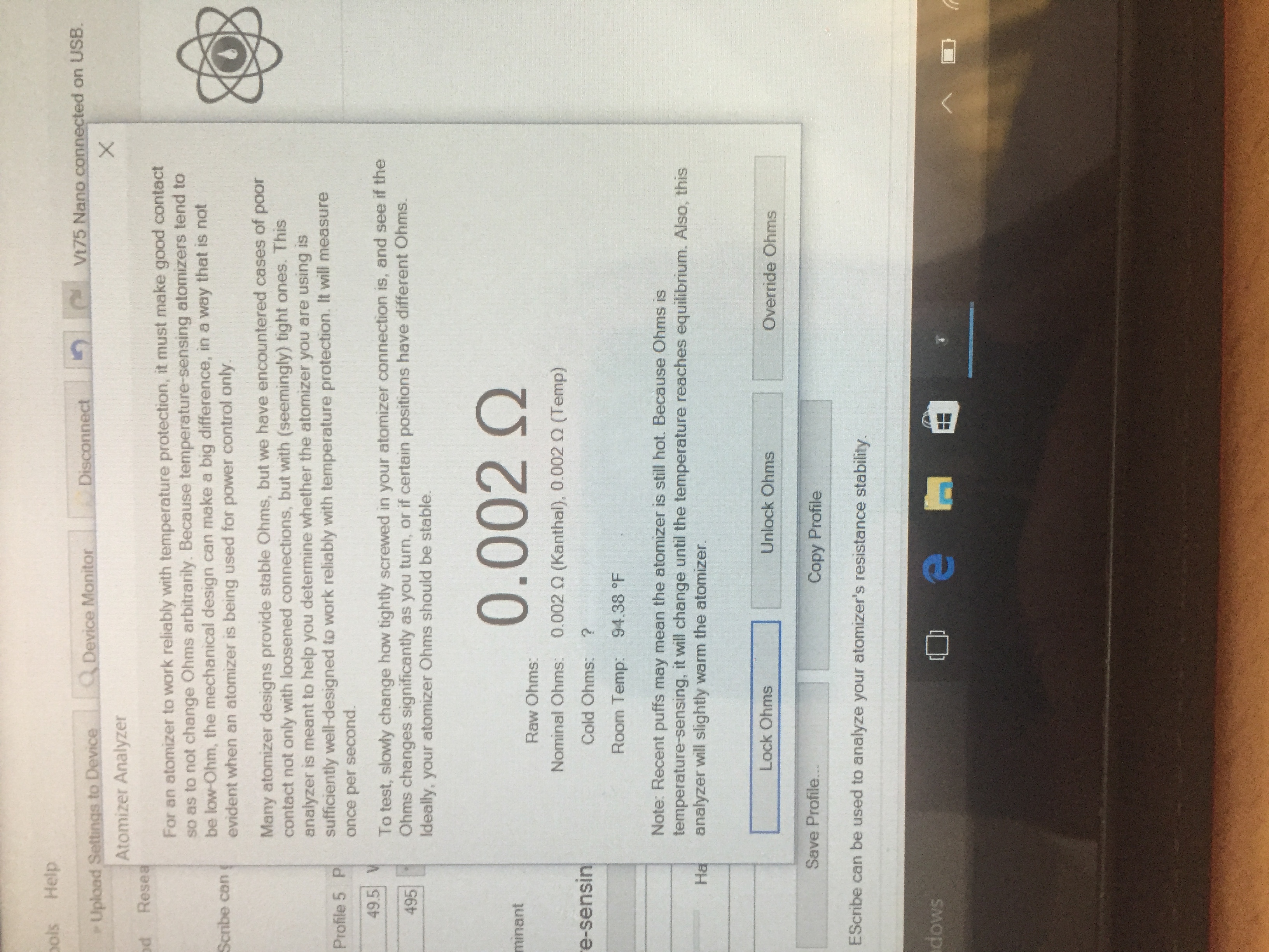

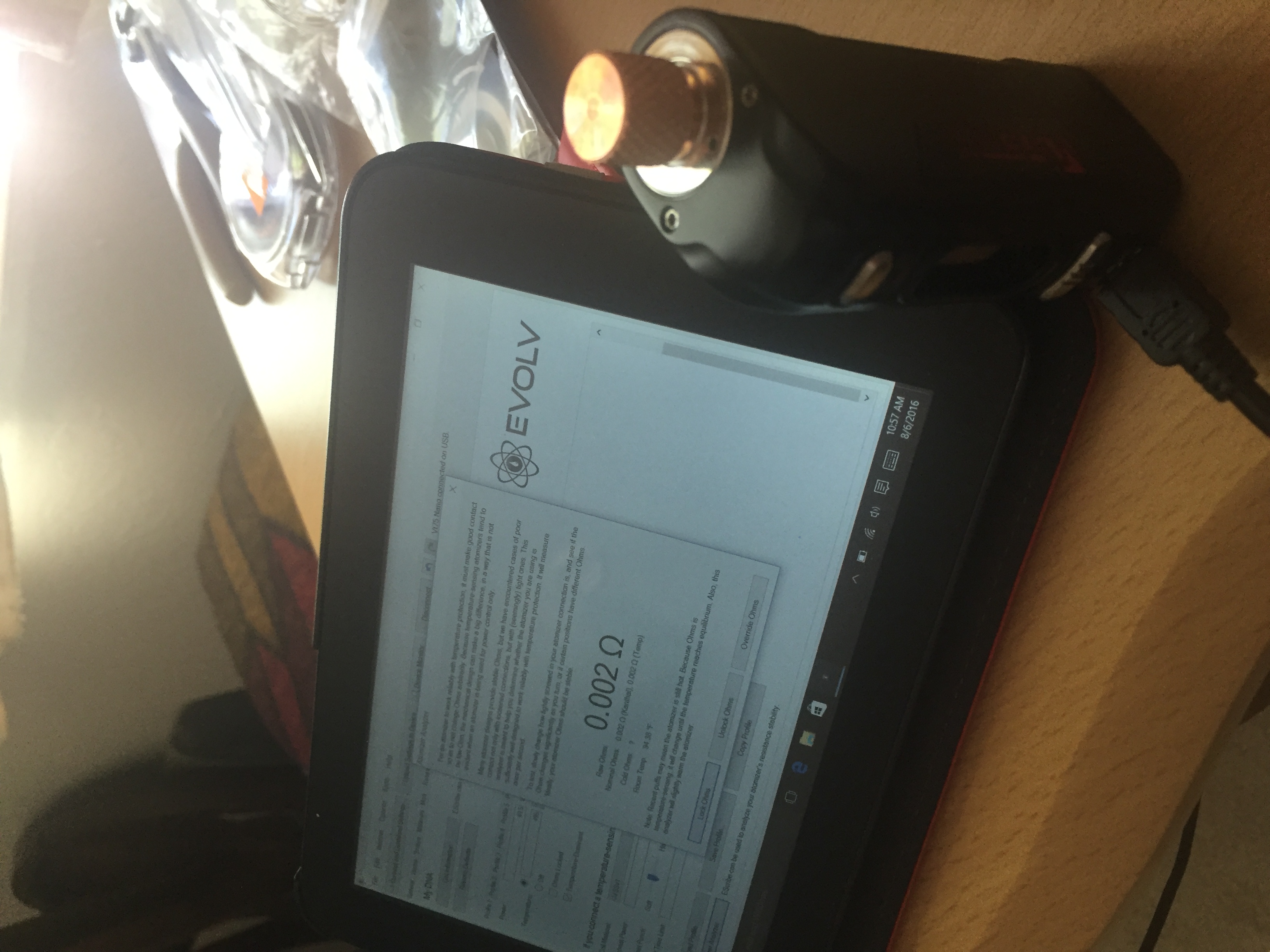

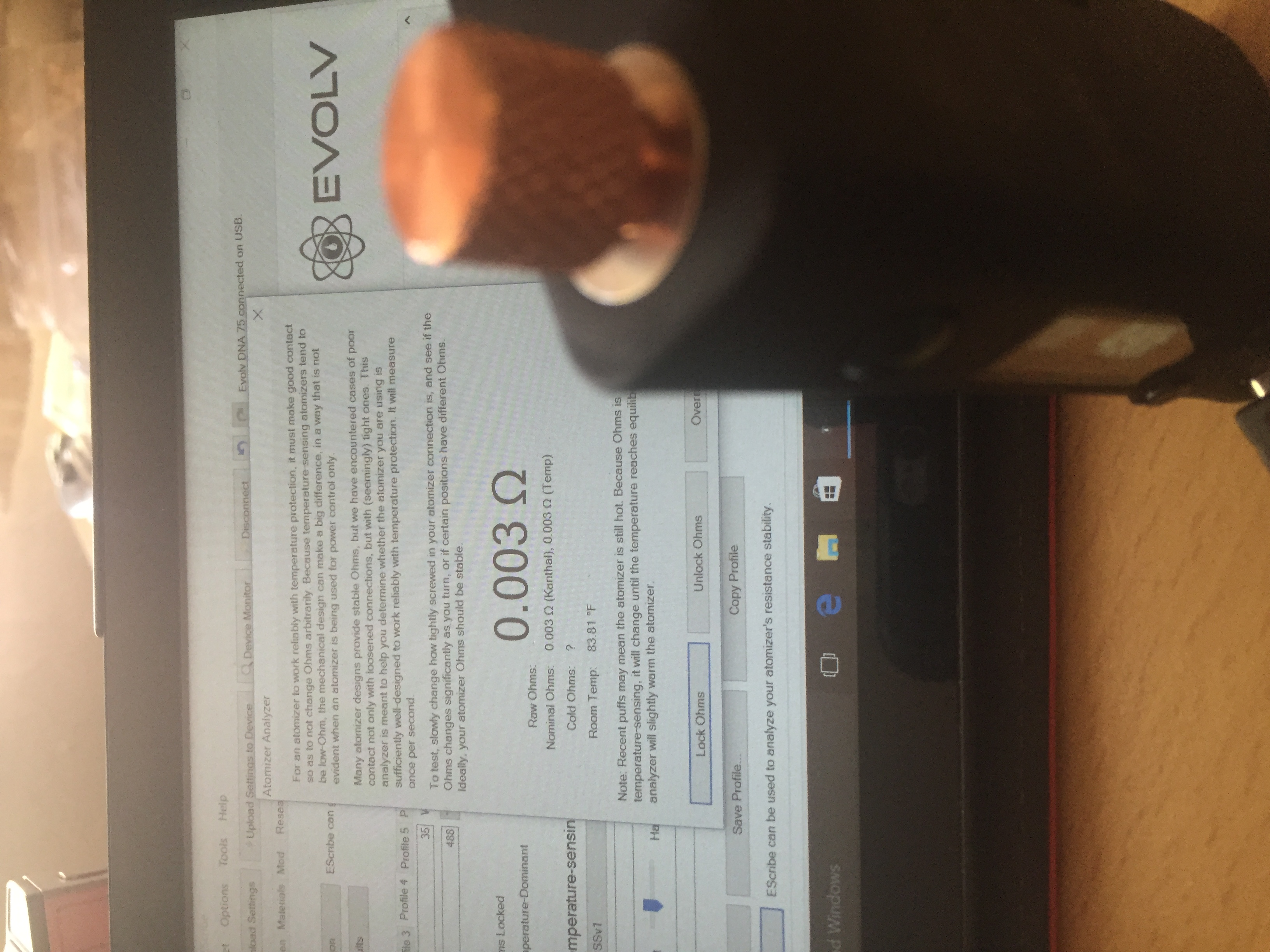

Jentz9517 Posted August 6, 2016 Author Report Posted August 6, 2016 Mod res set to zero clean 510 screwed on tight 0.002 steady as can be

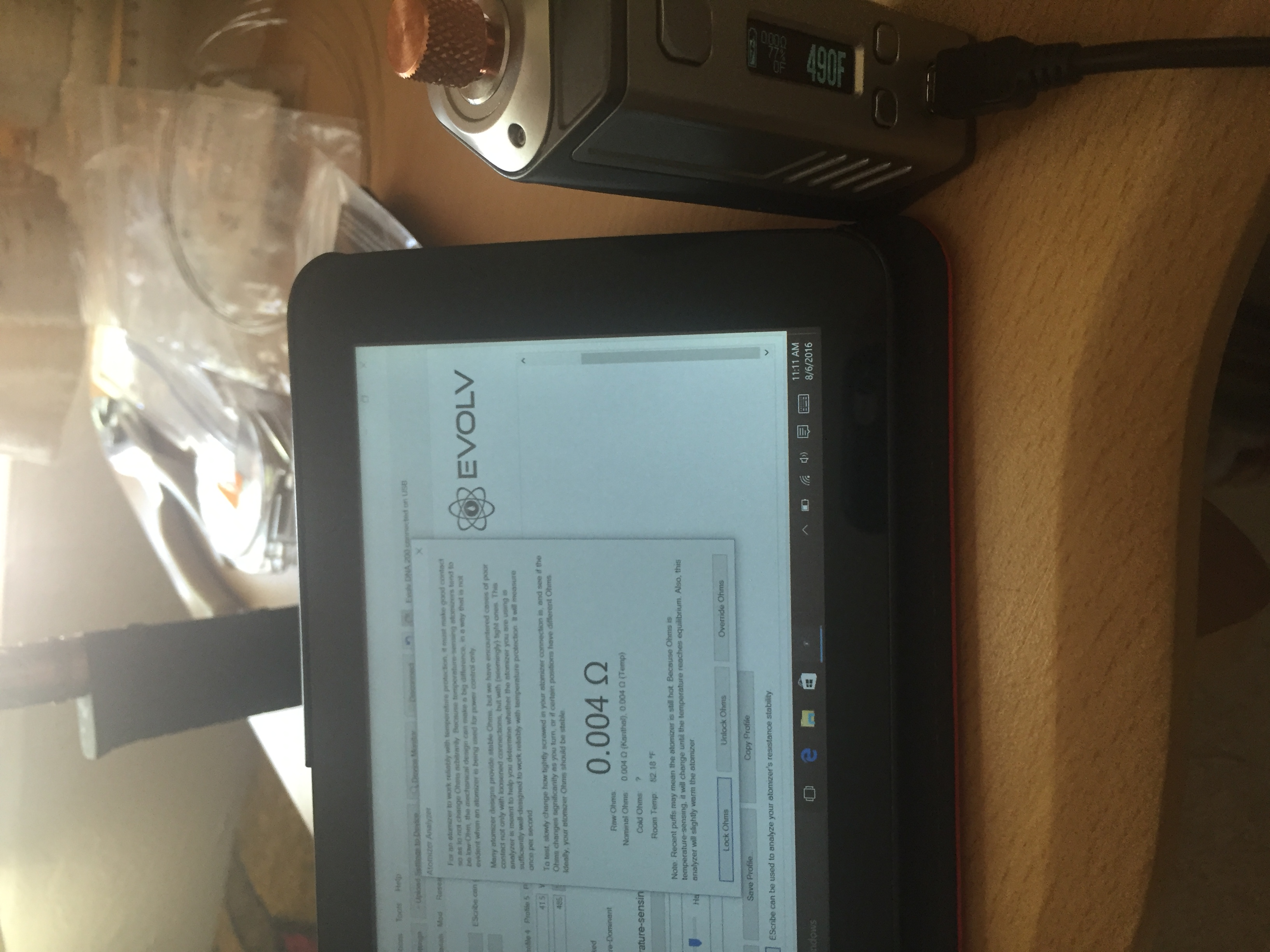

Jentz9517 Posted August 6, 2016 Author Report Posted August 6, 2016 LostVape Triad 0.004 tight set to zero and hard reboot
