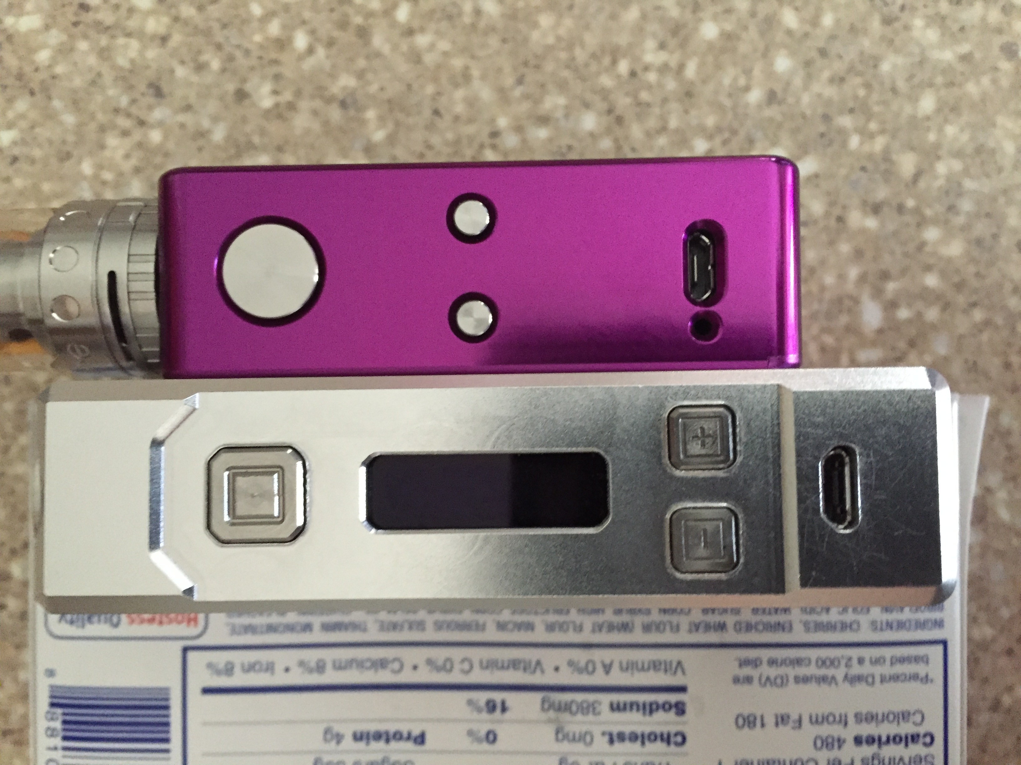

martini3k1 Posted June 25, 2016 Author Report Share Posted June 25, 2016 Hello,I want to upgrade my Esquare (made by Lost Vape and actually running the DNA30) to the DNA75. I already measured the spacing inside the mod's case: The general dimensions of the DNA75 are small enough to fit into the case (it will be tight, but should work). The real bummer is that the usb-connector is positioned a few millimeters to low. So I have to drill the case or reposition the connector.. :/ Is there any chance to reposition the usb-connector on the chip at all?What do you recommend to do?Thanks in advance Martin Link to comment Share on other sites More sharing options...

retird Posted June 26, 2016 Report Share Posted June 26, 2016 After comment about modifying the Esquare I took the time to visit a Esquare and a DNA75 device. The Esquare uses the DNA onboard switches and a separate USB board.The DNA75 device uses the onboard switches and the USB is fixed to the board. Sometimes a picture is worth a thousand words.... Link to comment Share on other sites More sharing options...
