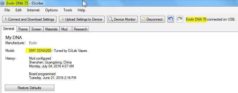

cobalt327 Posted August 31, 2016 Author Report Posted August 31, 2016 When Iâm in escribe and I click on âGet Informationâ, I see my SMY SDNA 75 is being recognized as an SMY SDNA 200. Is this significant- as in does this affect how my mod interfaces w/escribe?
dwcraig1 Posted August 31, 2016 Report Posted August 31, 2016 I never noticed, mine is the same. Just a typo I would think, hope it's the only mistake that they made...LOL
cobalt327 Posted August 31, 2016 Author Report Posted August 31, 2016 Same here! haha But I've had no problems changing settings, etc. so it's very likely just as you said- a typo, or a reused template. Iâm using escribe version 1.0.56 / 2016-05-02.
dwcraig1 Posted August 31, 2016 Report Posted August 31, 2016 SP3 is on all of my 200's and 2016-0502 on my lone 75
VapingBad Posted August 31, 2016 Report Posted August 31, 2016 You name the mod in the connection pop up dialogue boxclick rename
cobalt327 Posted August 31, 2016 Author Report Posted August 31, 2016 @Vaping bad- Does that apply to the DNA75, because I'm not seeing that box...
VapingBad Posted August 31, 2016 Report Posted August 31, 2016 Yes, start EScribe before connecting your mod, once it is open plug your mod in and it should pop up.
cobalt327 Posted August 31, 2016 Author Report Posted August 31, 2016 Okay, got that- thanks. But when I click on âGet Informationâ, the mod is still listed as a 200. No big deal, as long as it interfaces as it should w/escribe- which it seems to- it's just an oddity is all. And I appreciate the help.
VapingBad Posted August 31, 2016 Report Posted August 31, 2016 âGet Informationâ pull the data from Evolv's database from when the production utility was run, it's a different thing and not editable.
