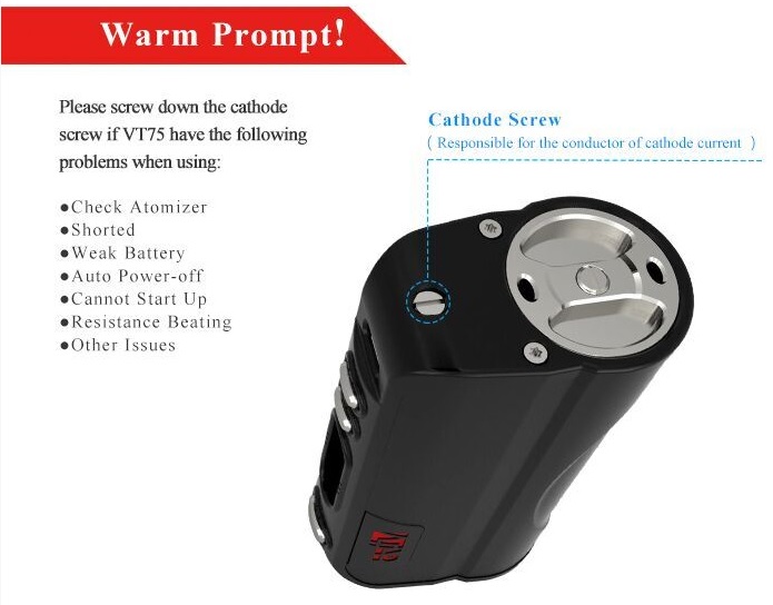

kinkmangc Posted September 8, 2016 Report Posted September 8, 2016 I had similar problems to you with a Hcigar VT75 and a crown tank. Turned out it was just a loose cathode screw. Was easy to fix and haven't had any problems since. Even have a Crown 2 tank with .25ohm coil and works great. Good luck
pharaohman Posted September 8, 2016 Author Report Posted September 8, 2016 Did you run the atomizer analyzer? Also, are you sure you have the correct temperature profile .csv loaded? Sorry if this is too basic of a question, just trying to cover the bases.Yes, I ran the analyzer. This is happening with two separate tanks/coils. Both tanks/coils work fine on my old Kanger MOD (although that MOD doesn't have the temp protection). I'm using the SS316 temperature profile. I had similar problems to you with a Hcigar VT75 and a crown tank. Turned out it was just a loose cathode screw. Was easy to fix and haven't had any problems since. Even have a Crown 2 tank with .25ohm coil and works great. Good luckI wish I could try this. The VT75 Nano doesn't have a cathode screw in the same place. I don't see one someplace else on the MOD either. A quick search doesn't come up with anything for a cathode screw on the Nano.
