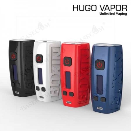

Jameson82 Posted September 11, 2016 Author Report Posted September 11, 2016 Ok i stand corrected its called a boxin by hugo and its a dual 75 mod, but the more i think on it i could probally get a finder 75 for a similar price
