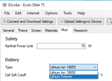

2legsshrt Posted September 24, 2016 Author Report Posted September 24, 2016 Just wondering on the Therion since it has 2 18650's in parallel. If you set it for Lipo, now here is my confusion, would you put Lipo 2cell 22.2 WH or would it be considered single cell 22.2 WH I haven't messed with mine since it seems to be working ok but if I did go into the manufacturers setting and set it for LiPo would it be considered 1 cell or 2. And when you change that are you supposed to put the total WH's or the SH's for 1 cell. Kind of confusing to me.
retird Posted September 24, 2016 Report Posted September 24, 2016 Don't think you have a choice for 2 cells with the DNA75....
VapingBad Posted September 24, 2016 Report Posted September 24, 2016 That's right 2 cells in parallel just appear as one cell the board, same voltage.
2legsshrt Posted September 24, 2016 Author Report Posted September 24, 2016 Got it also on my VT133 I changed it to read LiPo 2 cells and 22.2 WH is that correct or are you supposed to show the WH for 1 cell and it takes care of the rest. I figured it wanted the total WH for both cells or in the case of a 3 cell LiPo the total of all three cells not just for one but I could be wrong on this. So what's the answer.
2legsshrt Posted September 24, 2016 Author Report Posted September 24, 2016 Nevermind I answered my own question by going into the manufacturers setting and using the onboard calculator. That showed me that it uses the total of all cells for the WH's
