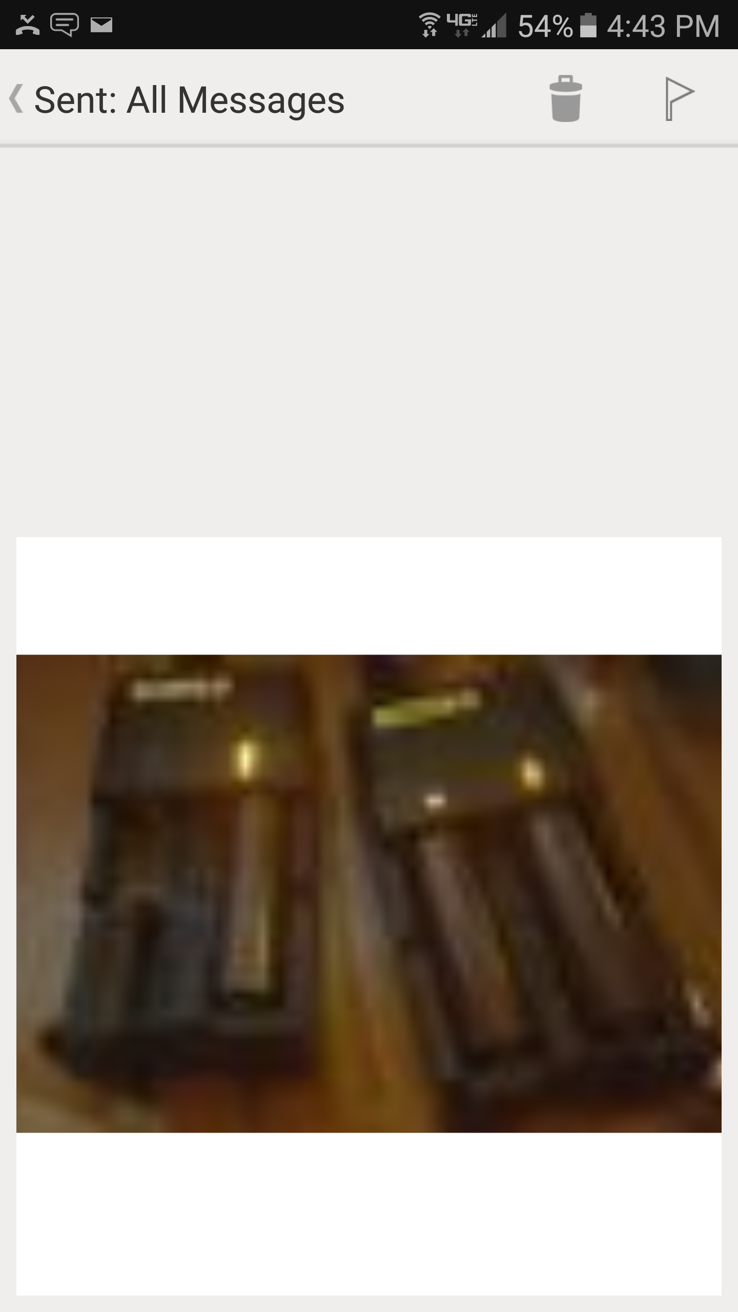

It's the charger port. Stupid ass that I am I jumped to blaming the manufacturer. I never had this happen to the charger, and they were new batteries so it seemed like the mod could be the only possibility. All the batteries were at 3.8v, and I cycled the batteries through that port until it reproduced the issue of the battery reading full when it wasnt. I'll have to check my battery voltage every cycle now instead of every 3-4 days. It was confusing because the mod worked, if one sled lost connection I would think it would have been DOA. So good deal thank you for the kick in the ass. Currently puffing on a Mason 30mm with single 20ga/8 wraps at .35 ohms and some 3mg pancake man!
