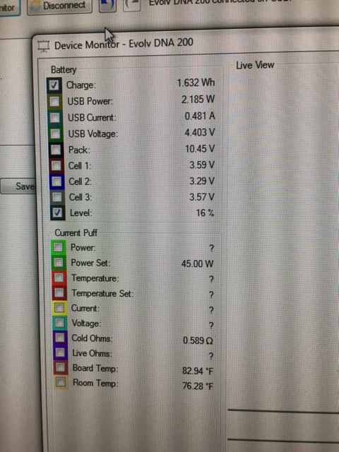

So I went to have a vape today with 19% battery left and it wouldn't fire at all. No flashing battery bar, no errors. I checked in device monitor and saw the cells were 3.57, 3.59 and 3.29. I have the soft cell cut set at 3.2. I'm watching to see what happens while it's charging and it's slowly equalizing out after about 20 minutes of charging. Bum lipo pack? image1.jpg

At a 3.2V soft cutoff under load, it's not surprising you don't get significant vapor if the lowest cell is at 3.29V when not under load.
Most of the capacity is at higher voltages, so it would appear to even out voltage-wise after a bit of charging despite having a large difference in charge level between the cells. (When they are very low cells tend to crater on voltage, so if the other batteries are at 5% and that one is at 0%, it'd appear a lot lower, whereas at 20% and 15% they'd appear similar.)
I'd let it charge up to 4.2V and give it time to rebalance. It's not necessarily anything wrong with the pack. Balanced, next time, you should get closer to that 19% it thinks you have left.
