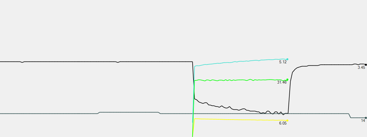

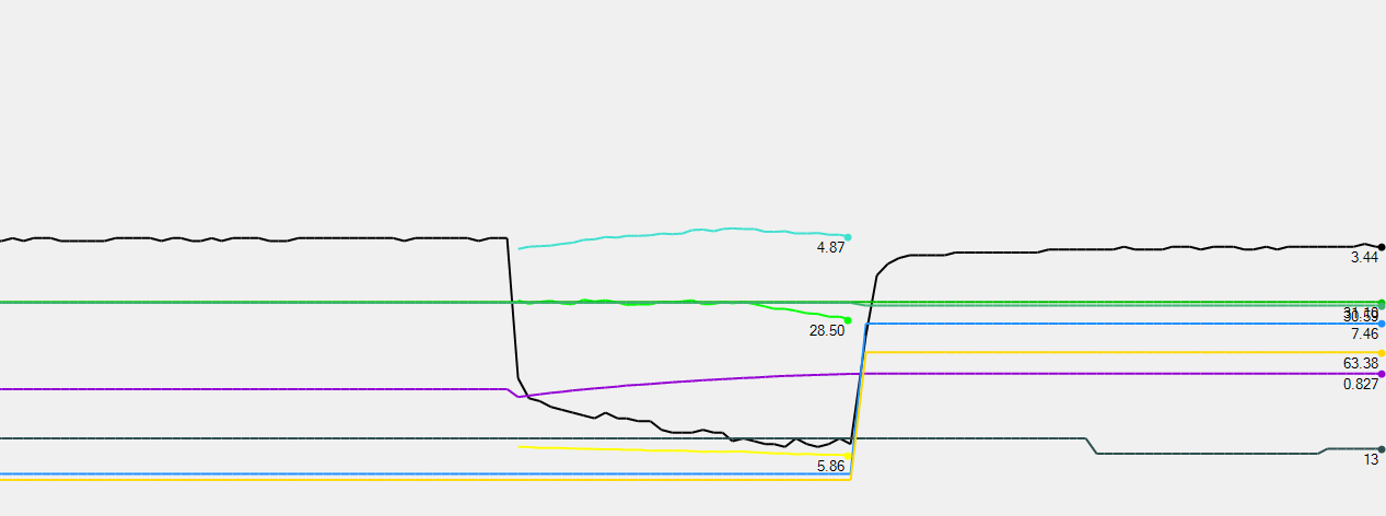

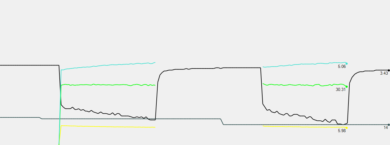

retird Posted October 13, 2016 Report Posted October 13, 2016 Can you use Device Monitor and fire the device for 5 seconds and take a screenshot of the Device Monitor data and post it here?
Zodiac Posted October 13, 2016 Author Report Posted October 13, 2016 Thanks for your reply !I made some, screenshots while firing, I hope that they are for use.
VapingBad Posted October 13, 2016 Report Posted October 13, 2016 That looks like almost no delay, are you vaping in temp mode as it looks like you have live ohms checked in the 1st one with the cold ohms too high or locked res and no preheat.
Zodiac Posted October 13, 2016 Author Report Posted October 13, 2016 Ok, could be almost no delay, for what I noticed it,s very short maybe 1 sec or just bit a shorter, as my mech fires instantly, the VT75 has a bit of a delay.I made the screenshots, after use of the battery-analyser, cause I just received 2 IJOY 26650 batts, I was using ss316L/24 gauge reading 0.7ohm by 40 watts for the, battery-analyser.So I test fired, like you asked, as far as I know this was in power-mode, no preheat set and did not use temp-mode or locked the res.
VapingBad Posted October 13, 2016 Report Posted October 13, 2016 That looks like a lot less than a second delay in power delivery, I think you mean the the coil take a second to get up to temp, which would just be the coil not the mod. Cold res doesn't matter if temp limiting is disabled. If I were you I would use temp limiting and preheat, it works very well with ss, I even have triple twisted dual coil SS316L builds.Also with less advanced many mods sold as VW only measure the res at the beginning of the puff and set the voltage, so with ss the power goes down as the coil heats just like a mech, DNAs give a flat power output even if the resistance. So the vape will be different between boards with ss and maybe that is why it seem slow to you.

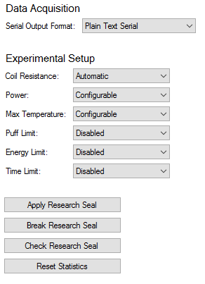

VapingBad Posted October 15, 2016 Report Posted October 15, 2016 I have never seen that, but would check the research tab in escribe, specifically that the puff, energy and time limits are set to disabled. Here is what the defaults look like.
Zodiac Posted October 16, 2016 Author Report Posted October 16, 2016 Checked the research tab, the puff, energy and time limits where set to disabled, So I set it back to manufactures settings, after that it functioned...the problem occurred, probably due use of the CSV file for Preheat in Kanthal, did download it yesterday used it last night, with the same fused-clapton build it worked very fine, but tonight it went a bit strange, suddenly temp-protected showed up, so I don,t know of that has something to do with it.
VapingBad Posted October 16, 2016 Report Posted October 16, 2016 As far as I understand it you should only get that message in relation to stuff set on research tab.
