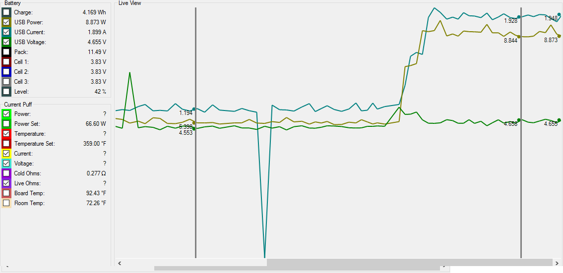

VapingBad Posted November 2, 2016 Report Posted November 2, 2016 I can get 1.97 A from USB3 ports on my laptop with a good cable, I prefer measuring in watts and get 9 W from USB3 with my best cable, 9.6 W is the best I have got from a supply, 10 W is the theoretical max (2 A @ 5 V). A average cable like the one that came with my Samsung Mini S3 drops that drastically, 5.5 W from USB3.This is the Samsung Mini S3 cable (800 mm long) on the first half, I guess a fairly average USB cable and a cheap flat short (200 mm) USB cable on the right which charges at a much higher rate.

ravin187 Posted November 2, 2016 Author Report Posted November 2, 2016 dwcraig1 said:I'm not sure what the problem is but the device does monitor board temperature and if too warm will cut off the charging. Sorry but I don't know what the numbers are. Check in Device Monitor what the temps are during charging and post it.Oh, pretty hard to do with a wall charger...duhOn 2nd thought you can set the screen to show board tempmy crappy computer would only charge at .5 amps but the board temp was 84 degrees. I've tried charging it with the back off and the battery pack hanging out to get more air flow around the board and it's still starting/stopping. it doesn't feel hot... to my extremely uncalibrated finger.put the temp on the screen for charging. and it's been going a while and is at 93.4 and working fine... I have never gotten a "too hot" error.
