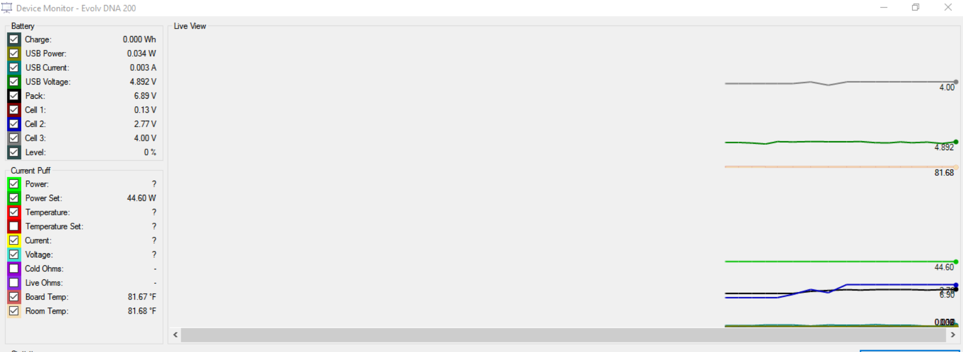

fibercarbon Posted December 1, 2016 Author Report Posted December 1, 2016 I literally received like 5 DNA mods in the past 2 weeks and 3 of them were bad and wont EVEN CHARGE or power on at all and one kept saying warrantyThe bad unit i plugged upto escribe and they were producing bad battery indicators. 1. LAVABOX DNA200 Received Straight from manufacture Escribe Results Above Received item 12/1/20162. SMY SDNA200 Unit would not even power on and had similar results with Escribe as above.3. HCicar VT200 Would not turn on or charge and had similiar CELL results as above. I have a ton of Sealed lavaboxes in my room and now I am like Afraid of all units with batteries in them might be bad.. I never had a single issue until I switched over to DNA Units with batteries in them then I Started getting mostly Defective Units.. I tired all the USB Recharching thing trick like 10 times and it did not help any of them. Anyhow I was looking herehttp://www.volcanoecigs.com/blog/evolv-escribe-use-with-the-lavabox-dna-200.htmlWhat is the latest EScribe Settings (.ecig) FILE out there that is optimized for the default 900mah Battery? Anyone link me to a download for the best one to use I want to make sure I am getting the most out of my units and the latest one I found was from may 2015 so I am looking for the latest and GREATEST EScribe Settings (.ecig) FILE download for the LAVABOX DNA200 with the factory default 900 battery any it. Anyone can help me out You are the best!!! God Bless and I really hope someone can find the file for me I dont want to brick my units i have 4 open right now and I want the most optimized settings file for them and also the CSV for the battery download file would be great.

Wayneo Posted December 1, 2016 Report Posted December 1, 2016 For starters, your post title could have been worded much better. You bought mods with DEAD batteries. That is a manufacturer issue. I bet they all work fine if you vape while plugged into a USB cable? The data within the .ecig file probably has not changed at all, plus YOU have the ability to create that information the best for each of your mods. The 'big/important' piece is the mod resistance (for the best TC), and the manufacturer probably checked a few or one of their mods and programmed that same value for all of them. As far as your battery setting, the absolute best one is one that you would run on your own battery.It seems like you're getting a lot of old stock from smaller vendors where they don't move much product, so they just sit there discharging. You should be hitting up the vendors for replacements or batteries at least, not bashing Evolv.
